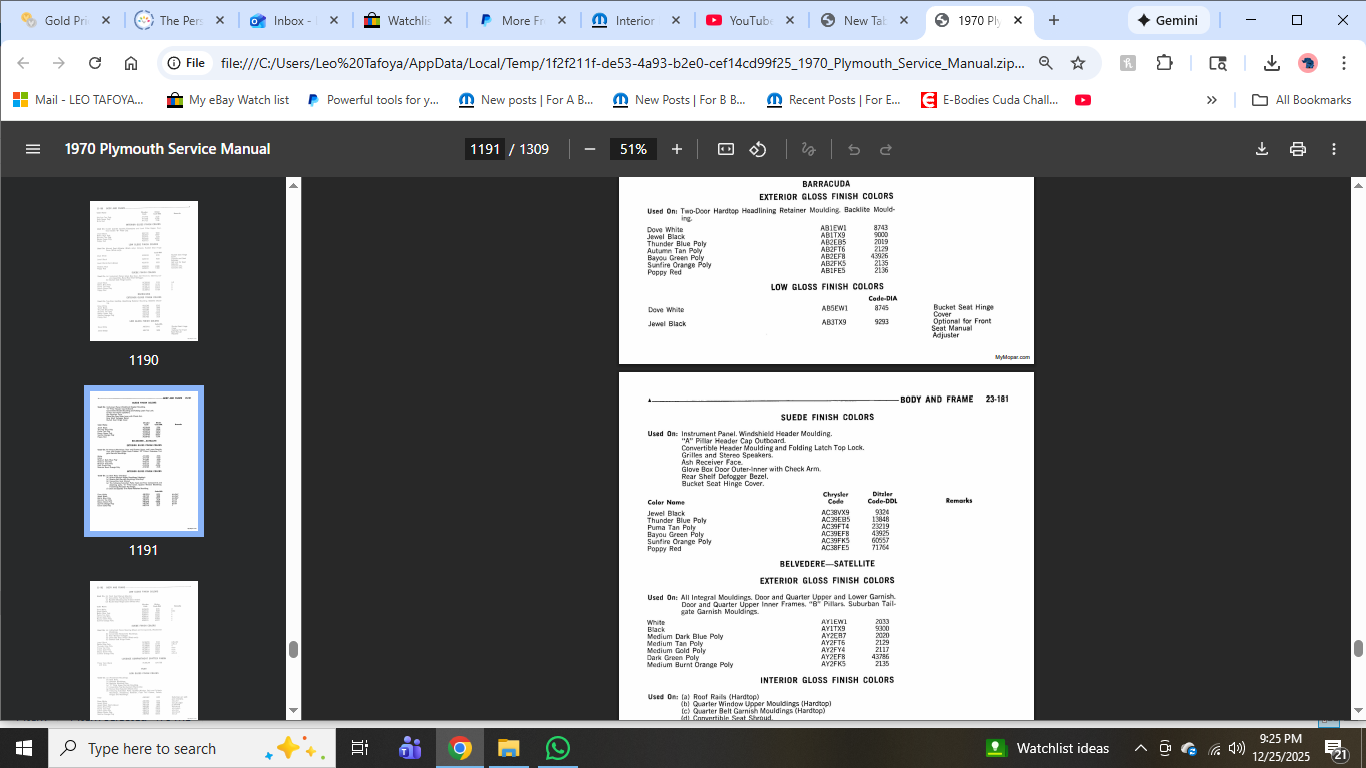

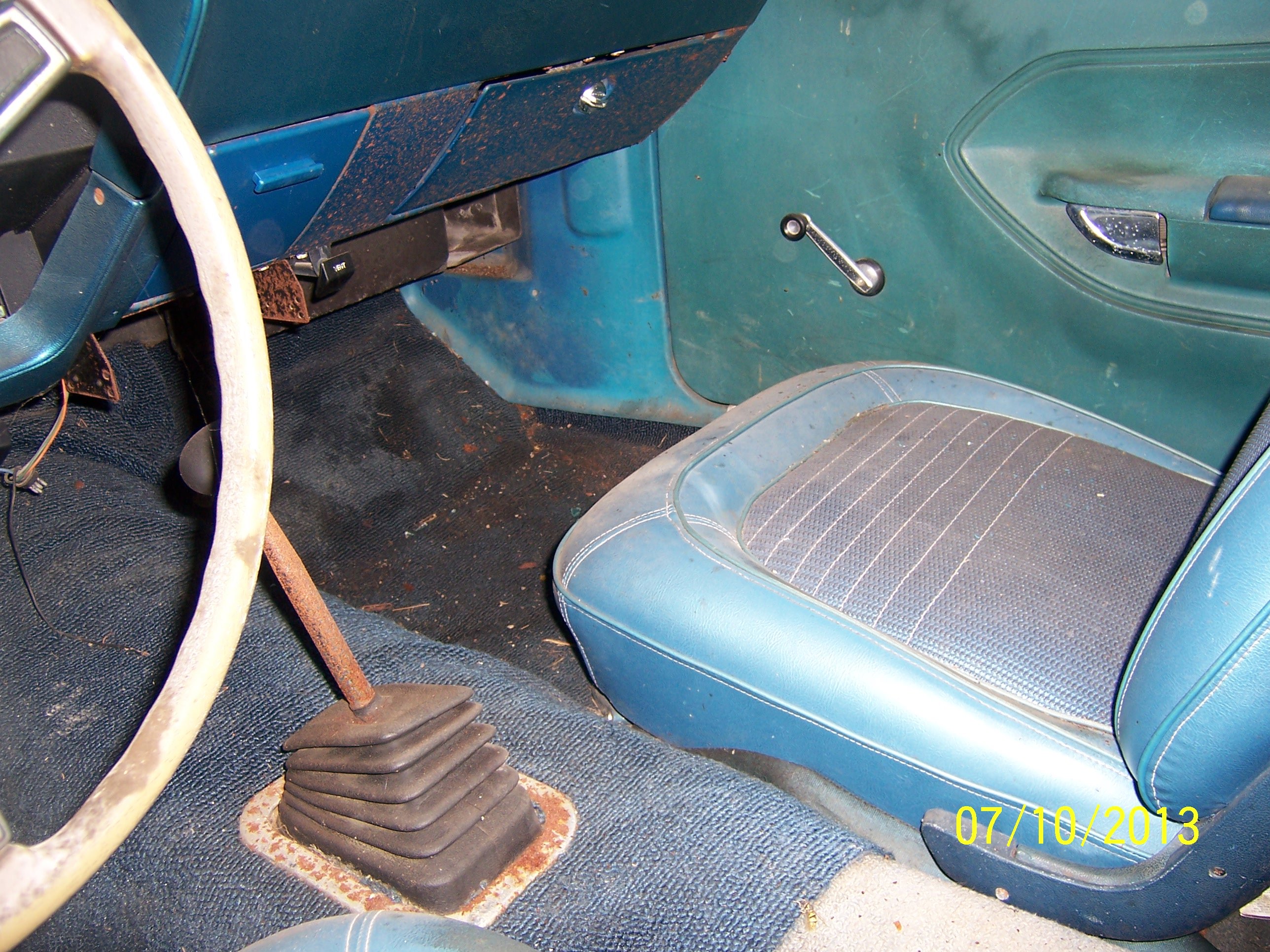

I am restoring a 1970 Cuda 340 B5 blue on blue on blue. I believe most of the interior paint should be Eb5 Brite Blue but isn't the dash, ash tray and glove box lid Eb7 Jamaica Blue AKA Med Blue Poly?
There is no interior paint on an E-Body! 😁

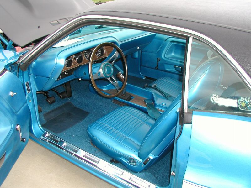

But your dashpad, carpet, steering column and headliner should be blue with your seat covers. The last two digits of your 4 digit trim code will show what they should be.
My 70 Cuda 383 is EB7 Blue ( Jamaica Blue )exterior with EB5 Blue (Bright Blue) interior. As far as I know, everything inside the car is EB5. States it all clearly on the fender tag and the build sheet.
