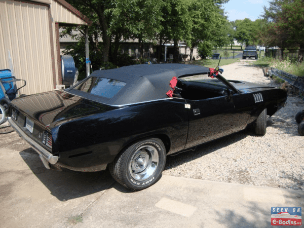

You know, if you were doing something like swapping a shell onto an LX chassis, I think it would be easier to pull off. There is a person who converts AMD coupe quarters into convertible pieces. And there is an outfit that builds LX convertibles.

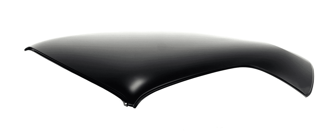

AMD sells a good quality roof skin for a Challenger
Roof Skins | AMD 600-2570
Classic has the AMD roof skin in stock
MM1145B - 1970-74 Dodge Challenger Roof Panel Skin

Sorry guys, but why when there are convertibles for sale out there. I have a 70 and a 71 Challenger Convertible. I would not cut up a hardtop to make a convertible, the cost probably would be more than buying a convertible. I just don't think you could engineer it right.

This definitely isn't the first one ever to be made into a pseudo convertible. But it is not going to be all that easy to do and make work well.
