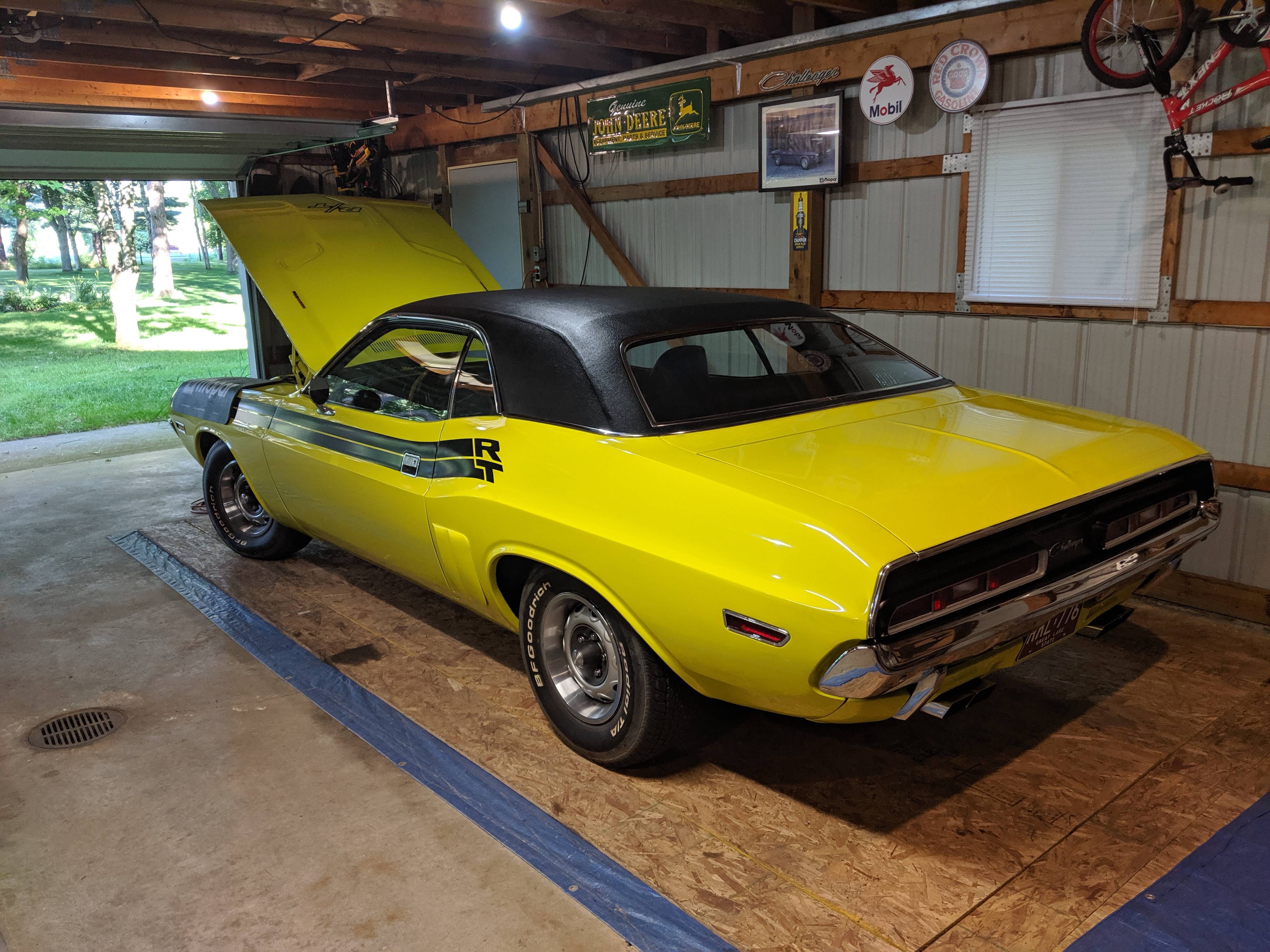

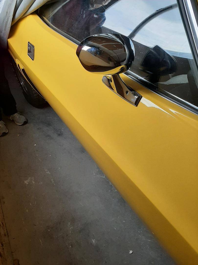

My GY3. The lighting is not great, but I agree it's not greenish.
I love your color. and i wish i could have mine exactly like that. its just sometimes Curious comes out green? have you not seen the green before

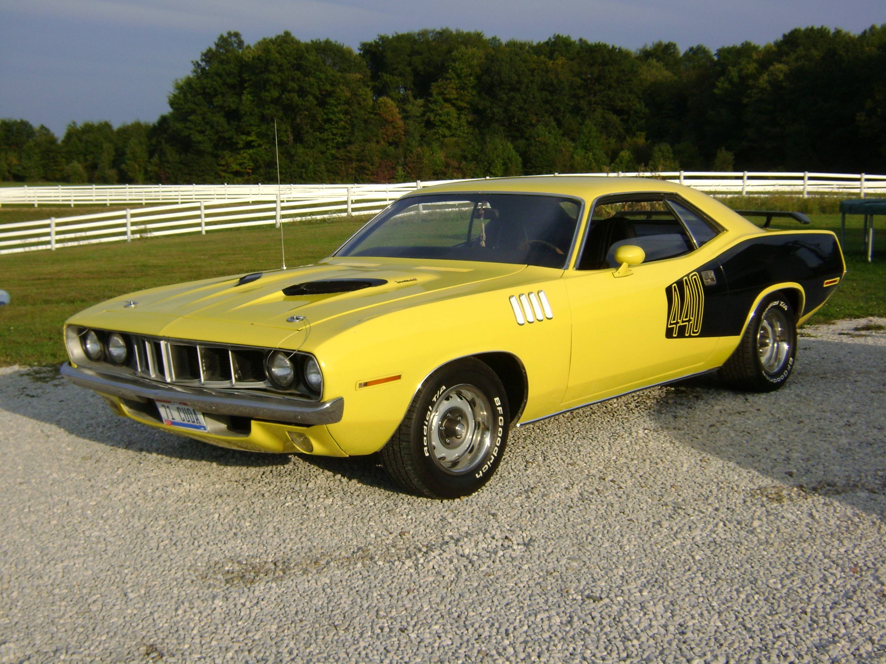

When Citron Yella is mixed right and sprayed out on a car it is a very bright clean colour. I really like the colour.
There is definitely a reason it was in the High Impact range of factory colours.
I believe it is one of the rarest High Impact colours since it was only available in 1971.
A Curious Yellow Cuda is not going to get lost in the crowd.
Top Banana is a pretty accurate description of what that particular colour sprays out like from the cars I have seen.
Most automotive paints are a mix of tints so they need to mix it right to get the correct shade when sprayed out.
GY3 does have a hint of green or black in it but it is mostly a bright yellow - this is my bumbling description.
Black billboards or strips really set it off IMO.

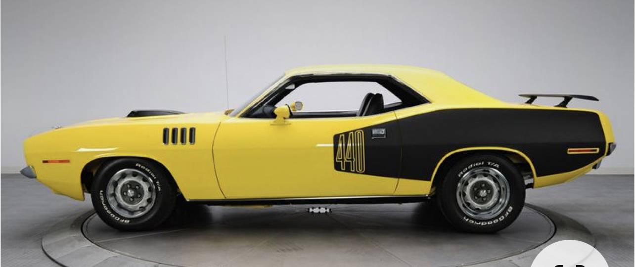

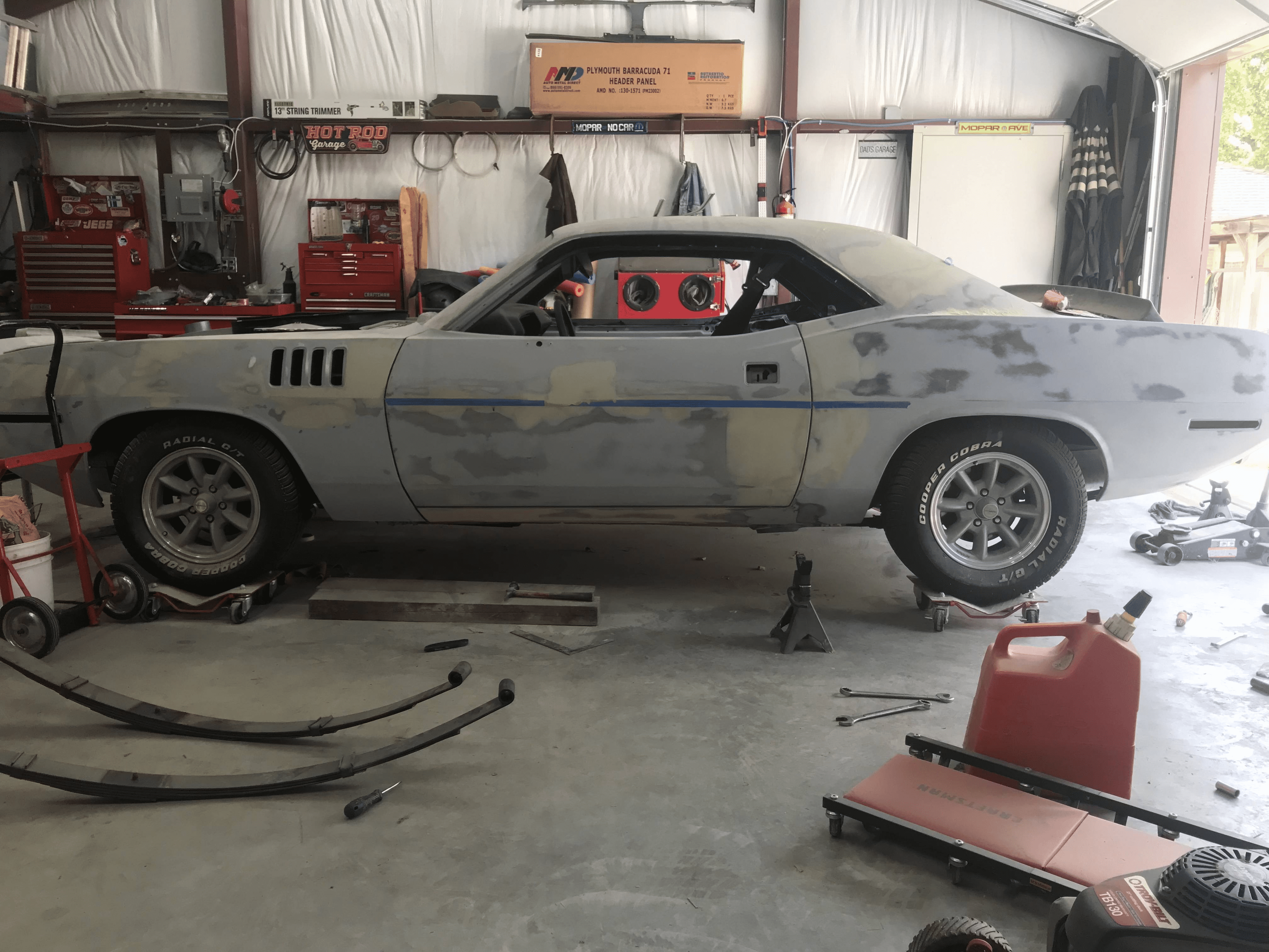

No, i am leaving it all yellow, going with billboard. i got the louvers from Dales Cuda Shop.
Just asking since all Cudas with the A67 factory louvers required a black vinyl top. Challengers did not require the vinyl top to get louvers. The louvers fit the Challenger rear window shape much better than the Cuda so the vinyl top helps with "blending" in the shape to the Cuda roof.
It's your call if you like the louvers without the vinyl top. Something to think about.

got ya, thanks for that. i do really like louvers without vinyl. Do you think maybe a soft weather stripping material might be in order. something to kind of help the two surfaces come together?

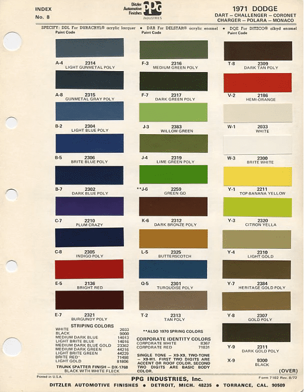

Steve 340, I can tell you know it very well. I am also a fan of it in "some lights" But i just really dislike lime green and when i see the green it turns me off. Do you have any advise for me trying to get paint code for curious yellow without the green. basically just a bright yellow that closely resembles the mopar family. i am not a purist and have to have it exactly original. Like some others had mentioned Viper Yellow? is that pretty close?
The louvers come with a one-piece rubber strip which isolates the surfaces that touch the body. This strip goes from one "corner tip" to the other.

The best idea for finding a paint colour is to look at a newer car that has a colour you like and get the paint code.
This is the safest way as you see what the colour is like sprayed out on panels/different lights etc.
Good luck and post up what you decide on. Steve

Did you settle on a color?
Y-1 got the Y right lol
This bring something to mind. A few weeks or months ago. someone was asking about a yellow on an other members Cuda I think. I think it was mentioned it was a Viper color. Someone I think wanted a yellow like the Top Banana but the one they were looking at was a brighter yellow. When closing the page,Just happened to see the Colt 021 bright yellow out of the corner of my eye. I wonder if that was it? I'll have to go back and look. ALL this is just thinking out loud. Thanks LOL!
This bring something to mind. A few weeks or months ago. someone was asking about a yellow on an other members cuda I think. I think it was mentioned it was a Viper color. Someone I think wanted a yellow like the Top Banana but the on they were looking at was a brighter yellow. Whn closeing the page,Just happened to see the Colt 021 bright yellow out of the corner of my eye. I wonder if that was it? I'll have to go back and look. ALL this is just thinking out loud. Thanks LOL!
Yea, its not even a car color, just one i picked out of the book
i did 4 samles. the one liked in the book, original Lemon Twist, Viper, corvette
you can't even tell in pictures, but in real life the one i picked out of the book is very Clean. no green. resembles original yellow (to the untrained eye)
