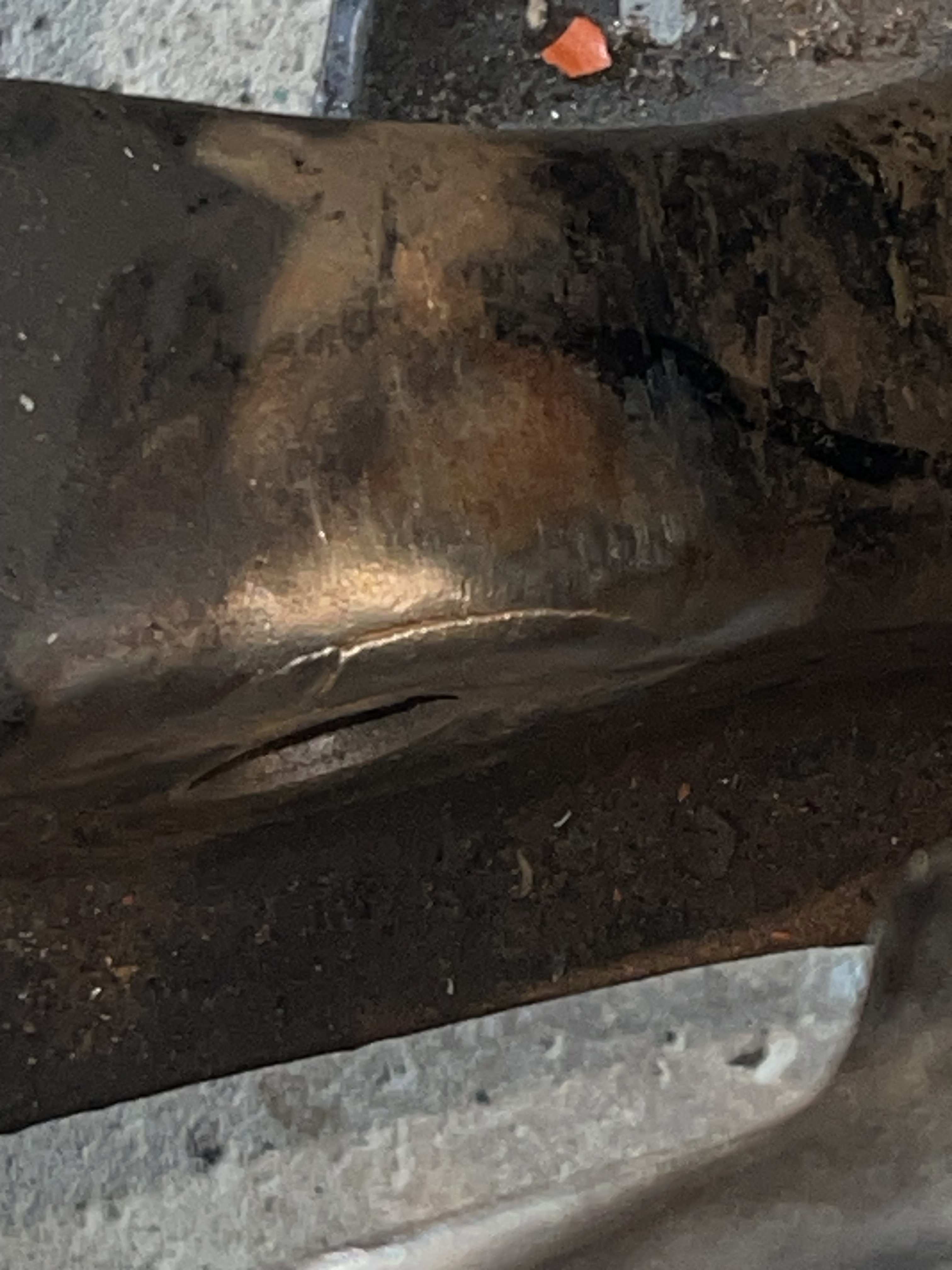

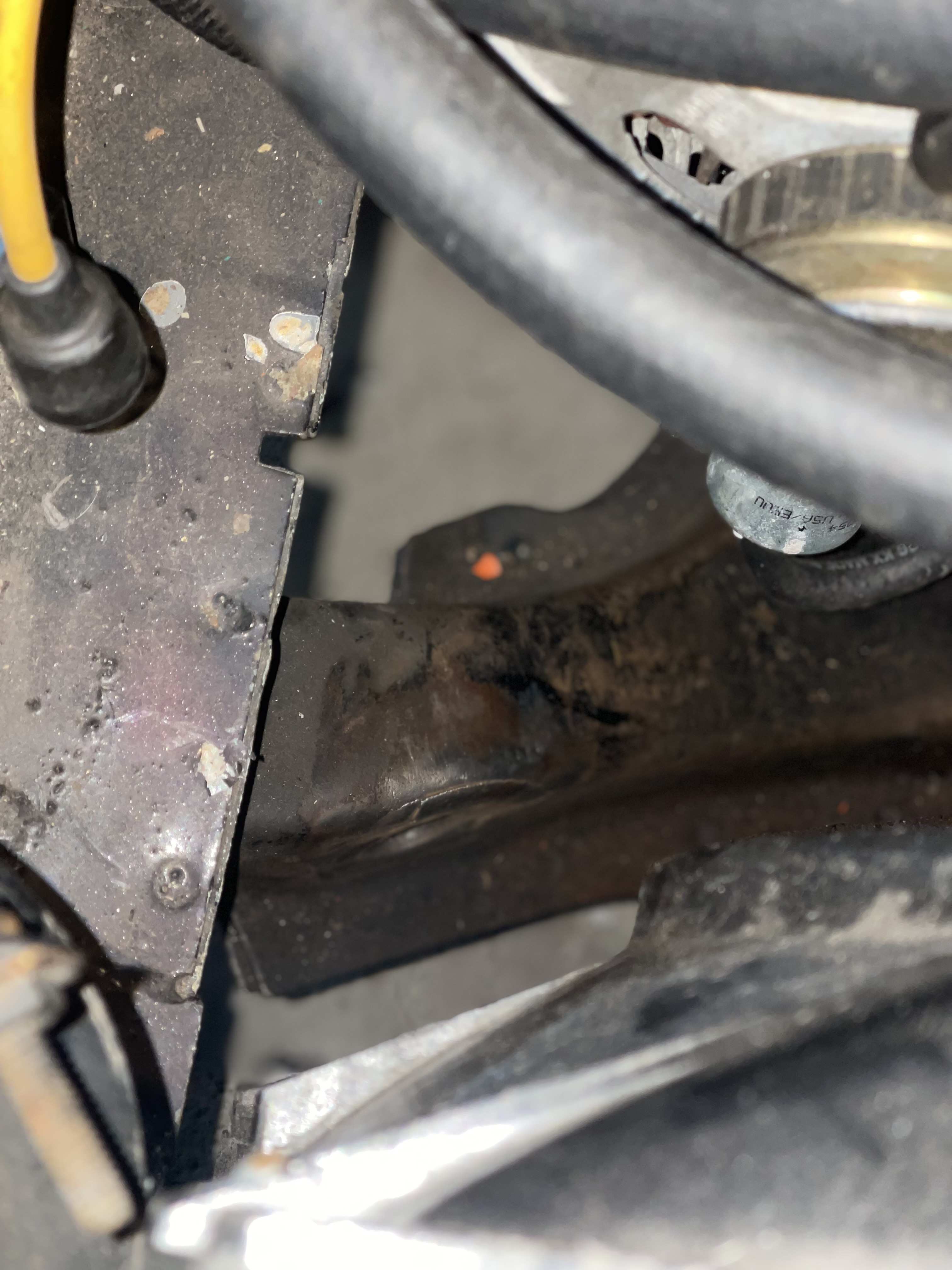

I was starting to install my front suspension parts when I made two discoveries.

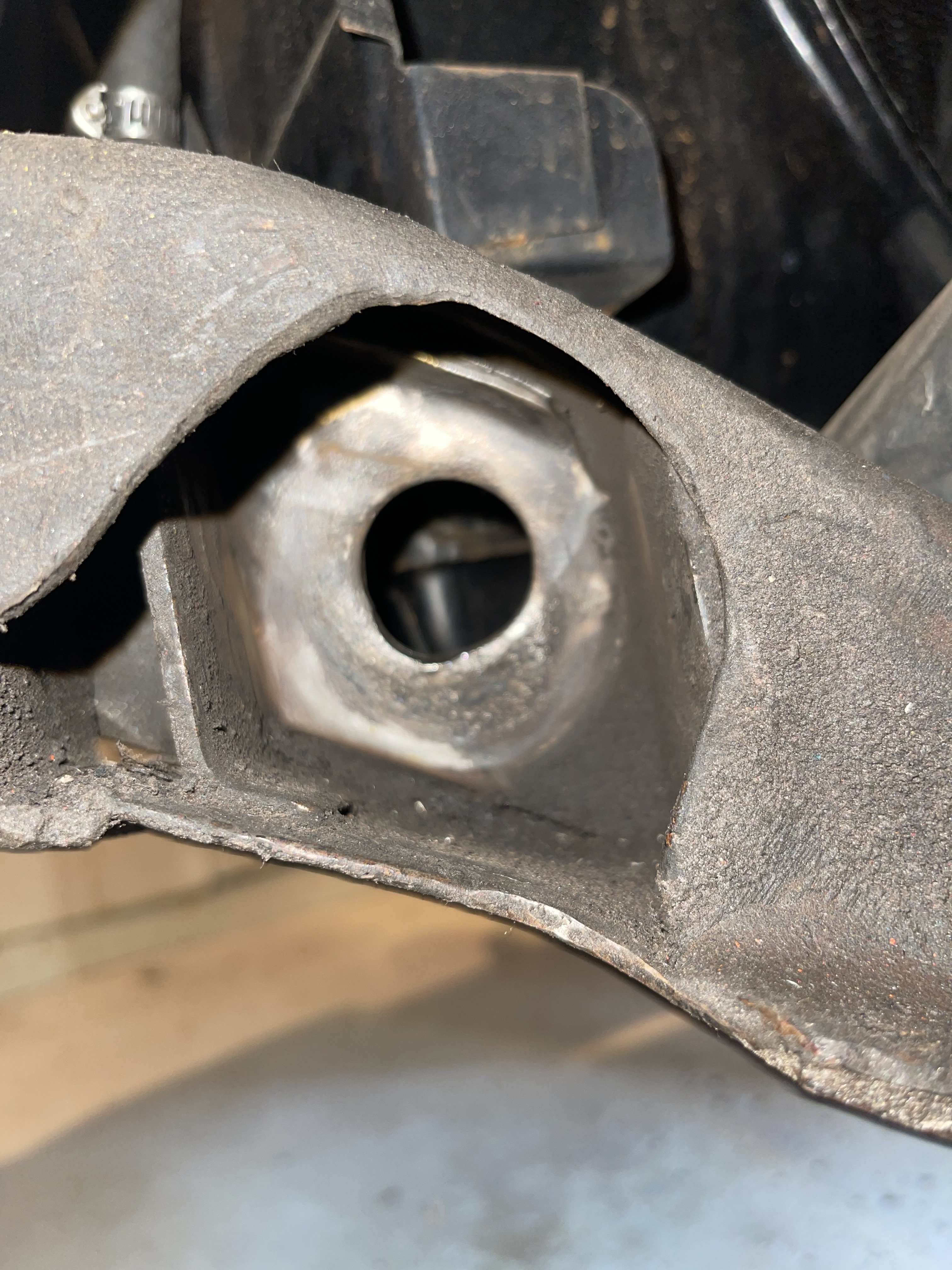

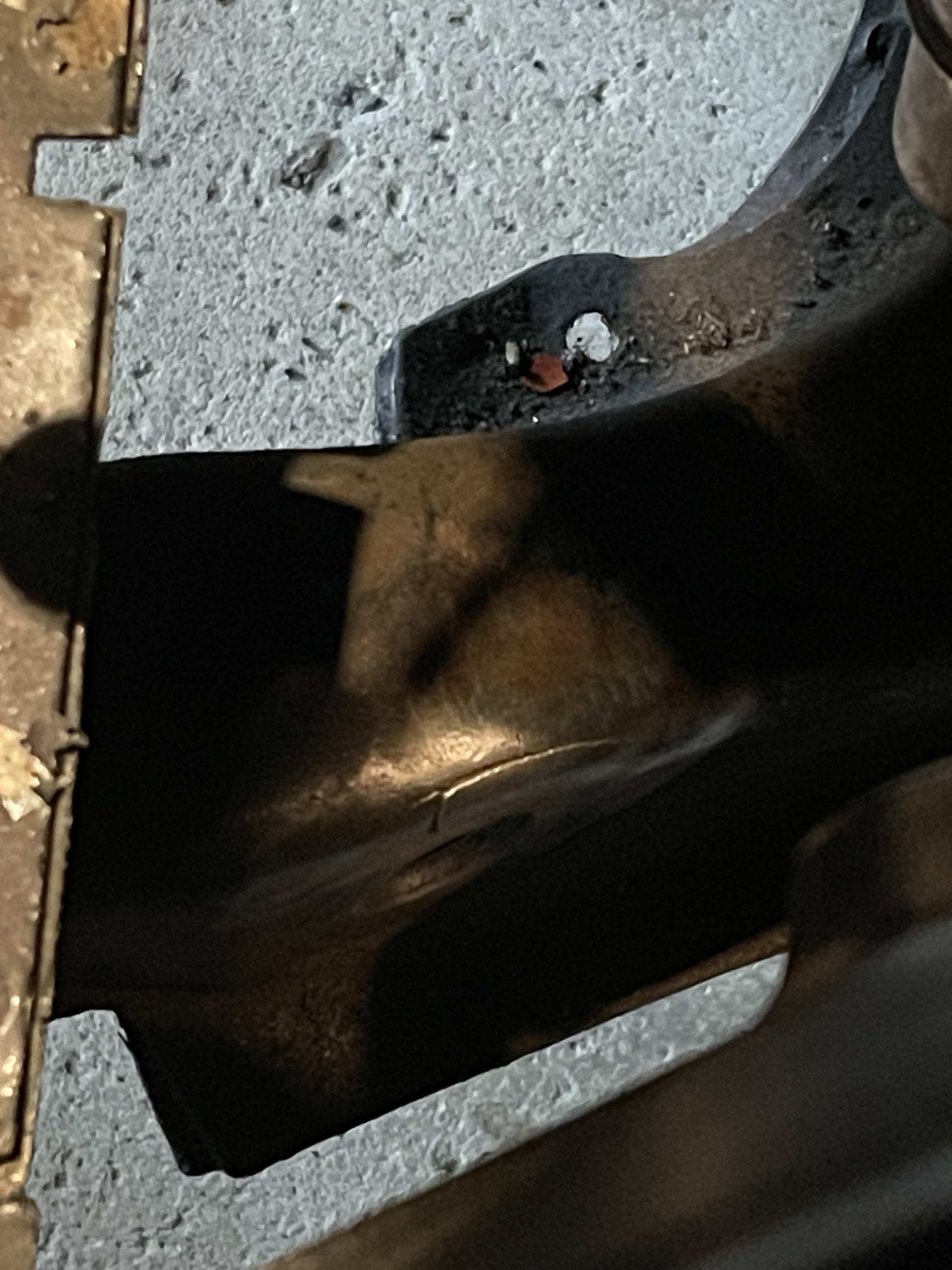

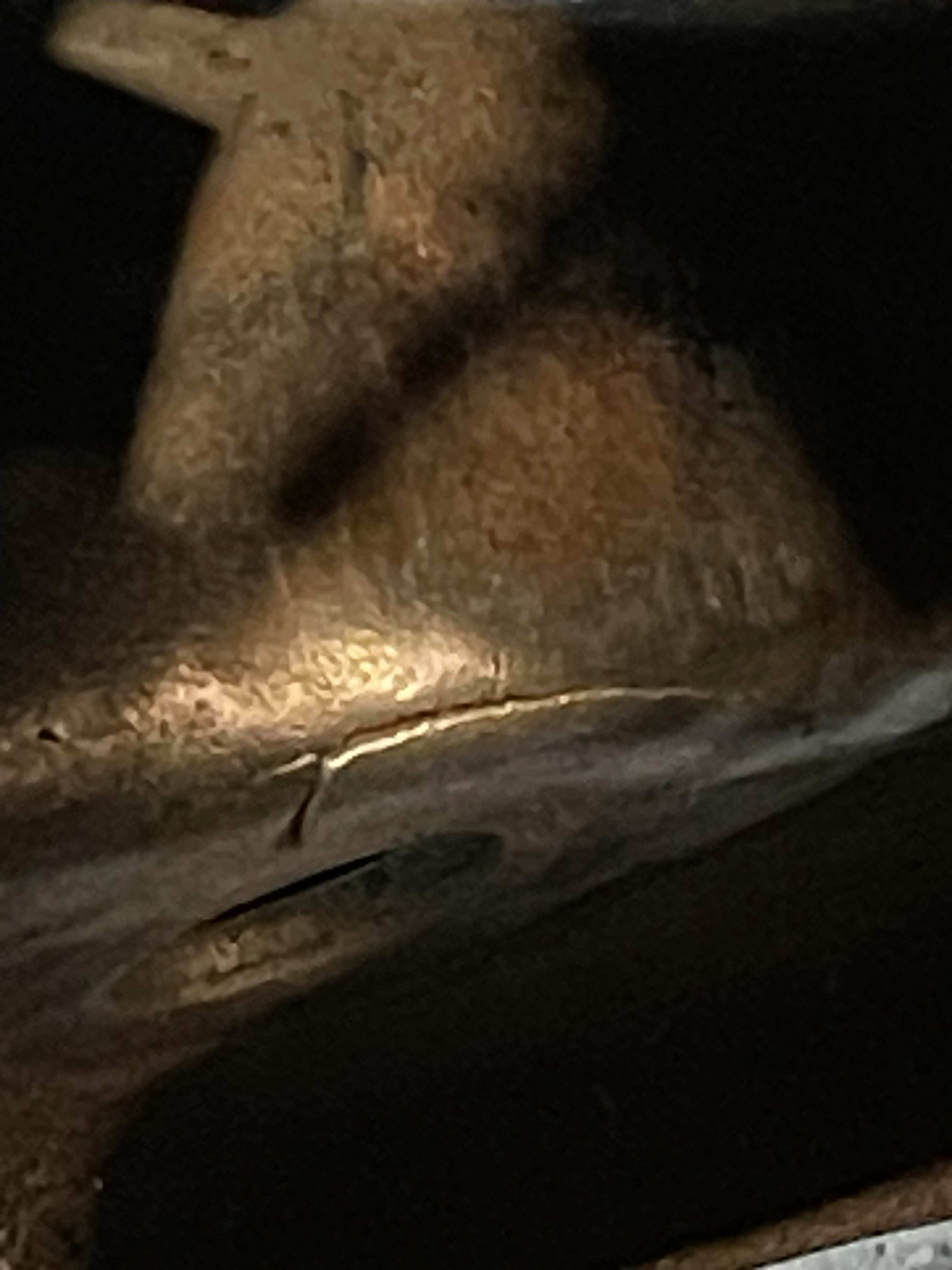

An elongated strut rod hole on the left and a crack on the k frame above the right strut rod hole.
Suggestions welcomed.
Thanks

At the ends of each crack drill an 1/8" hole before you weld. Also a large washer can be welded outside or inside. Do both struts.

I would do just what Challenger RTA said. If you do not drill a hole at either end of a crack before welding, it may/will continue to crack past the weld. The holes end the crack with no chance to continue.

Also besides the washers and fixing your crack(s) as mentioned above, weld up every seem while your at it! It will make it stiffer.
