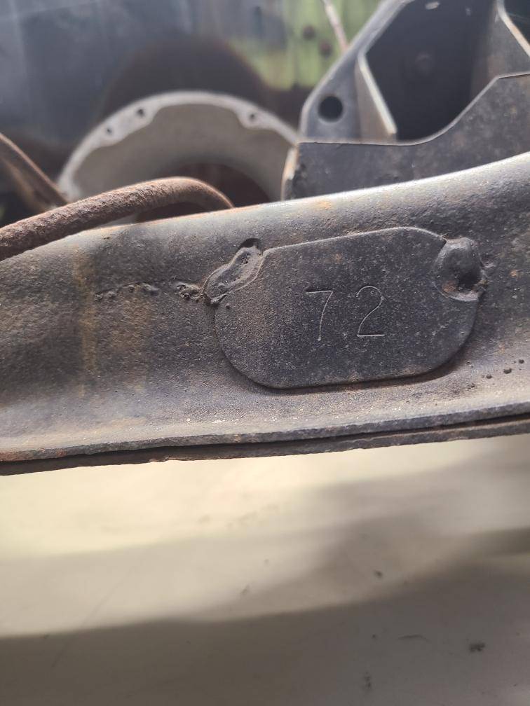

I have a k member with a coin stamped 72.Any idea what it fits.Its in my 70 AAR.Checking to see if it is correct.

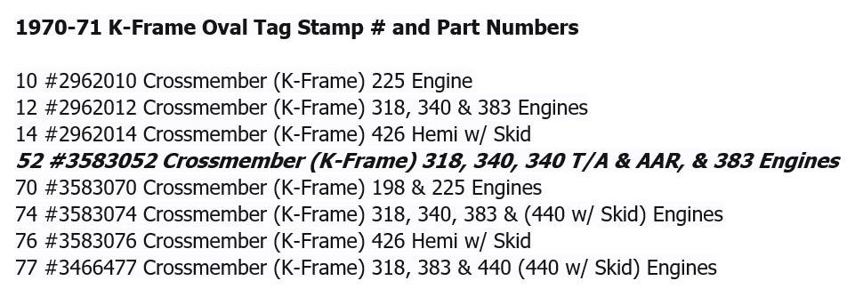

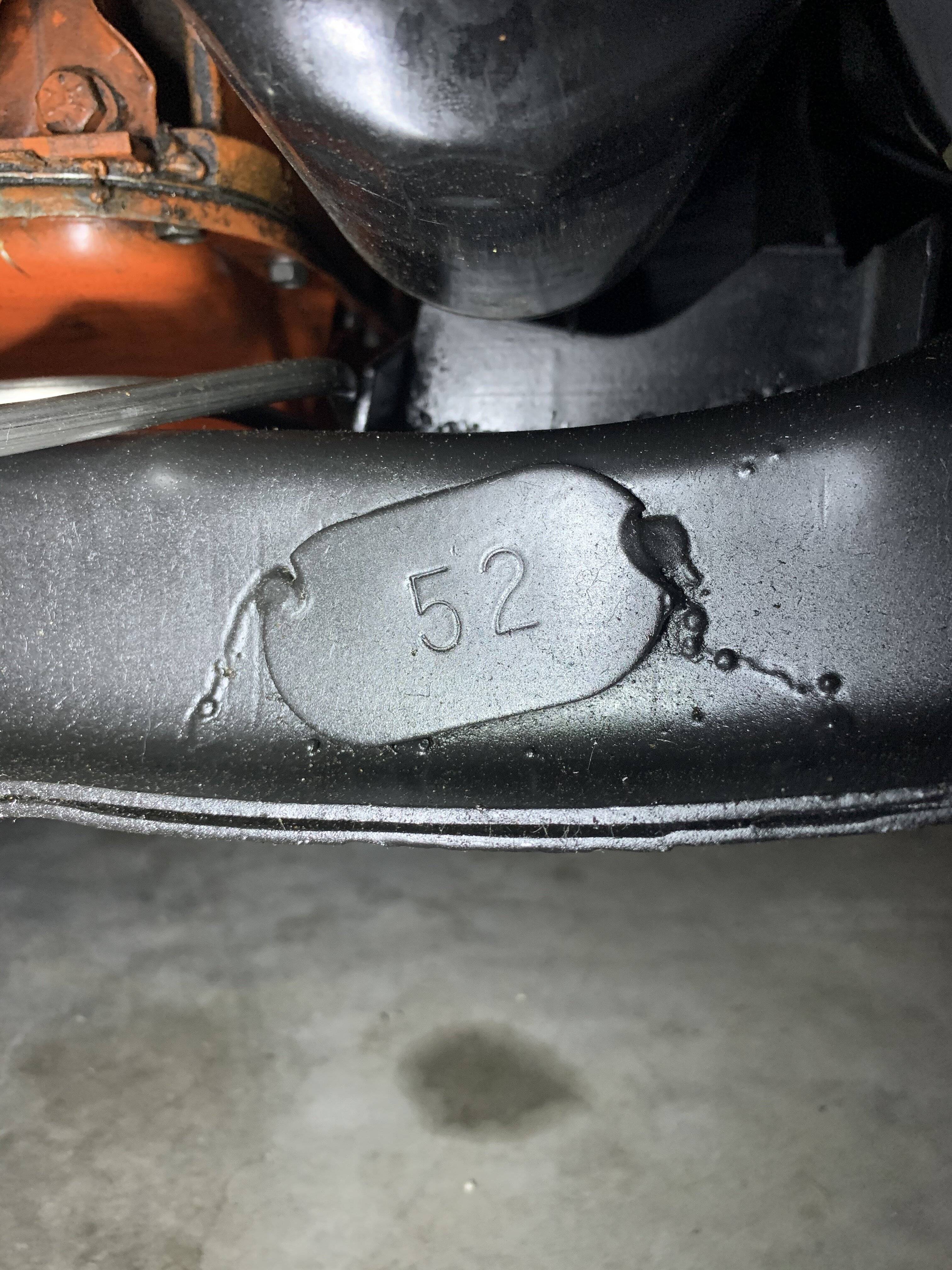

Can you post a picture of the oval tag? 72 does not show up on my info. Pictured is my K-frame.

I don't show anything with a part number ending in 72. For the A53 package cars it should be 52.

I have a k-frame with that same tag.
Got it at a swap meet because it was loaded coated. I thought it was represeted as an e-body k-frame.
However, I liad it next to the stock k-frame from my 383 grand couple I noticed the angle of the idle arm mount coming off the k-frame was different by 5 or 10 degrees.
I still don't know what it come from.

I have a 52 coin on mine, car is not a T/A, but is does have a skid plate.
Any one else have a skid plate on a 52 K-frame?
