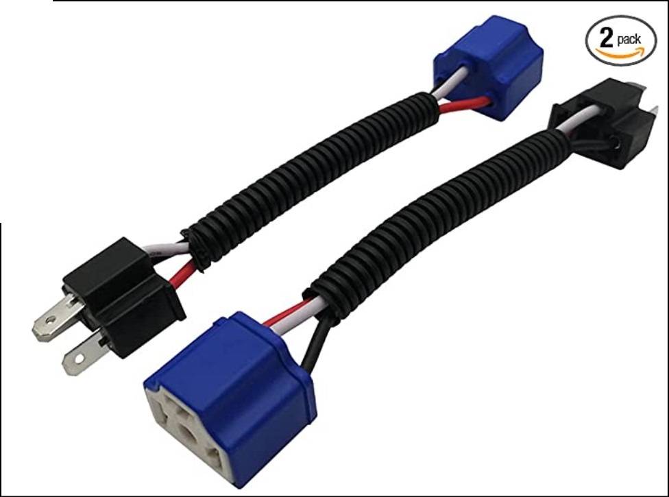

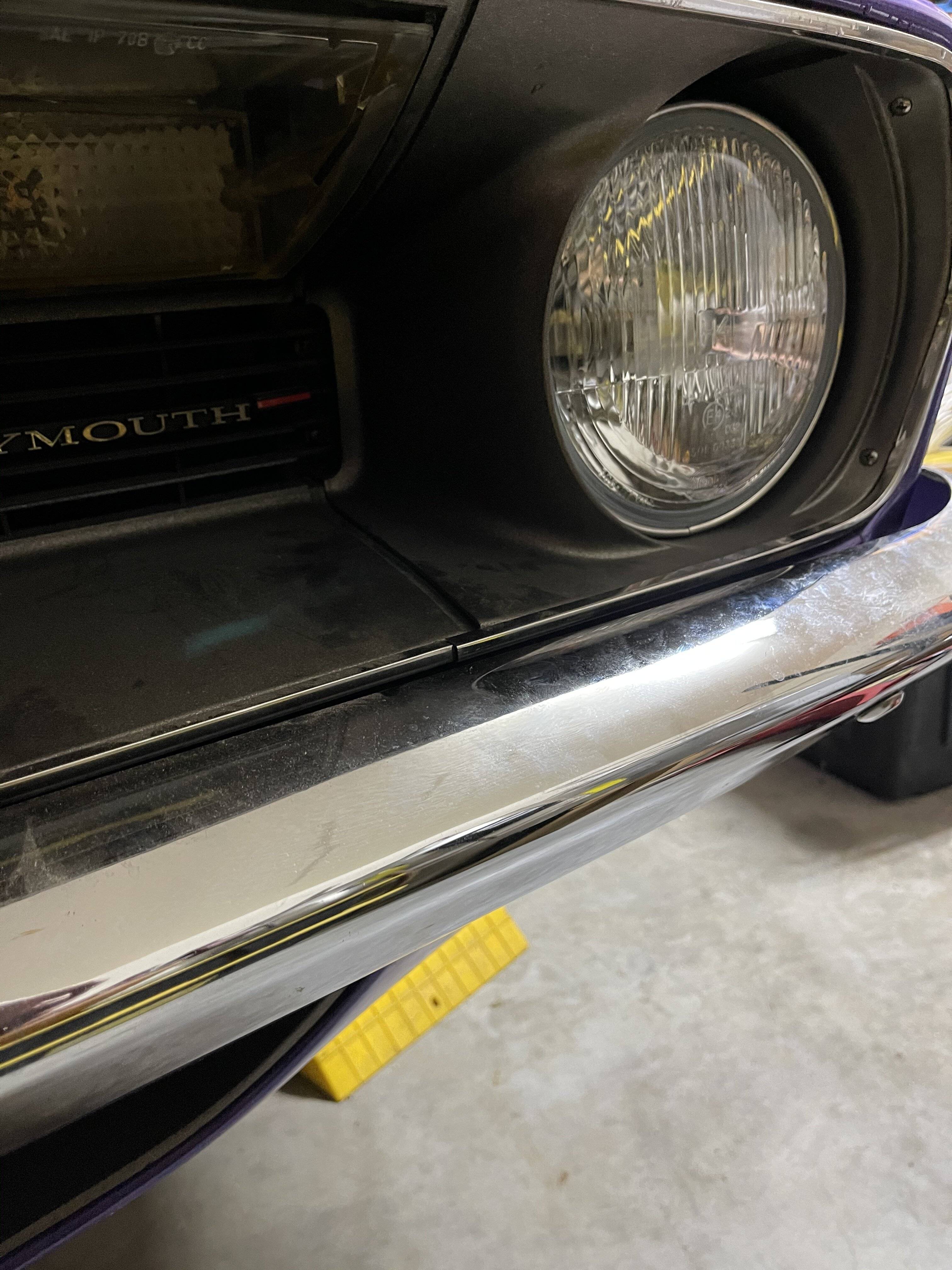

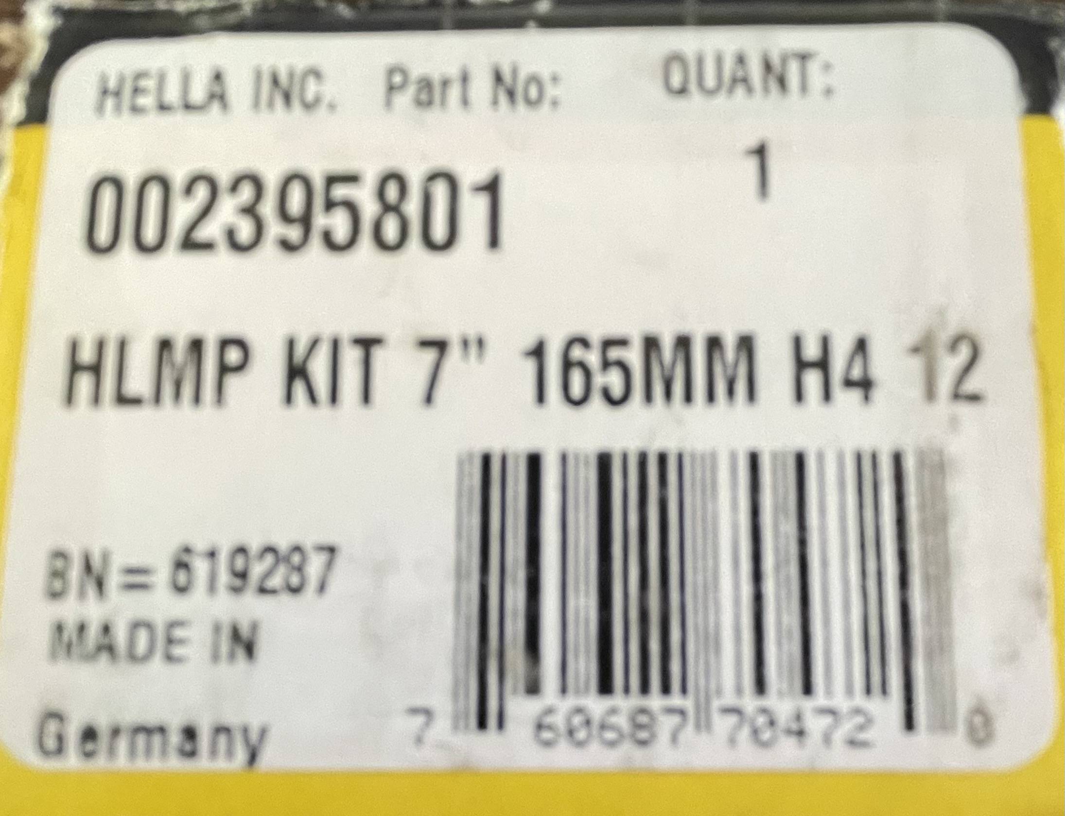

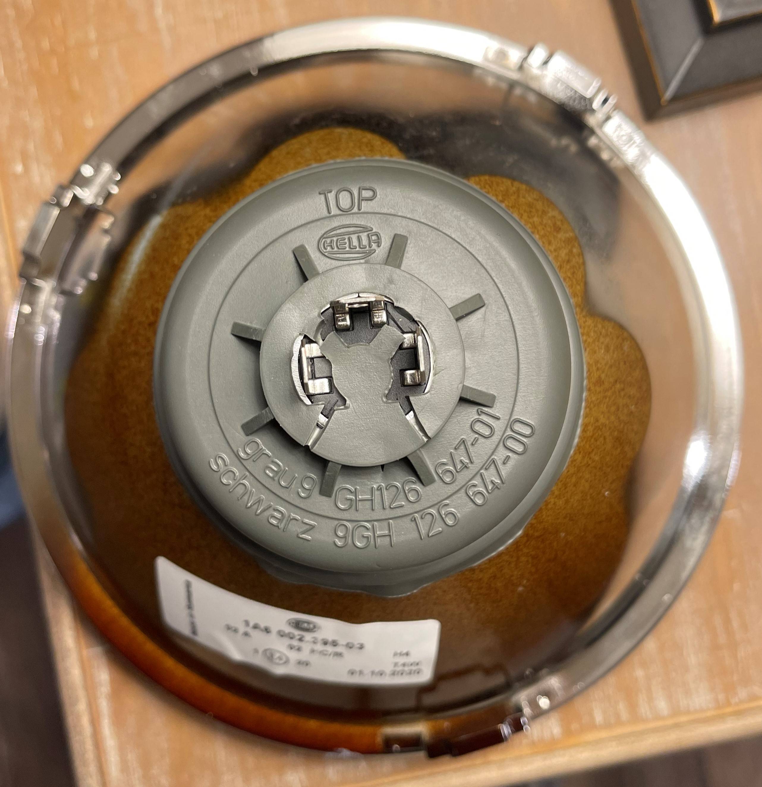

I changed out my GE halogen sealed-beams for Hella 7" H4 headlamp housings and AUXITO H4 9003 LED bulbs. They are 6500K which is very white. Most people prefer 3000K for a slightly more yellow look. The only issue was the rubber boots on the Hella housing need to be cut/trimmed to fit the bulb properly. It is also highly recommended that you install ceramic harness sockets to prevent the LED bulb from melting your factory plastic sockets. The LED amp draw is so low as to not need auxiliary relays or additional wiring.

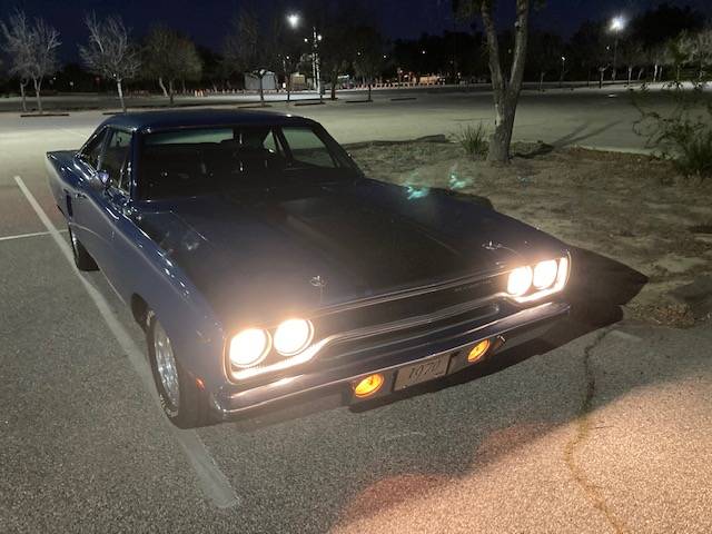

The Holley retro-brites are pricey but well worth it..
I installed (4) in my 70 RR.
They bolt right in and work great...
Just my $0.02...
U can find them for less $$, if U do a search. But yeah needing (4) does drive up the $$.
The lites are sourced from Mirimoto, and built well. What I like is their cast heat sink design which is shallow and allows the lite to be mounted in a stock bucket without any cutting.
