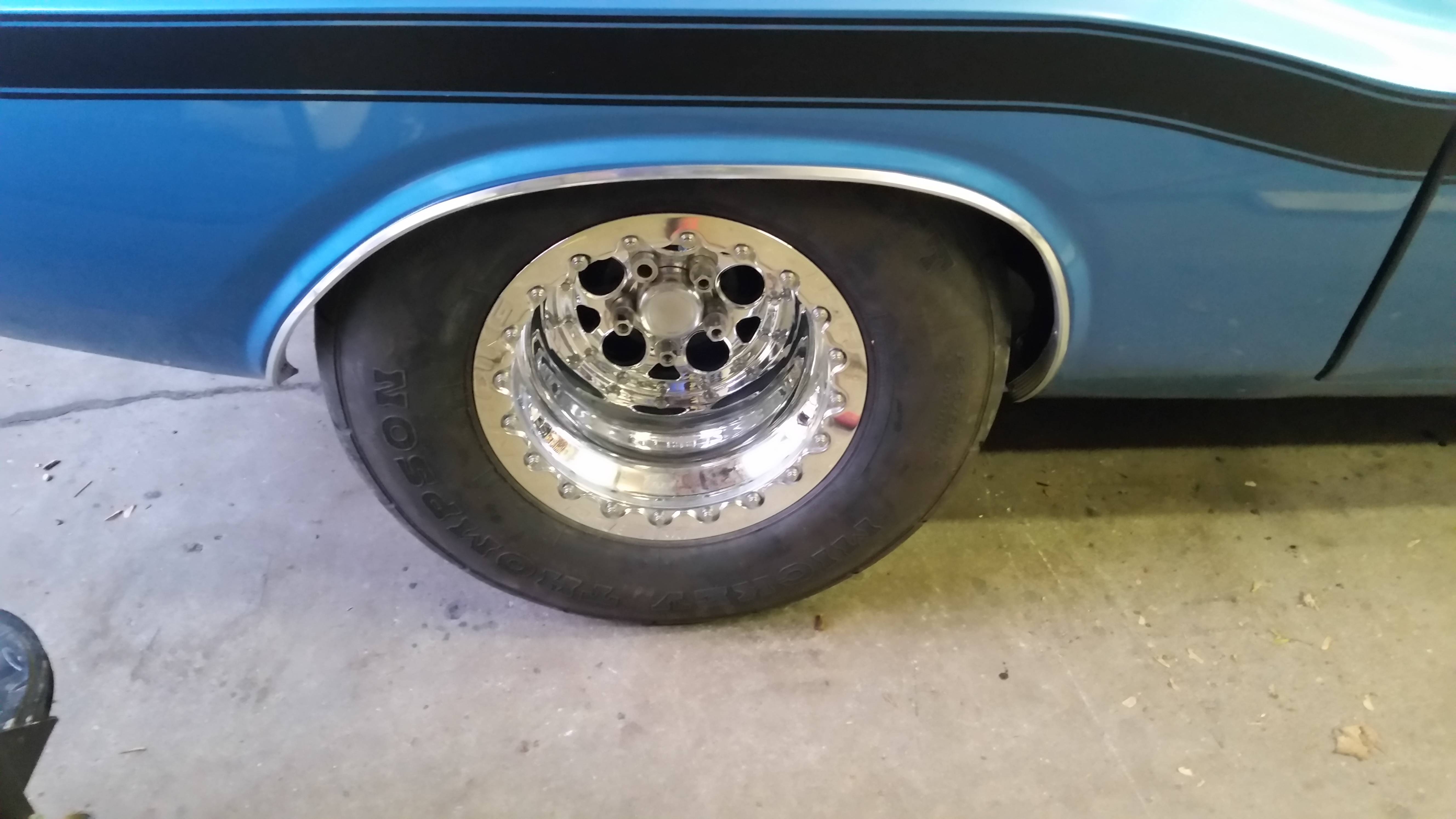

Weld Rodlites on mine, 15x8 on the rear and 15x7 on the front. These wheels have been on this car since 2002. Tires are BFG T/A's 275/60x15 rear and 235/70x15 0n the front. They have also been on the car since 2002 and are getting changed out soon.View attachment 86331

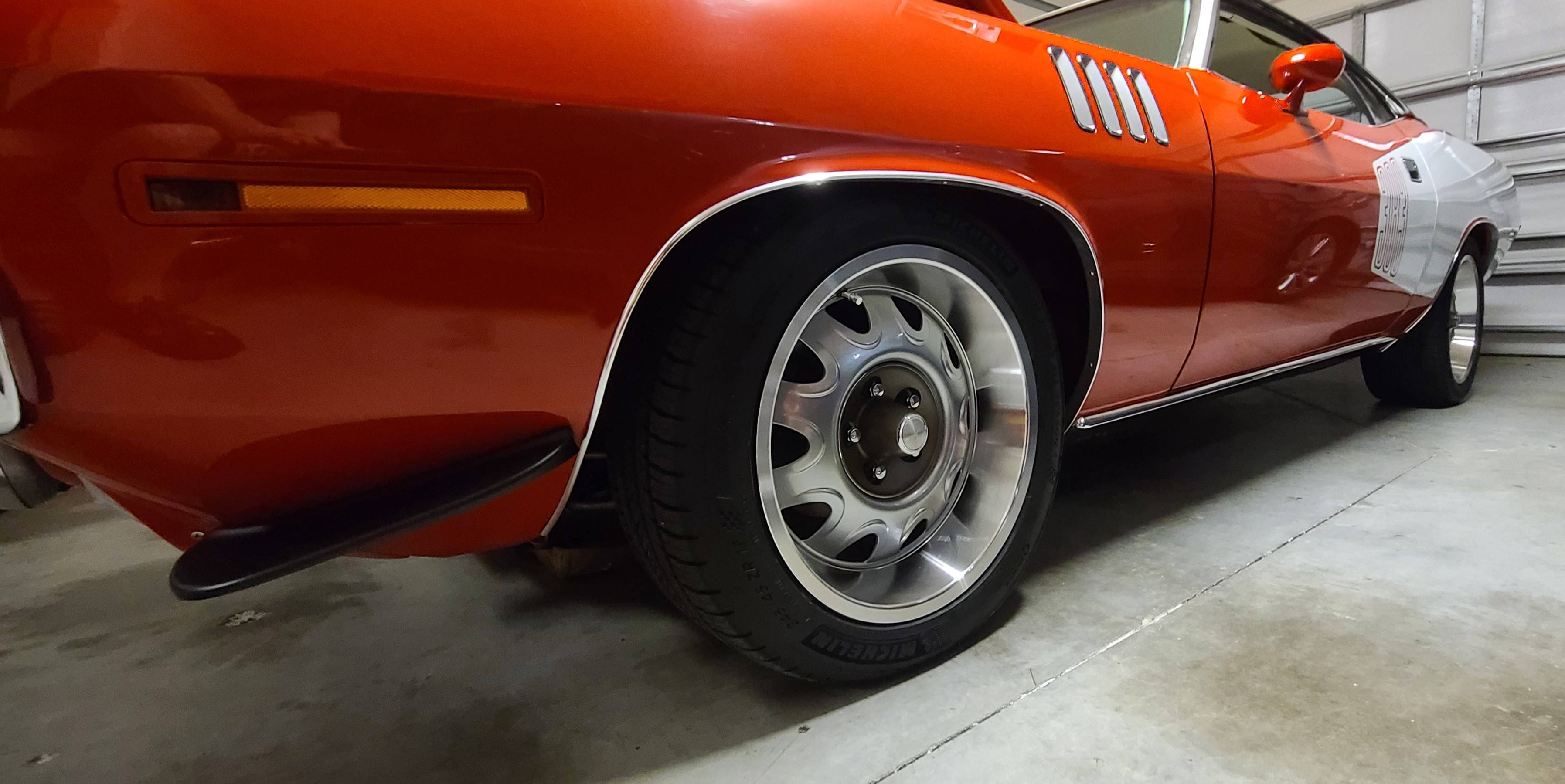

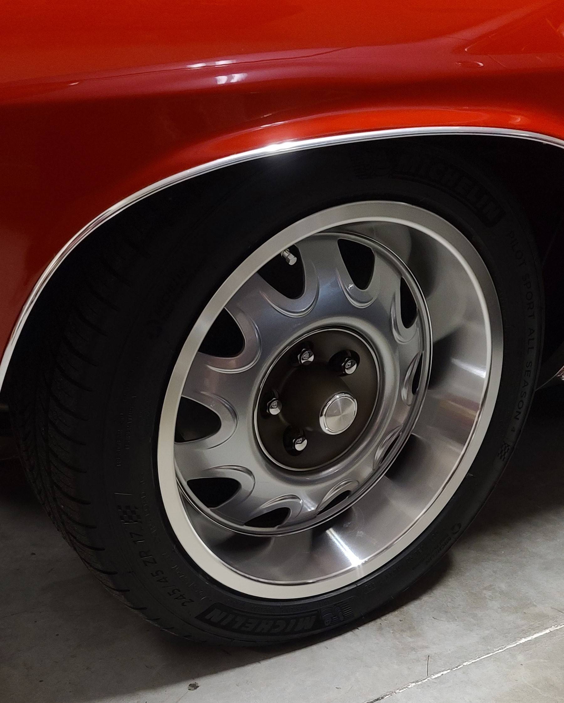

I went with YearOne's 8x17 and 9x17 Mopar Rallye Wheels wrapped in Michelin Pilot Sport All Season 4 tires. 245/45ZR17 in the front and 275/40ZR17 rear. They fit perfect. No rubbing, no need to flair the wheel well, no need for a shackle relocation kit in the back. I am very happy with the look and they seem to ride great!!!

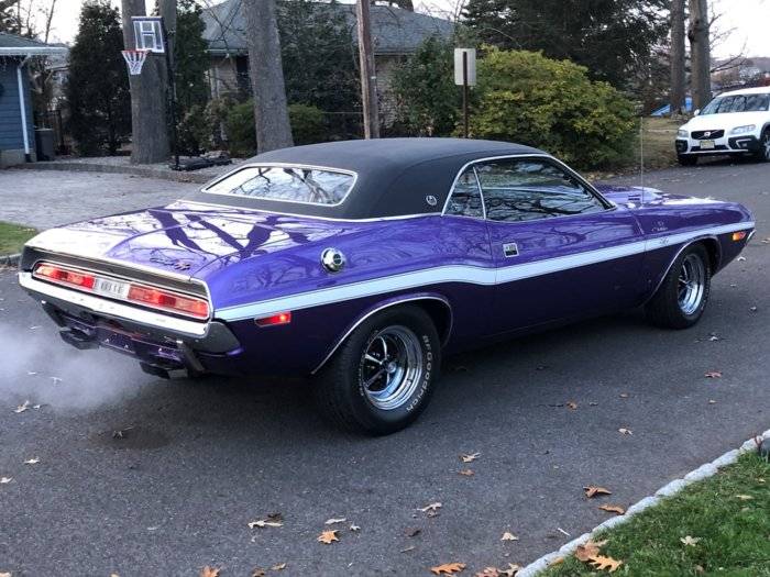

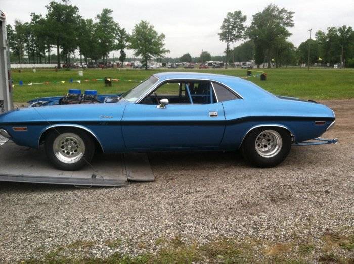

Steel wheels are nice but I think 15" Chrome Magnums look best. But that is just my opinion.

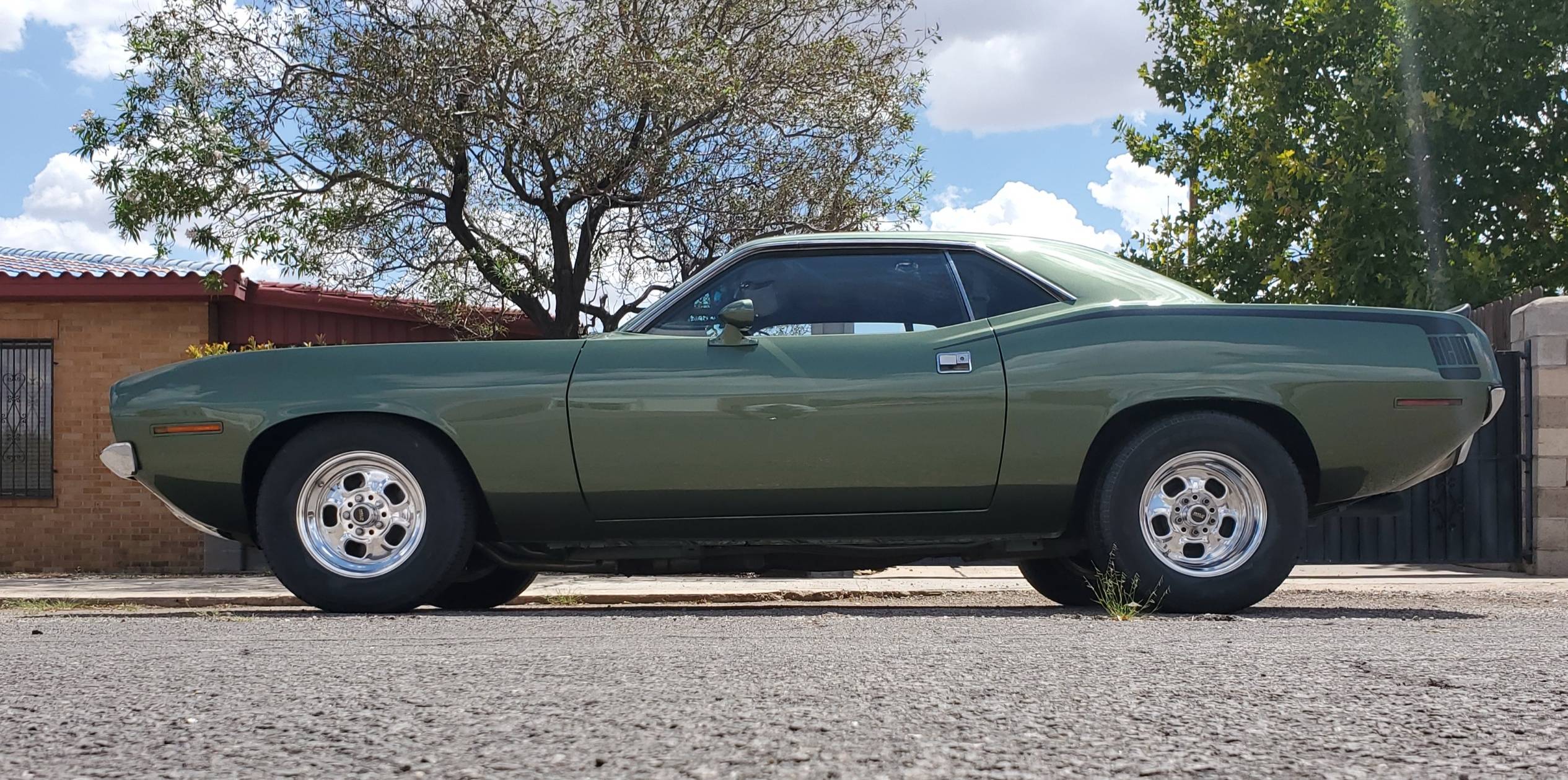

My Junk.
245/45-17x8 and 275/40-17x9
Firestone Firehawk, Indy 500 Wide Oval, Ultra High Performance Summer Tires
Great Grip and ride nice. Put them on in 2013
