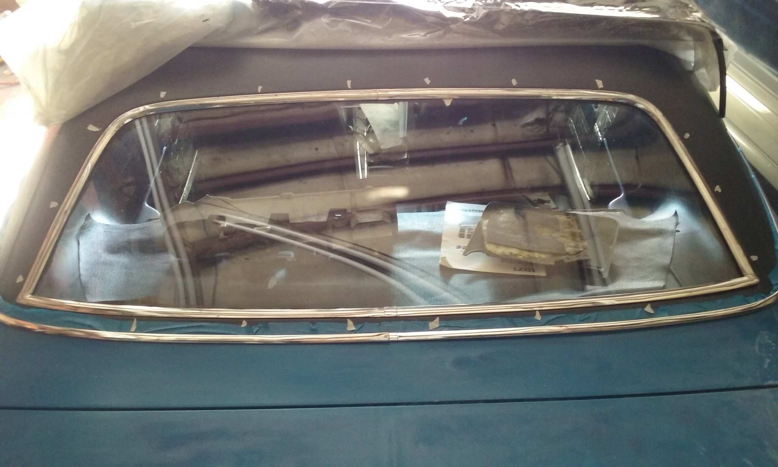

I have never installed a back window or front windshield before either. I bought some suction cups from Amazon to aid in holding the glass. I purchased the correct thickness 3M Butyl tape kits 5/16" and some 3M Single Step Primer, 08682, Black Color and one tube of 3M 08609 Window-Weld Super Fast Urethane Black Cartridge, Amazon sells both. I had a friend come over and help me install them (1st time for both). We test fitted without the Butyl tape to see where we needed to lay the butyl tape so that good contact was made on the glass edges and window openings. I know that there are discussions of Urethane vs Butyl tape and the pro's and con's for each. I used the Butyl tape because I don't trust the glass companies around me to be able to lay the proper thickness of Urethane so that when the glass is laid in, the moldings fit properly.Looking for someone, or a shop that can set windshields, and get all windows to seal properly. Never done this before, and don't feel comfortable doing it myself. All materials are here ready to go.
