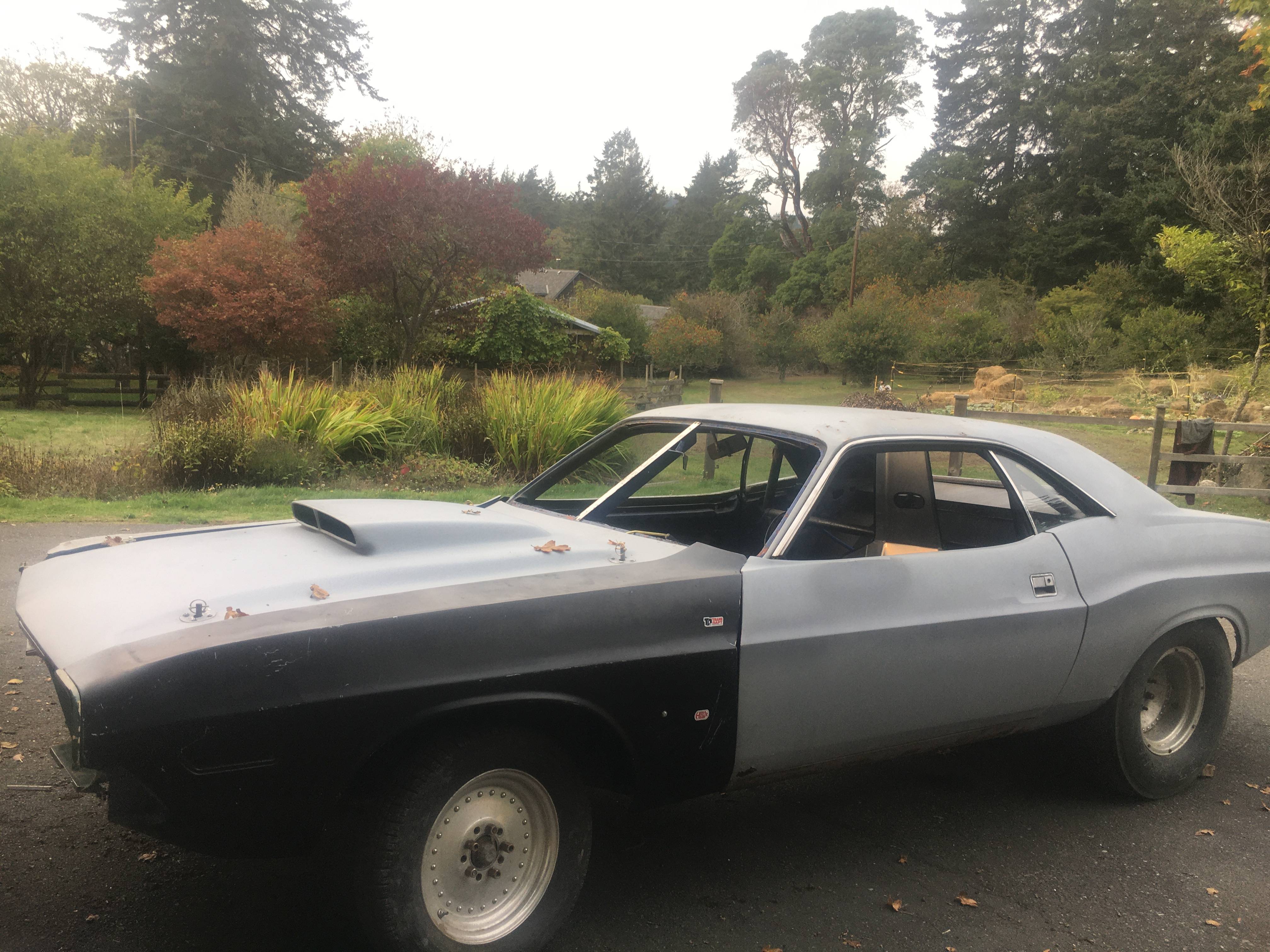

Hey everyone, I am looking for an intake manifold for a 440. Either a MoPar performance m1 or an Edelbrock torker 2. From what I have read those are the best two intakes to use, anyone have any other recommendations? Also looking for a set of magnum 500 wheels. I am located in Victoria BC Canada.
Thanks in advance

I think those are a couple of great choices for single planes especially if using a Holley Sniper or Fiteck EFI system. Also its pretty hard to beat an Edelbrock Performer rpm and a 850 double pumper if you want to stick with a carb.
Looks like you have plenty of hood clearance for any of those high-rise intakes too. But like the gentleman said all the parts need to match from the cam to heads to compression to intake to weight to gears to fuel so not an easy answer for sure you need to look at the whole package to really maximize all your choices and efforts.
