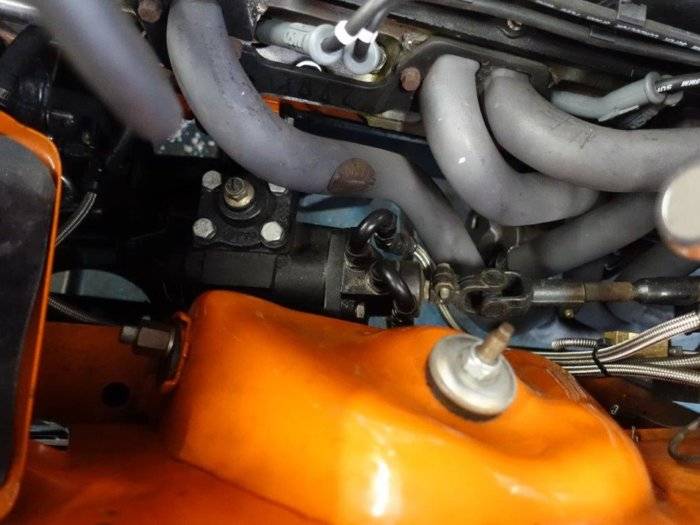

I did the C-body tie rods in Moog last summer, before that some years ago I did the Moog ball joints control arm bushings, strut rod bushings, etc..
This year I put the Borgeson steering conversion in. Roughed in the other day.
box is tiny compared to original, about the same size as the manual box.

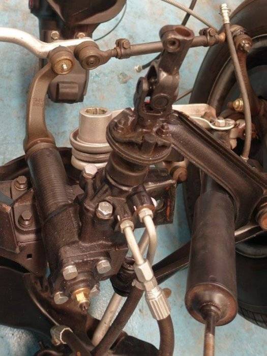

See pics of Borgeson.
If you cut the weld on the steering shaft about 2" up from the end you can use a slide hammer to draw out the old spline then refit using a Toyota landcruiser spine tap into the shaft from where you removed the dodge spline then reweld & pin
The strange thing is the Toyota spline made 45 years later is identacle to the dodge spline.
There are 2 version 1 i used a Toyata universal joint the other same but with a rag joint coupling ,the spline of the Toyota fits straight onto the Borgeson box.

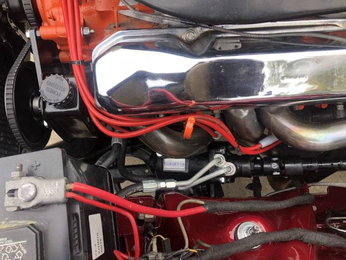

My direct fit coupler will bolt in direct, so cutting is not necessary. I also make hydraulic fittings to resuse the original hoses for a more sanitary look.
This is roughed in and working awesome. Need to reposition the hoses a little, other than that pretty clean.
