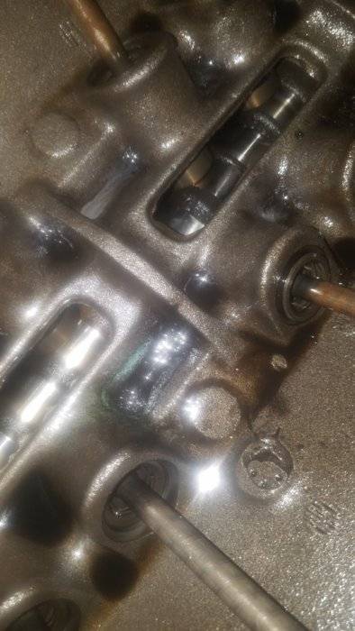

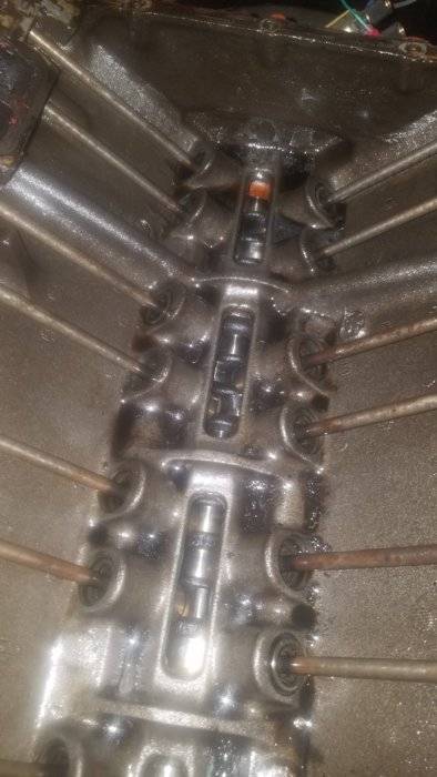

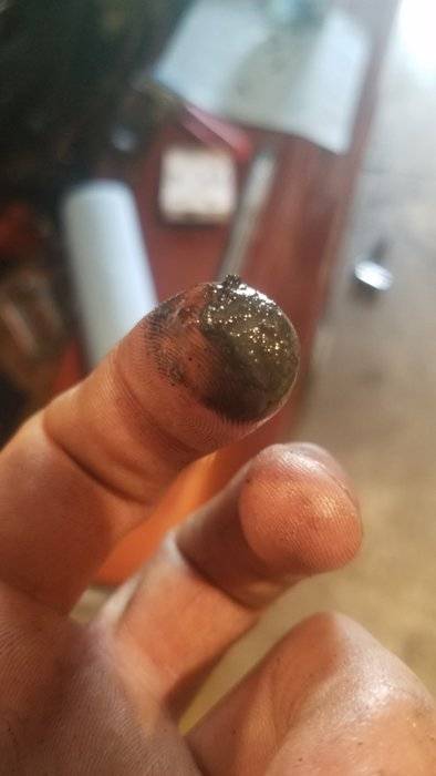

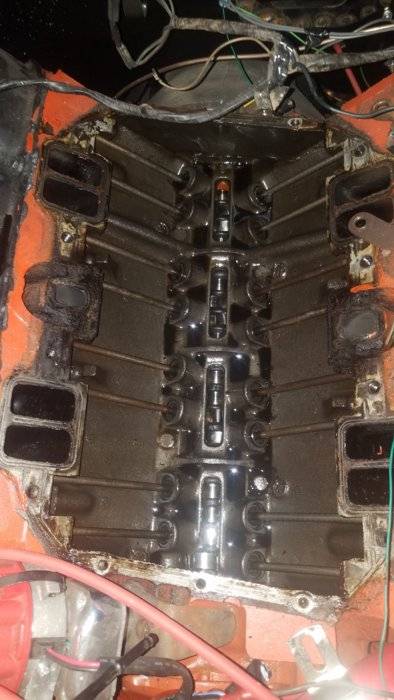

Ill pull the pan when i pull the engine. I just pulled the intake and valley pan. Theres gray paste in the bottom of the lifter valley. The paste seems to get deeper closer to the 3rd cam bearing.
Also theres this green moss like stuff in one of the pools.

I think the silver sludge is actually zinc additive that settled In the lifter valley. That would explain the green stuff.
IMO, the goo/paste collected in the valley low points is typical of an engine that hasn't been rebuilt. Seen it many times before.
Looks like it come from the top what is the rocker gear steel or aly
Could be dried green coolant cut the oil filter open see how much is in the filter ,the particles look too big to be an additive.

Steel rockers. I think the bigger chunks are carbon deposits from the exhaust gas cross over
IMO, It's sediment buildup over time. Particles of cast iron, hardened umbrella seals, gasket material, separated oil additives, condensation, blow by deposits, etc., collecting in the low spots of the engine.
Find out where your shiny stuff is coming from.
