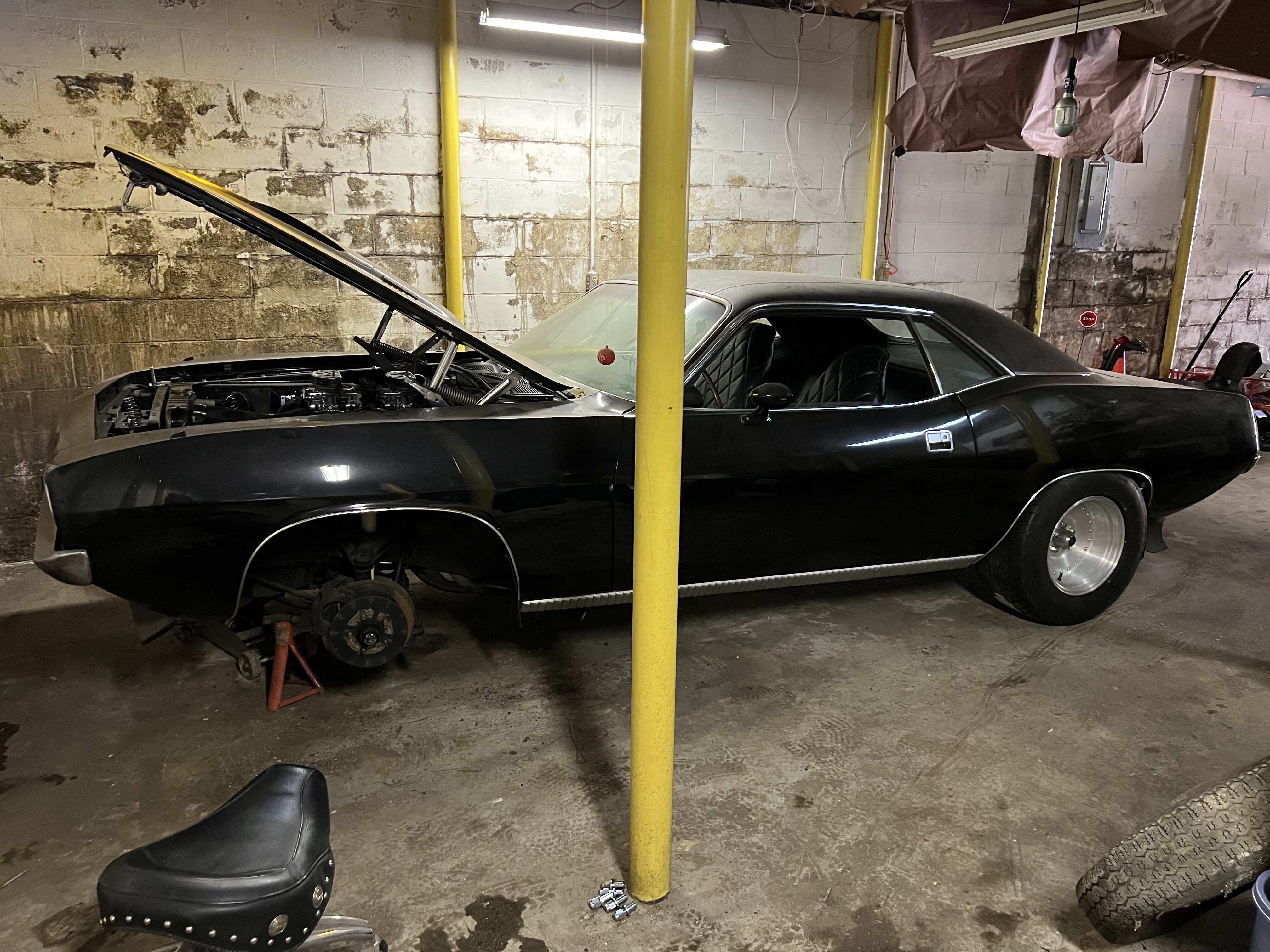

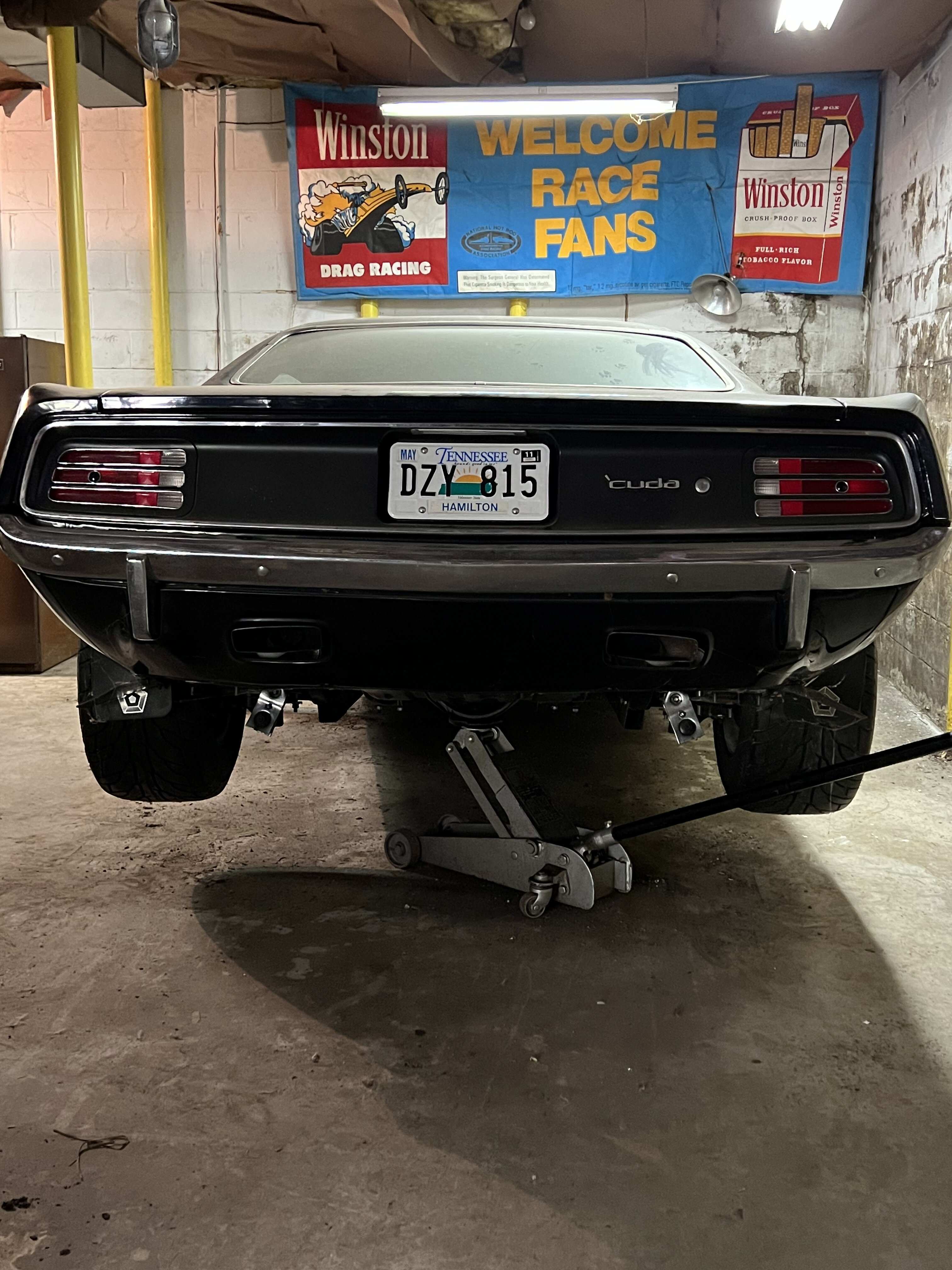

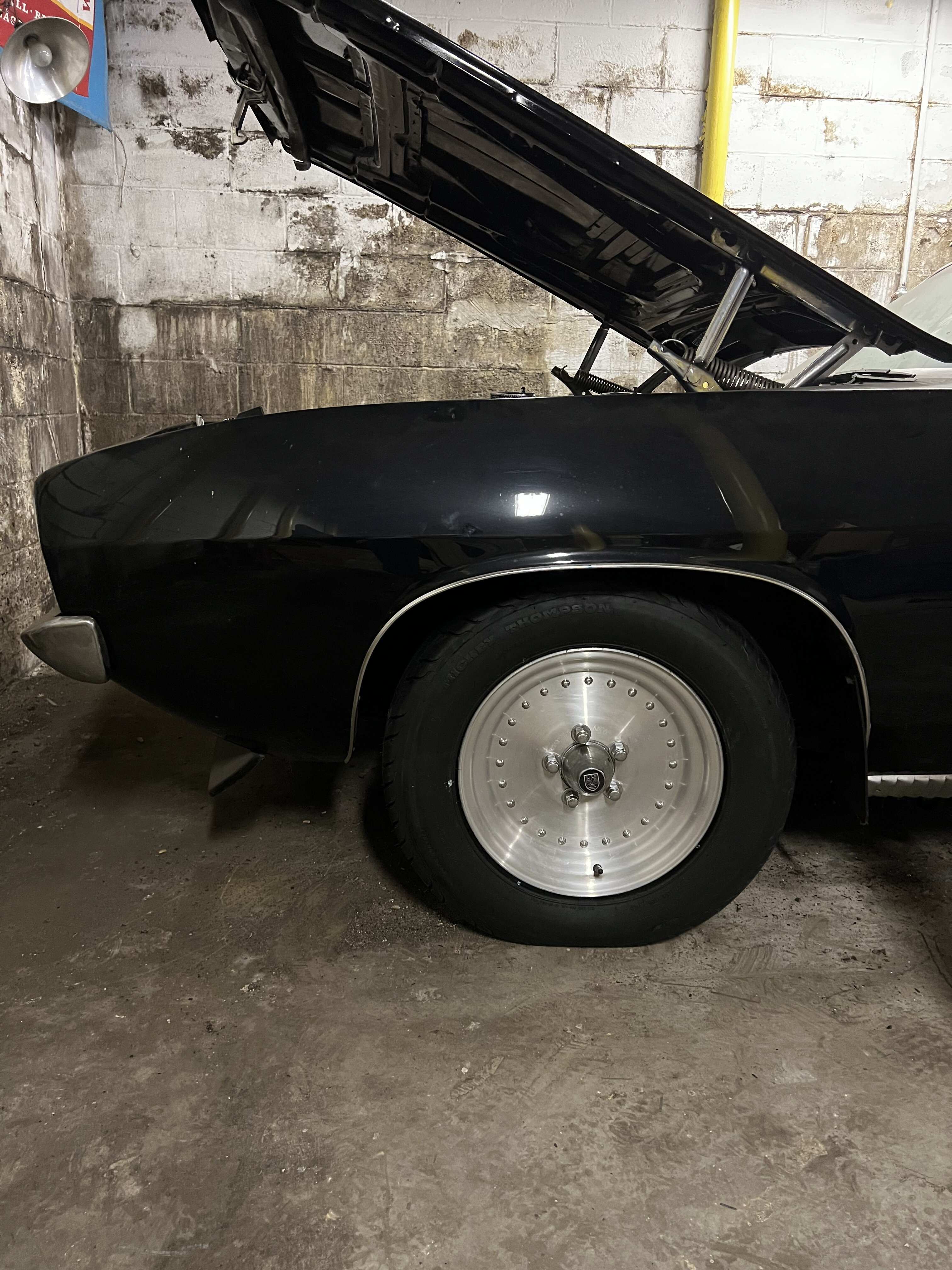

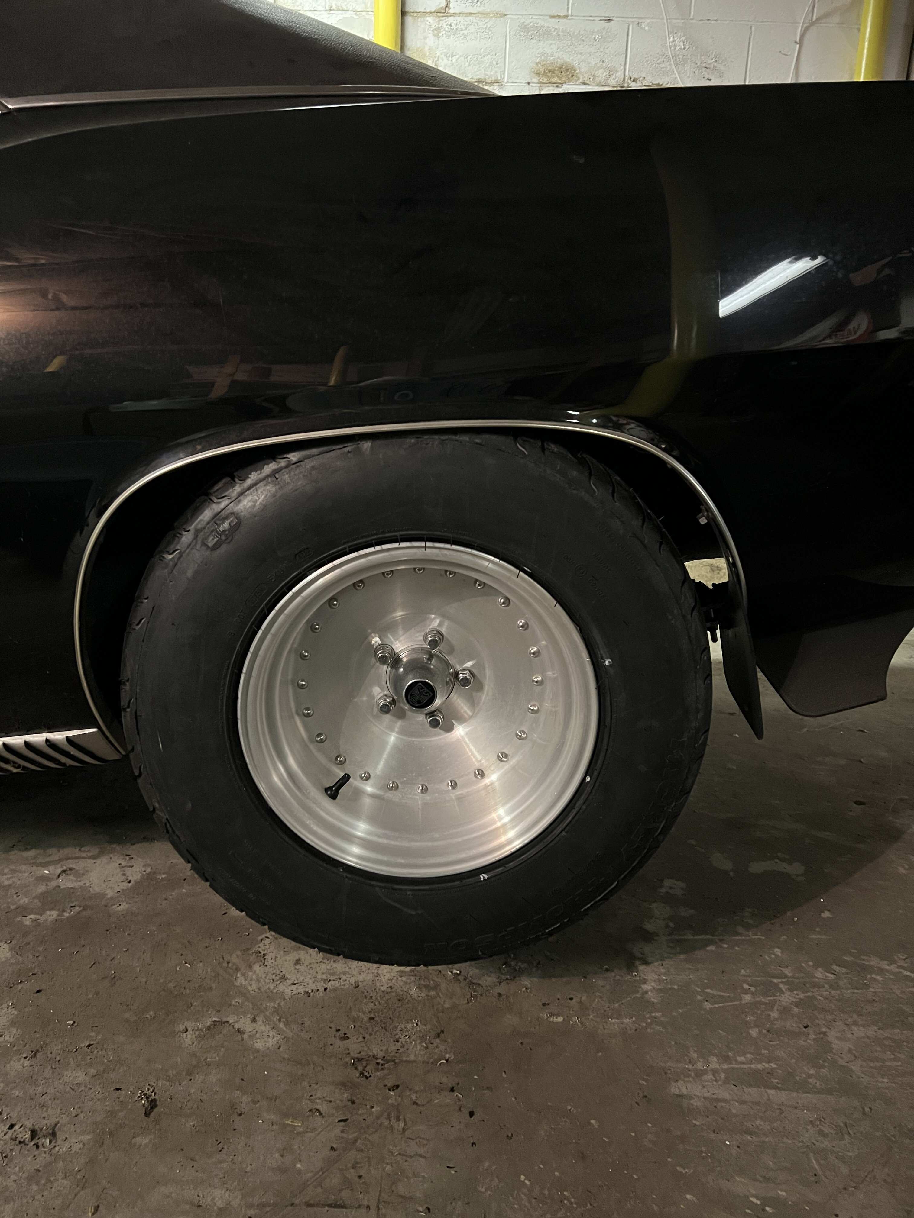

I was worried when compared side by side the new MT’s was about a 1/2 inch shorter than the old Goodyear L60x15 Polyglass GT’s which was good but the tread width was about 1inch more. The fender lips have been rolled since 1980…thank goodness. There is clearance but only about quarter inch. Left it jacked up thinking about taking them off and tweaking the top center of wheel well. I know you can’t tell much with it up in the air. I did take two pics anyway. Stand by for more. It does fill up the wheel well!

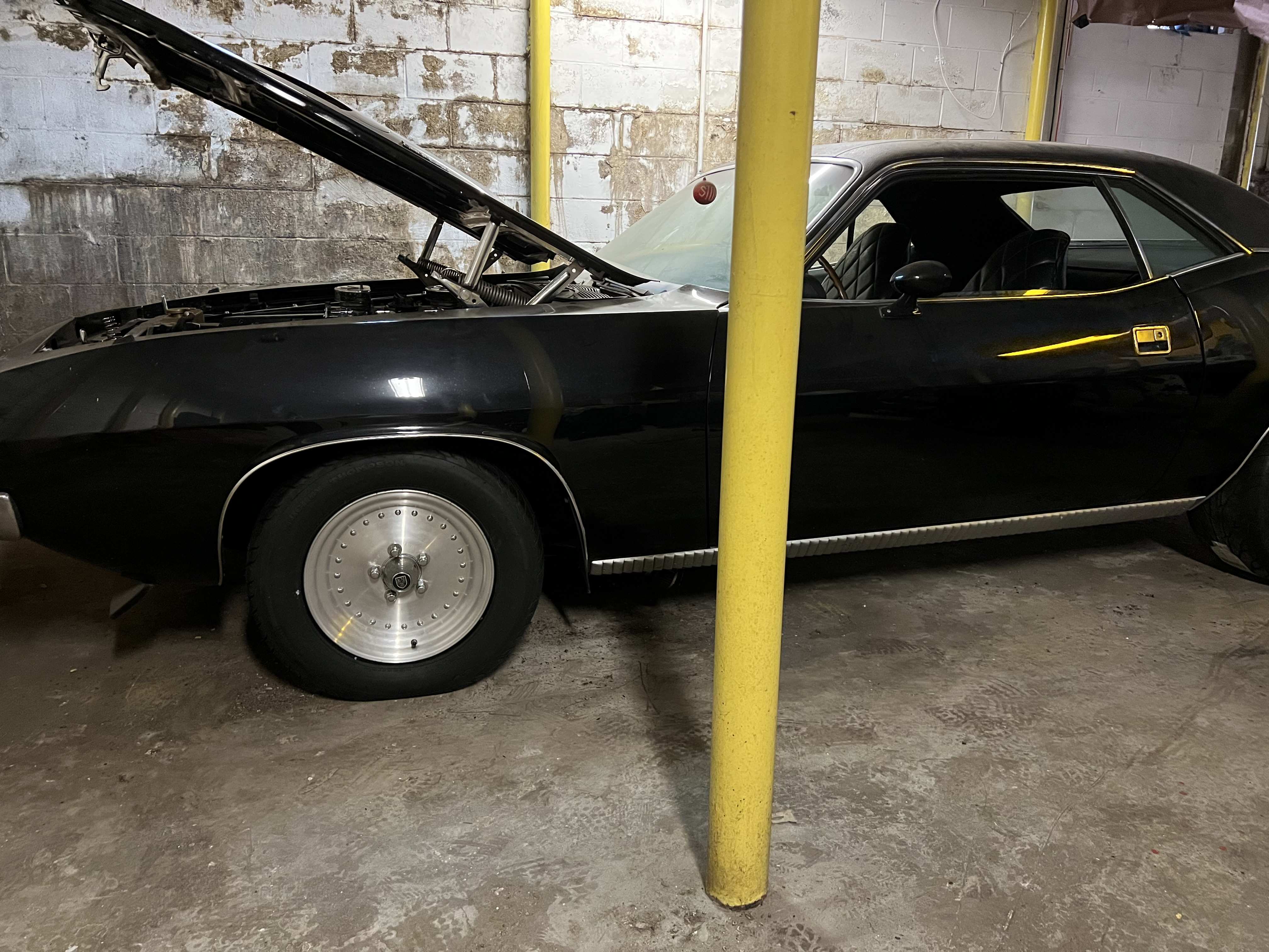

I don’t remember What the backspacing is on my 15x10. I bought them back around 1978. However I‘m going to have to take them off again to try and get a little more clearance on the rolled fender lip. I’ve not measured for leaf spring clearance but I don’t think the tires are close. I’ll try to remember to measure that. Not sure if you can see from this pick.

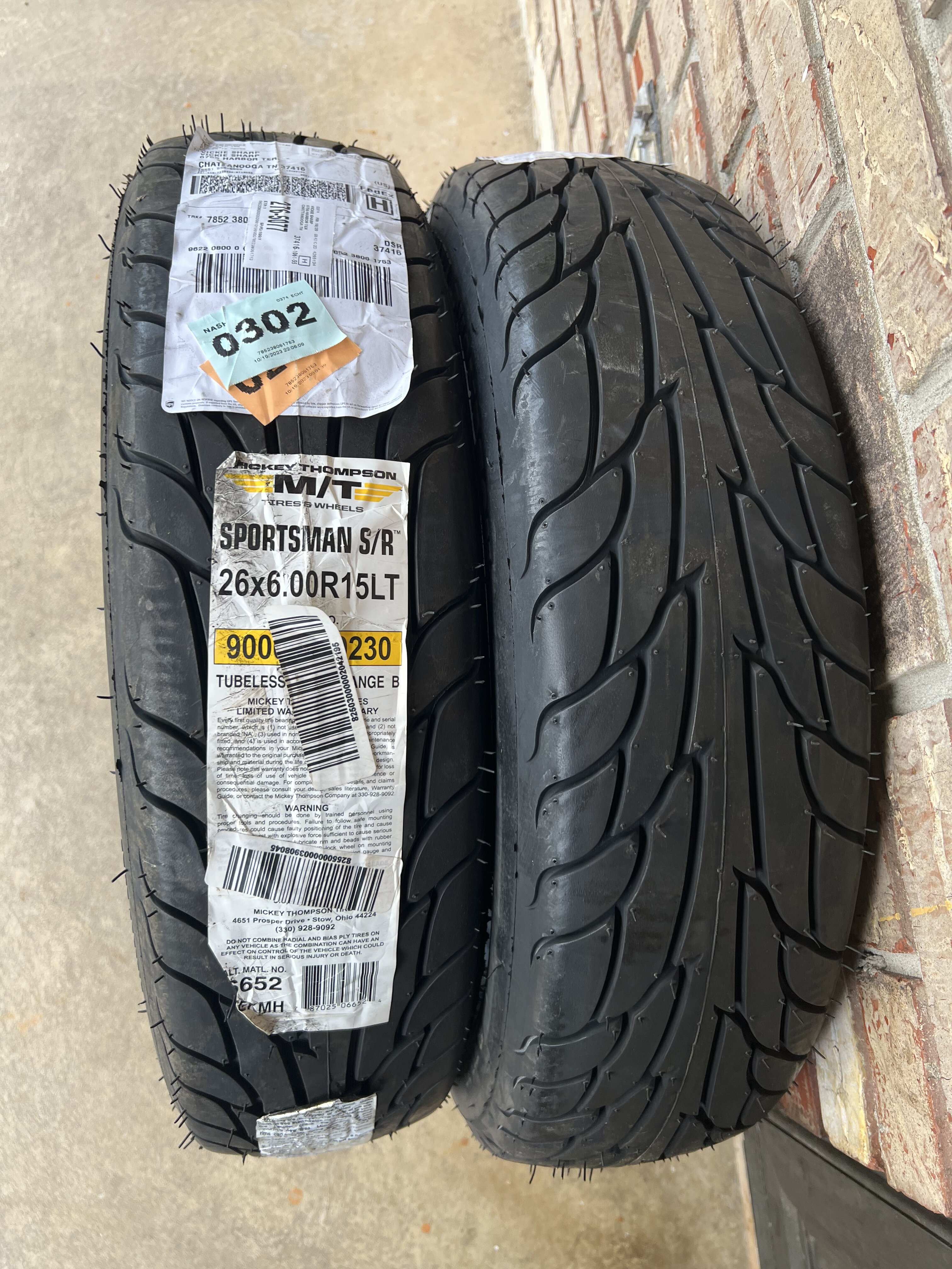

The M/T fronts are 26x6.00R15LT.
