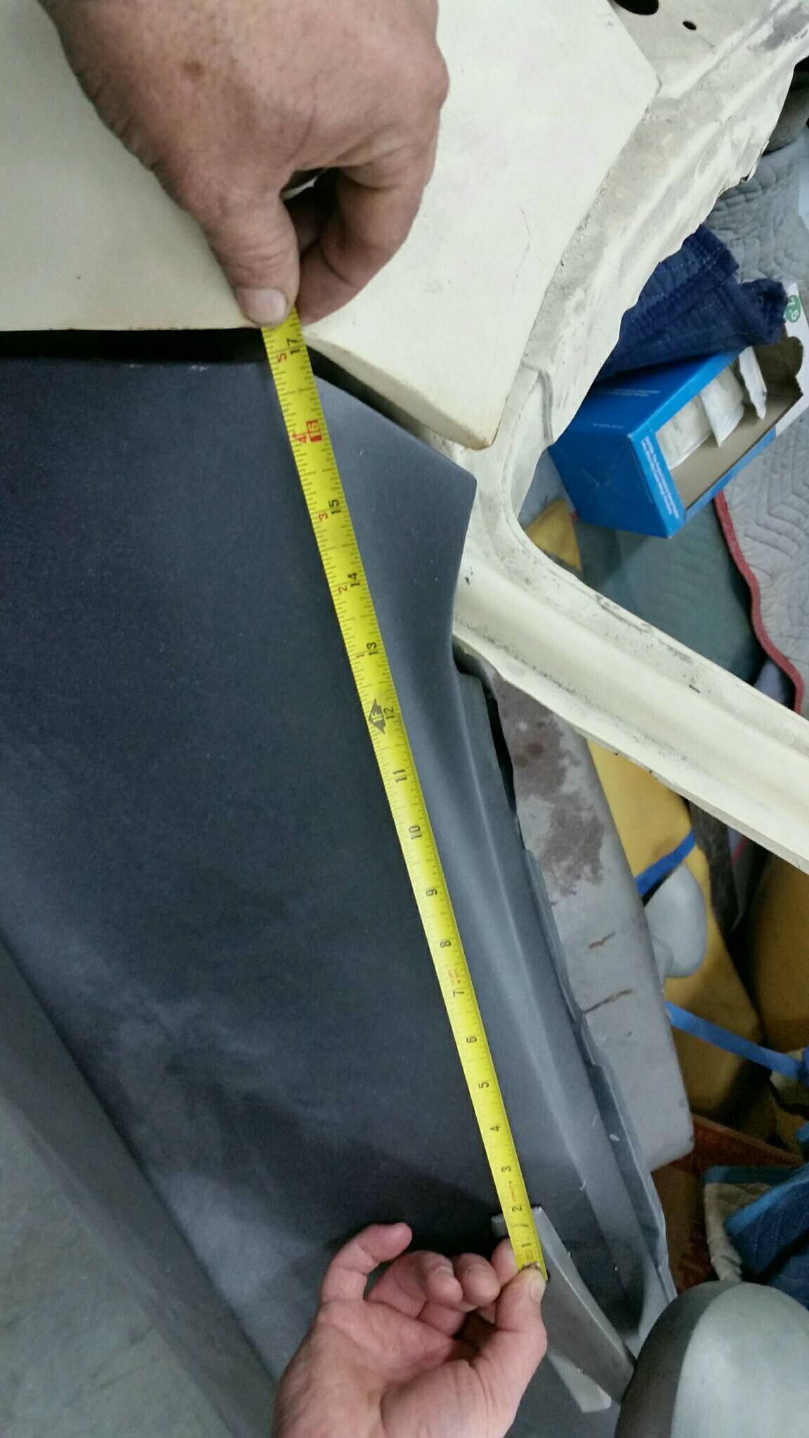

I am In search of someone who has a Factory dual mirror Challenger 72 is my year model but I believe anything from 71 to 74 is the same I'd like to know the measurement to the front Revenant hole on the passenger side And the driver side I've had to replace my door And it does not have Provisions for the mirror Thanks for your help I'll put a picture in So you can see how I measured my driver side

Yep there in lies the problem I have measured to passenger size doors That the measurement comes it in at 15 and a quarter to the center of the first bolt hole And the driver side measures 17 inches So I either have The doors off of two different cars Or there's two different measurements I'm trying to find out which one is right That's why I was saying if somebody has an original Dual mirror car To take the measurements off of it might clear up a lot of confusion in my world Thanks for all your help

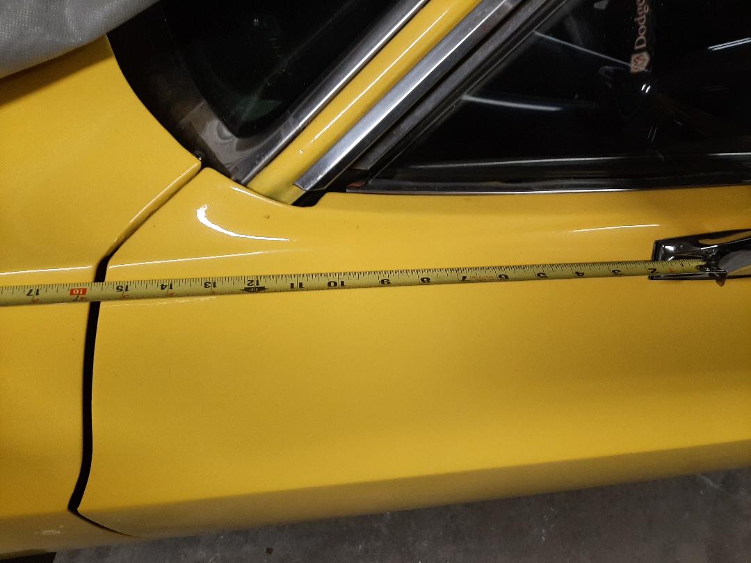

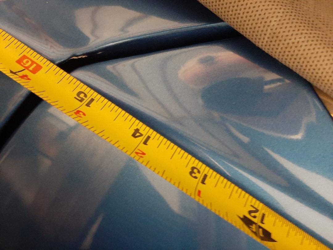

71 Challenger convertible original passenger mirror/door. I hope this helps.

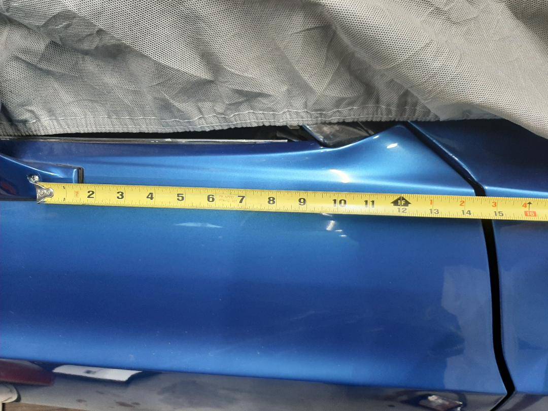

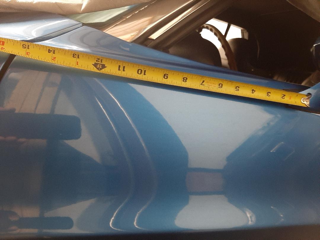

Drivers Door mirror. I believe the measurements are about 1 inch difference due to the drivers angle view. My other Challengers have been the same way.
