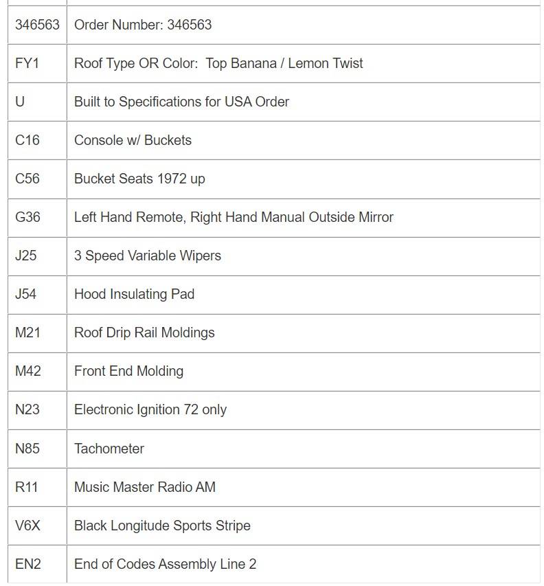

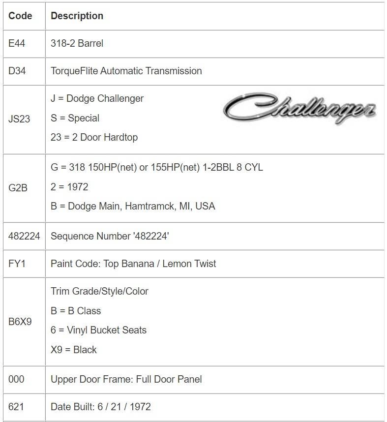

You can input your broadcast sheet in this decoder for a 1970 E-Body and it will create documents that will help you with identifying what you have. Do the best you can to make it match up everything when inputting the letters/numbers since the 1972 broadcast sheet differs from the 1970. The site may eventually build decoders for the other model years so everyone can get the full decode of their sheet.
It will not be completely accurate since the decoder is 1970-specific but at least you will have something to compare to other websites that tell you what each alphanumeric option is for 1972.
The basic information at the top of the broadcast sheets did not change much over the 1970-1974 E-Body model run.

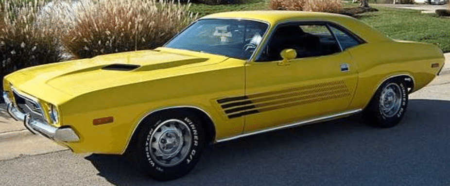

The car below is one of the few I found on the Internet with no vinyl top and Rallye Wheels (W21). I edited out the 340 hood emblems and the fender mounted turn signals (A01 light pkg) from photo since your Rallye has a 318 without the A01.

Joe, A few notes on your car from the build sheet; 1972 Rallye Challenger built in Hamtramck w a June 21 build date.
FY1 = Banana Yellow, with the V6X (black side stripe,)
E44 is a 318 w the 34 trans (standard duty).
T86 tires = F-70-14.
Torsion bars 778-779 and S13 suspension = heavy duty suspension (same T bars used on a 340 and 383 in 70-71) (my 70 Challenger A66 has the same bars)
Coded for the sport hood (J54)
W21 = rallye wheels w trim rings.
You have a really great Challenger; Enjoy her! :thumbsup:

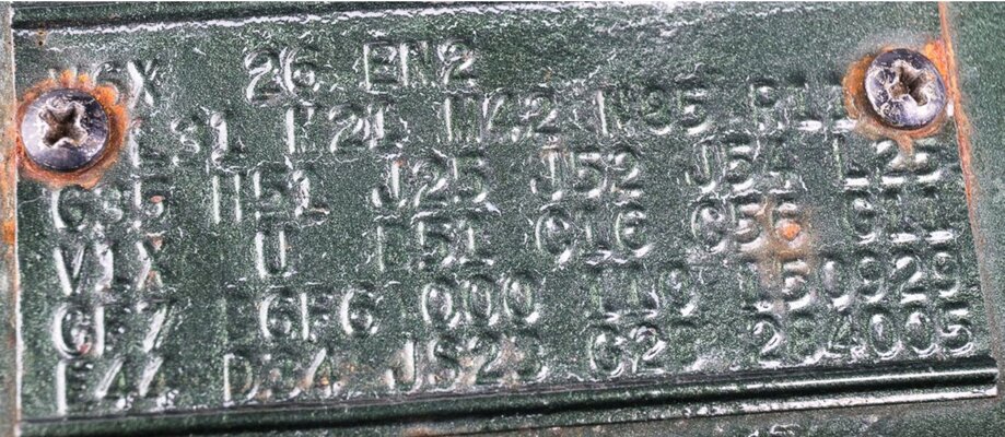

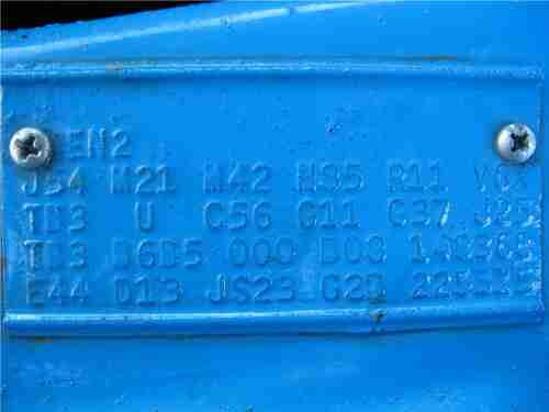

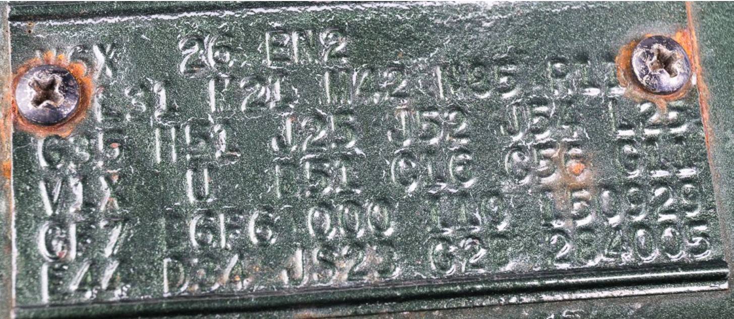

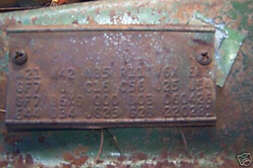

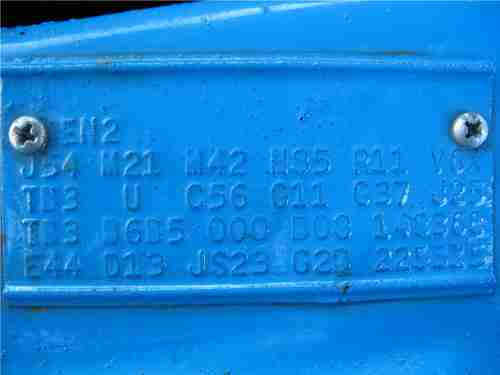

I messaged tomjan_coop with a lot of info. Here are a few JS23G2B tags showing what is typical on a 1972 Rallye. Your Broadcast Sheet has everything needed to identify and properly make a tag but what goes on the tag and what does not requires some research to get it right the first time. An example would be the N23 - Electronic Ignition which is optional for a 318 but standard on a 340. Your sheet has the optional N23 on Line 11 so that should definitely be on your tag. The assembly line workers had to look at the Broadcast Sheet to know what to install so the N23 code let them know to put the special bracket, Electronic Ignition module, and the correct engine harness on the firewall.

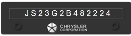

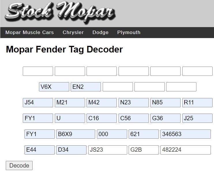

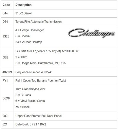

The info from your decoded Broadcast Sheet for a fender tag is below.
The J54 is actually the Sport Hood a.k.a. "Rallye Hood" and the V6X is the Rallye Strobe Stripe.

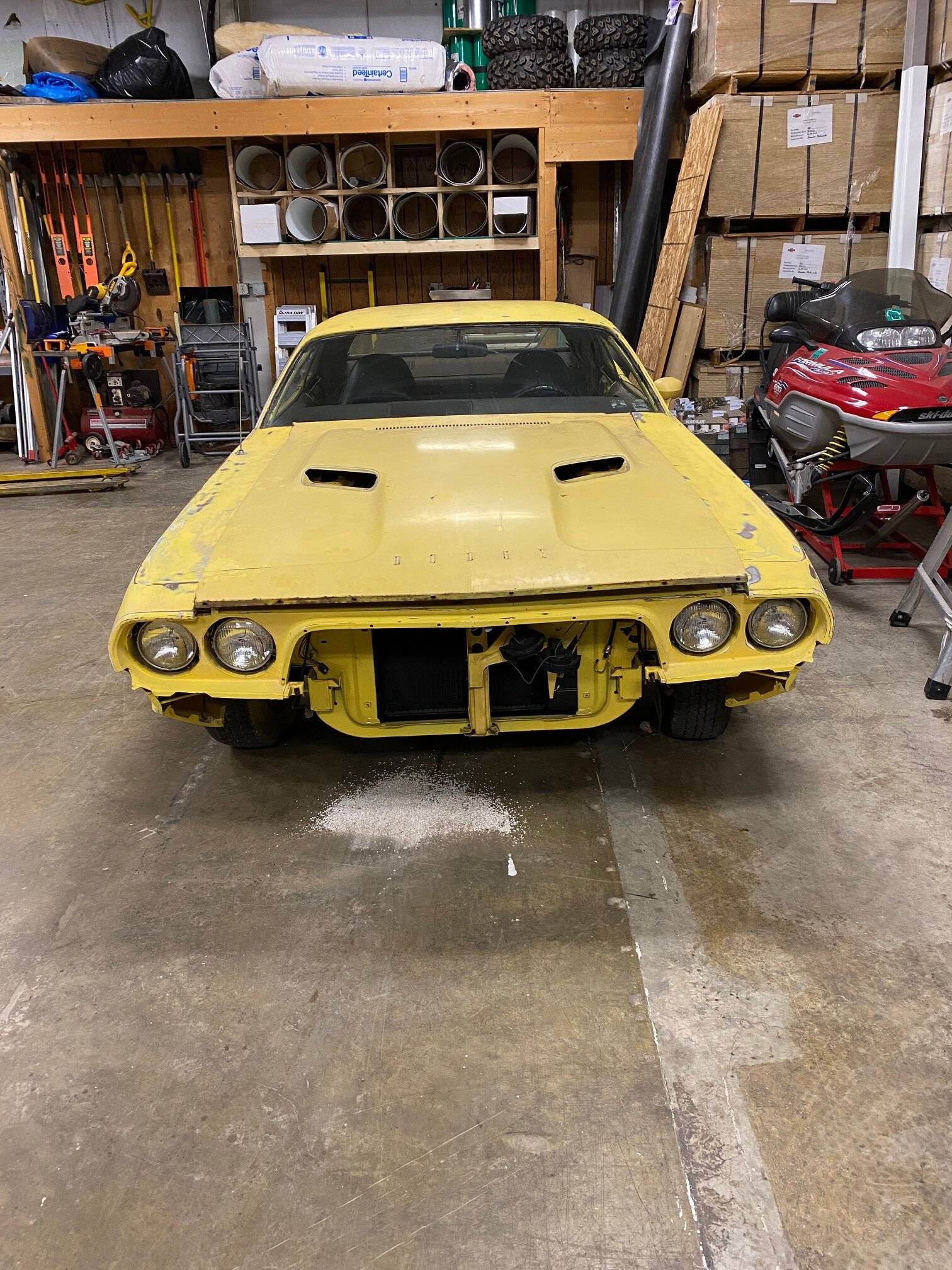

Really thanks for all the info! I will not be making a "show car", so I don't really care much about having the tag. I was more just compiling all the info I can about the car so I don't buy/order parts that do not match it. JWILlI13, you are 100% correct in your deciphering of the VIN.

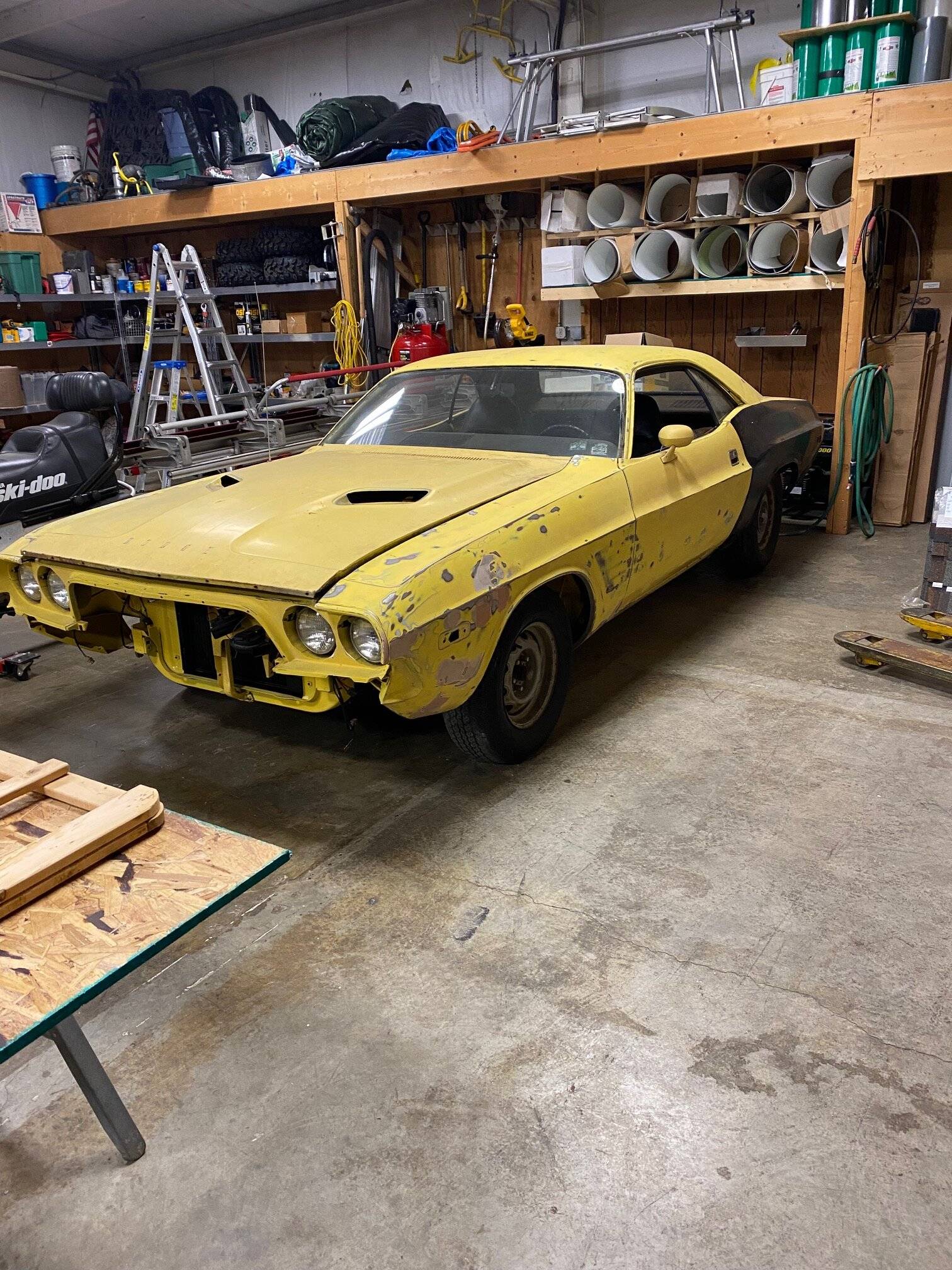

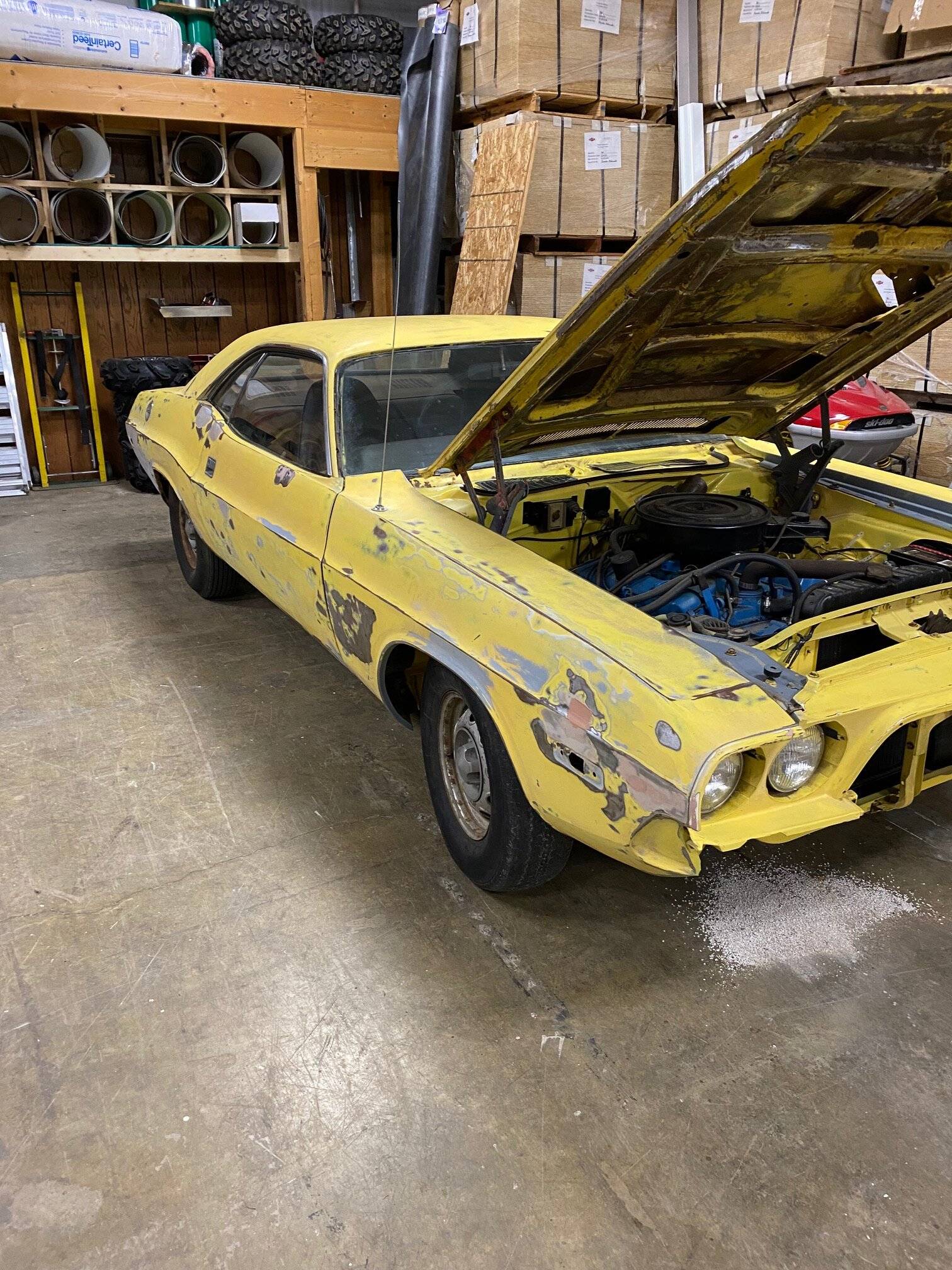

Right now I am just disassembling the entire car, organizing, taking pictures and bagging everything. I found a person to soda blast the entire car and he will epoxy prime the entire thing when done. Then I can start my metal replacement work. It will just be nice to start from new. I was looking at all the grinding, cleaning, priming and it was overwhelming, haha.
In 3-5 years, maybe it will be back on the road.

Haha, sorry for the confusion. In my reading on many different threads, the fender tag was mentioned a lot with information about the car. I am new to these specific cars and have a lot to learn. It is going to be a resto-mod with some things staying original (paint for sure). I am not going high horsepower or anything crazy and will probably keep the 318 with some top end work for some added ponies. I was most interested in information about the car for ordering original parts or finding parts used that will fit the car. It was little things like ordering a new wiring harness - at first I didn't know if I had the rally dash or not. Again, I have a lot to learn. My dad always called it an RT, which is not correct, but it is nice to know the car is in fact a Rally.
This thread definitely sparked way more information than I was expecting to gain, which I really appreciate.
The picture MoparCarGuy posted is spot on and what I remember it looking like when I was a kid.
So, sorry for any confusion. I REALLY appreciate all the great info this sparked. Some pics of where she sits now.
