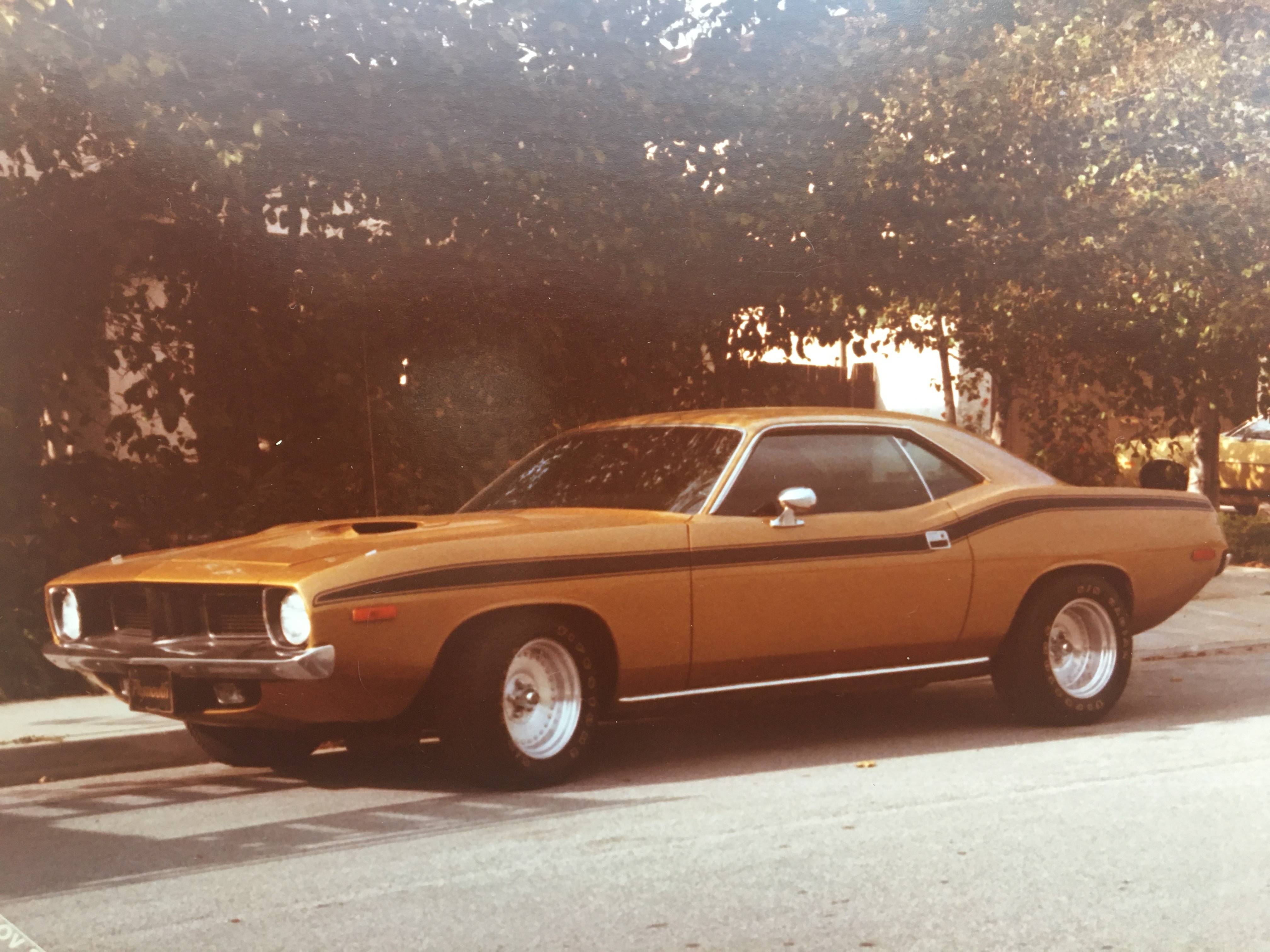

Here was my ride in high school (long gone) and current Mopar.

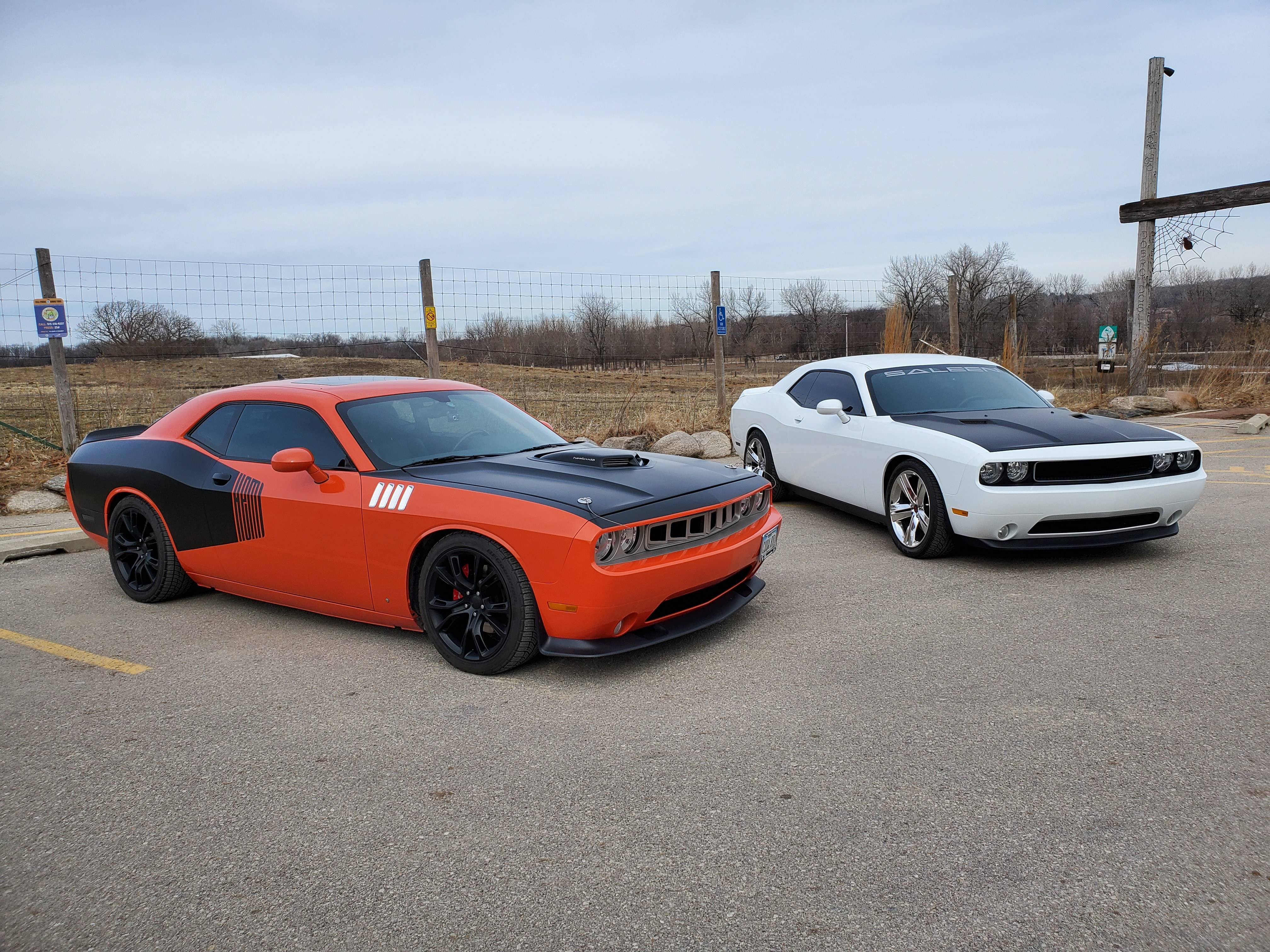

Here's mine, a Dodge dealers charity giveaway car, many Mr Norms parts. I call it a "mod-retro".
The white one is a Saleen Challenger.

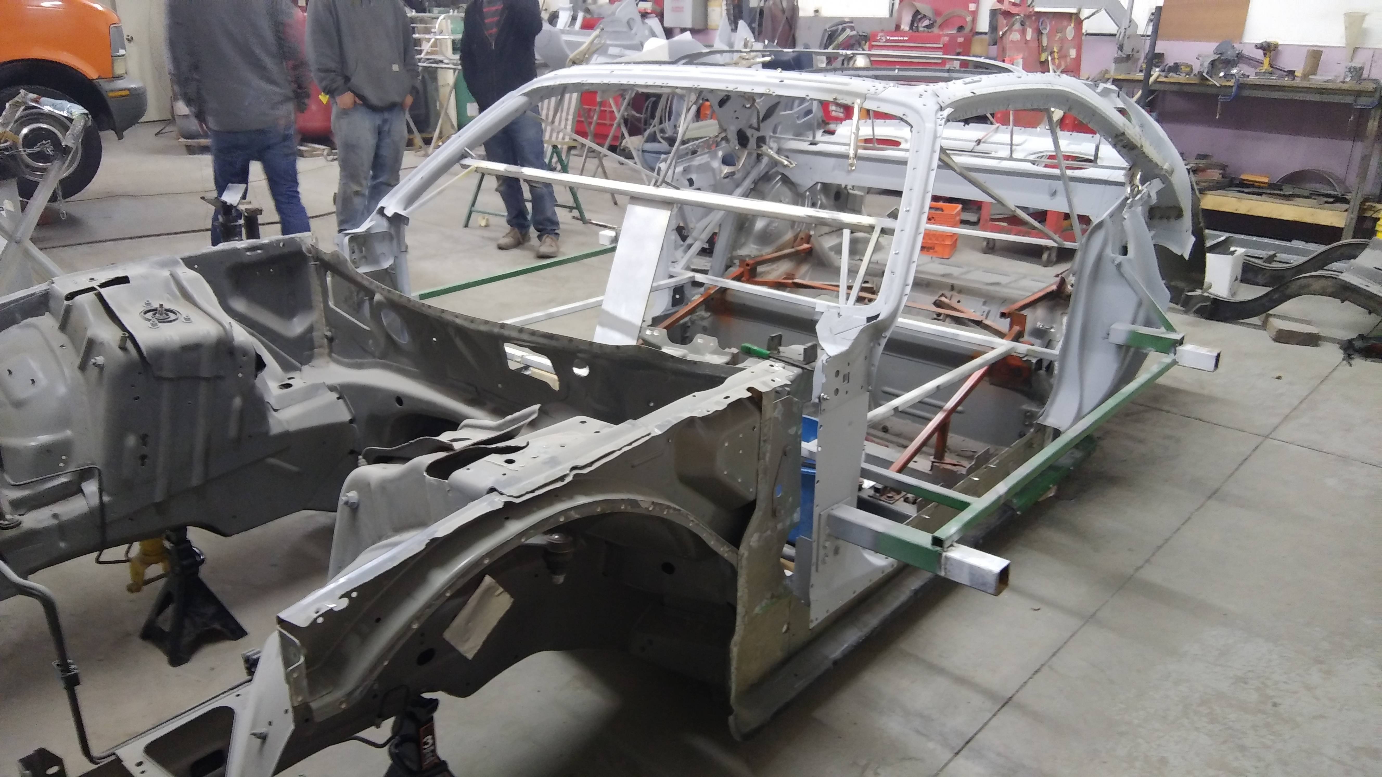

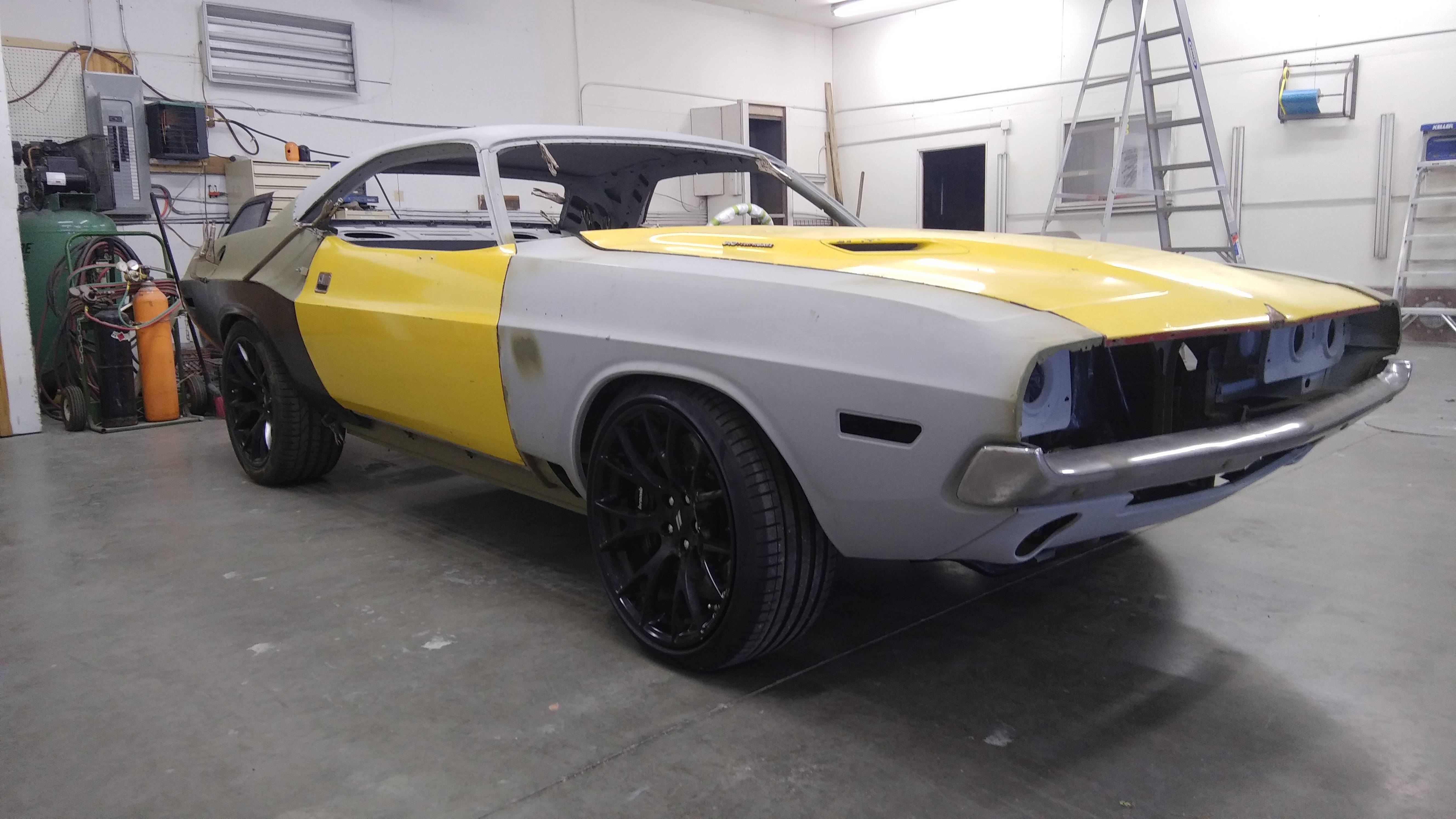

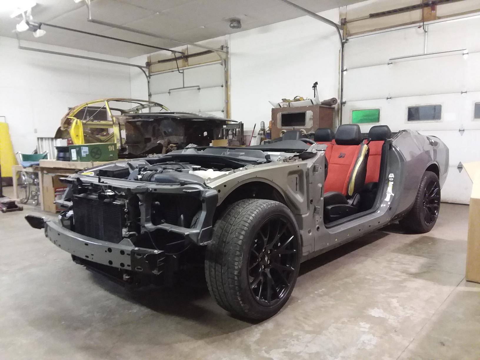

Thanks for the pictures. Do you have a link to a build page? If I am seeing correctly from the images, you have joined the old body (aft of the A pillar) to the new body's firewall/front frame. Can't tell how much new frame or body pan is under the old body. I see all the temporary welded struts to keep the body in alignment. I cannot see how you adjusted (stretched) the 70 body panels to account for the 6" difference in wheel base or the wider track of the newer Challenger.

There are no links to a build page. The 70 body has not been stretched the full 2017 floor pan has been shortened 6 inches. I think the revision of your plan is a practical solution. Initially I had planned to build a typical Restomod. But there were some issues. The end product would not be worth the cost of the build, The original Hemi cars were not recommended by Mopar for street use thou they drove great on the drag strip. The weight imbalance left them with poor handling on the highway. These days there are many options to improve the front suspension but the mods required to the rear axle that improve handling give you a ride that is often back breaking. After buying the donor, I still needed to buy an aftermarket subframe.{ brand new front subframe with Bilsteins staring me in the face} the donor has 15.4 Brembos on the front that will not work with Mustang 2 spindles, and I really wanted to be able to adapt the independent diff. And how was I going to make the 2017 underhood a/c components work with a 50 year old oem a/c unit under the dash? So after some careful measuring I decided to go full tilt, The end result will be a 70 Challenger that appears stock with the exception of Hellcat wheels, 60 more hp. than an original Hemi car with bigger brakes, better suspension, 6 spd. Variable wipers, electric tilt telescopic steering column, tunable exhaust, power seats, backup camera, etc. But if you want to roll down the windows you still have to use a metal crank handle. And it will weigh at least 500 lbs. less than a HELLCAT. Plus the car is 95% off the shelf MOPAR.
