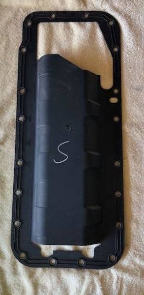

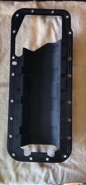

Has anyone tried one of these one piece gasket/windage trays for your big block? Looks kind of slick and would eliminate two leak points. Two gasket surfaces rather than four.
If you tried one, did you use it with the factory oil pan with the long indentations between the bolt holes?
Summit Racing® Molded Gasket Windage Trays SUM-G2339

I have not used one personally but I have heard very good things about it , all of the 3rd gen Hemis use a similar part
We bolted one in on my 383 and the fit was perfect. Haven’t fired it up yet so I can’t say anything about the seal and leak factor. Really cool idea, I think it will work great. It is used with a new Milodon 6 qt. hemi pan.

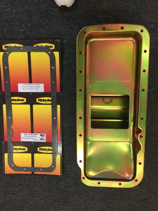

Did you use any sealant or just put it on dry? Does the Milodon pan have the indentations like the factory pans or is it just flat ?

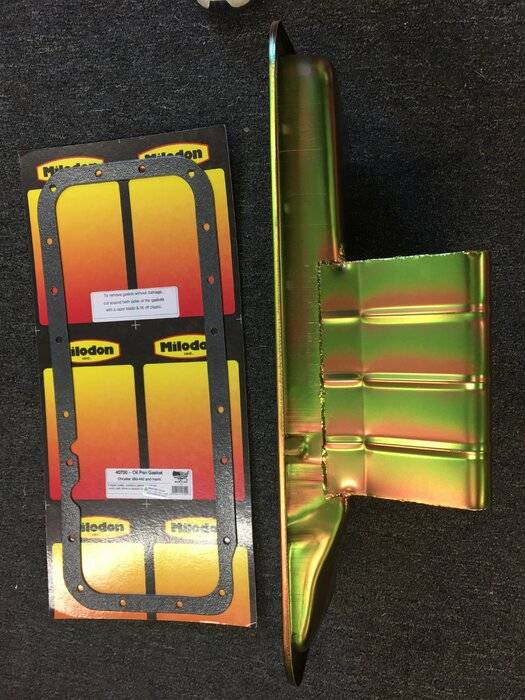

I have a spare 7 quart I took a pic of if it helps. It’s flat. I like the idea of that windage tray. Just makes sense. Didn't see that when I built mine. Using gskt on both sides. Knock on wood no leaks to date.
