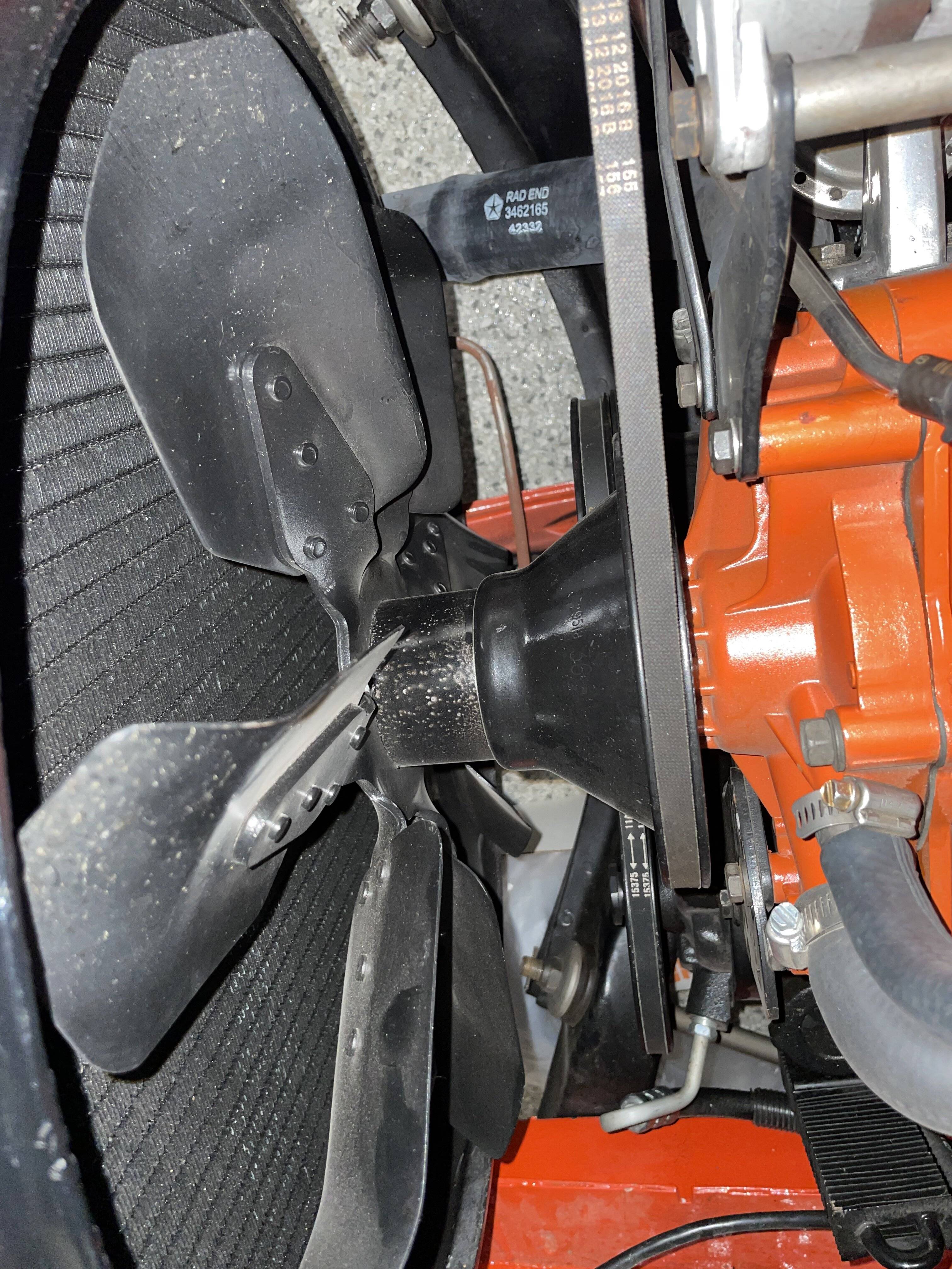

Fan is definitely 7 blade. Coolant is clear and clean and is proper mix. I installed sender for water temp and ran wire. I cannot find a close hot wire for the power. Any thoughts? All of my wires are bundled up in the harness at the base of the column. I’d hate to cut into those. Are there any others that I could splice into? I installed the gauge just past the vent levers toward the passenger side. I noticed that My radio is not hooked up either. Not even a wire run near it.

You may want to double-check that fan. The picture you posted appears to be a 5-blade fan. Below is your picture resized and lightened to see better. Hard to tell for sure from the pic but that large gap area sure looks like the 5-blade fan. That gap allow easier access to install/remove the fan bolts.
I run the 5-blade as that is what was original to my A/C car but with a viscous fan clutch versus direct drive spacer.

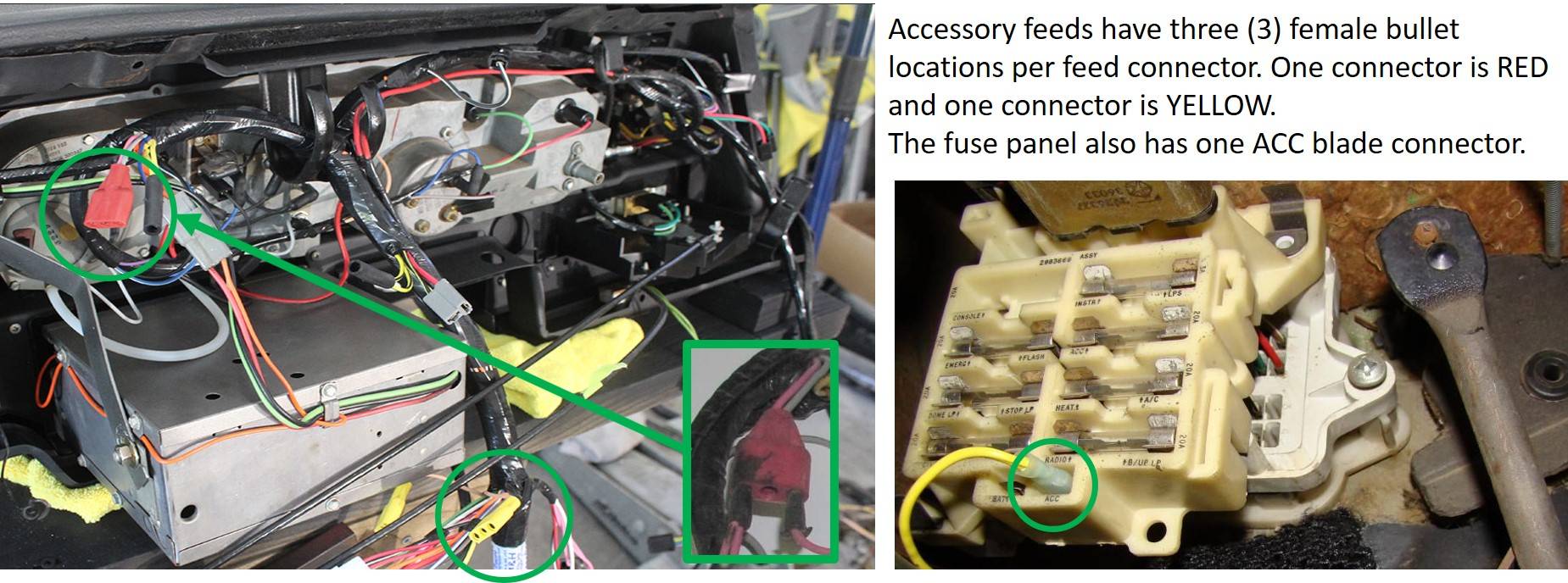

Also, a picture of the fuse panel accessory (ACC) blade terminal plus two other accessory feeds that may work for you.
Double-check each of these to make sure you only have power when the key is in the RUN or ACC position. The RED feed connector may be HOT all of the time from the Battery. If so, do not use it. The YELLOW feed connector should be switched HOT only with the key switch.
It is recommended that you put an inline fuse holder in the feed to the temperature gauge. It may have come with one. Check the gauge directions about fuse size.

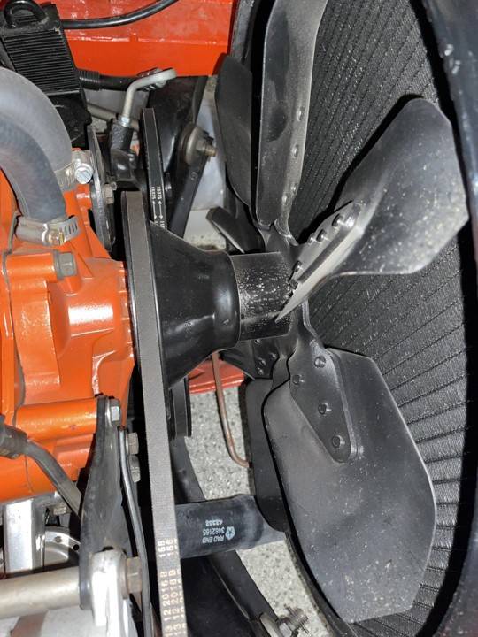

Another angle. Weird that the previous pic looked so much like. 5 blade
Yep, you were right all along. 7-blade fan. You should really be moving a lot of air even at idle. Now we need to see that temperature!

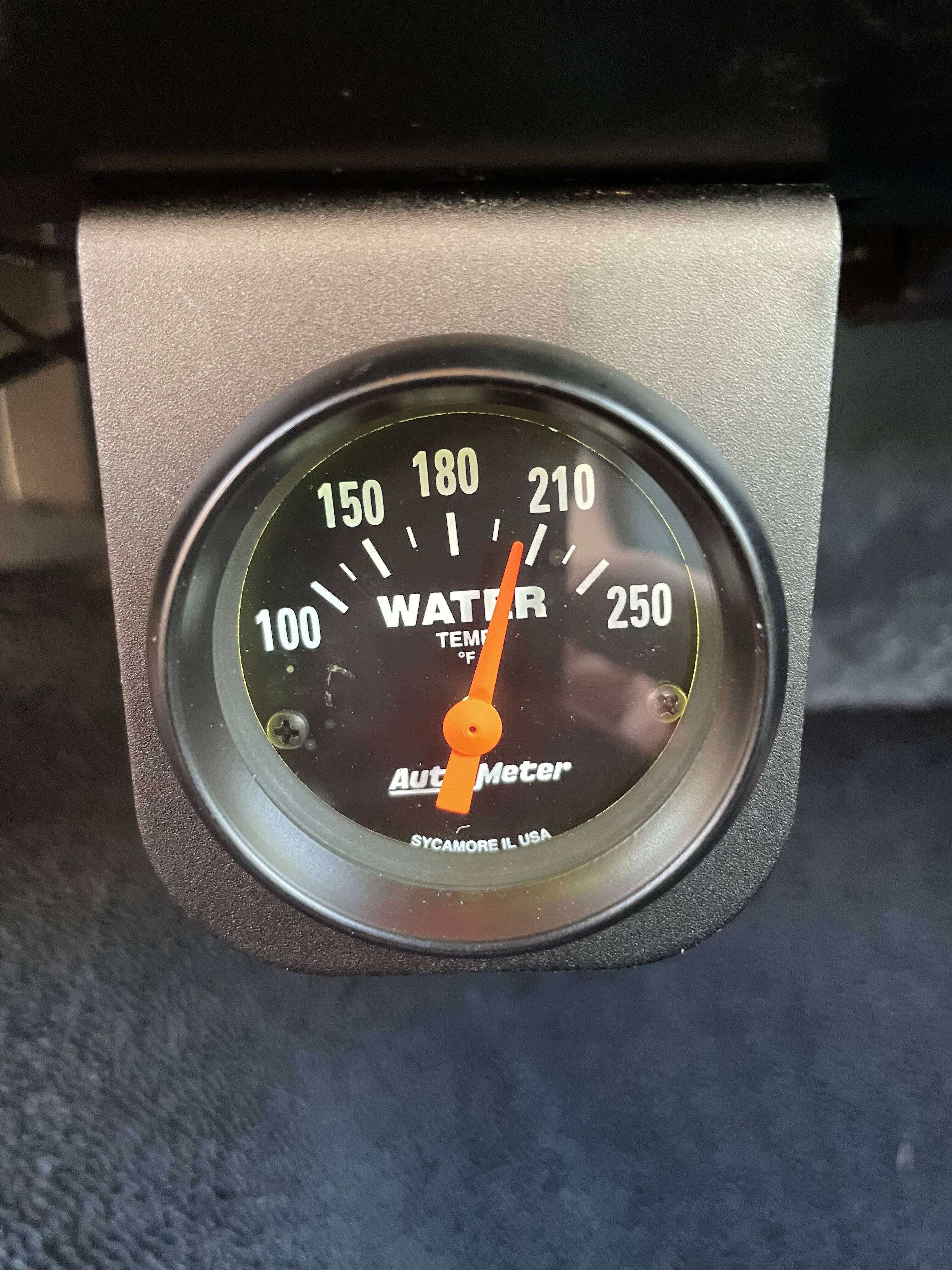

After about a 10-15 minute drive and sitting and idling in 85 degree heat. This is as high as my temp got. Any thoughts, is this too high? Motor only has about 800 miles or so on a rebuild.

That's not bad .depends what thermostat is in it. Should not go any higher unless you are beating it. it should cool back down. There was or is a 5/8" shaft water pump For the L/A motor.Police package.I think I got mine on Amazon? www.amazon.com/Milodon-16350-Performance-Aluminum-Standard/dp/B002XKPDD4/ref=rvi_sccl_2/145-0260724-8687606?pd_rd_w=IlFY8&content-id=amzn1.sym.f5690a4d-f2bb-45d9-9d1b-736fee412437&pf_rd_p=f5690a4d-f2bb-45d9-9d1b-736fee412437&pf_rd_r=BC6YF7JSWJJGSXKR5DCV&pd_rd_wg=WrKpT&pd_rd_r=c16d70e1-1f21-4331-b2ed-c1af3d7d8954&pd_rd_i=B002XKPDD4&psc=1
If it stays there you're golden, you're right around peak thermal efficiency.
