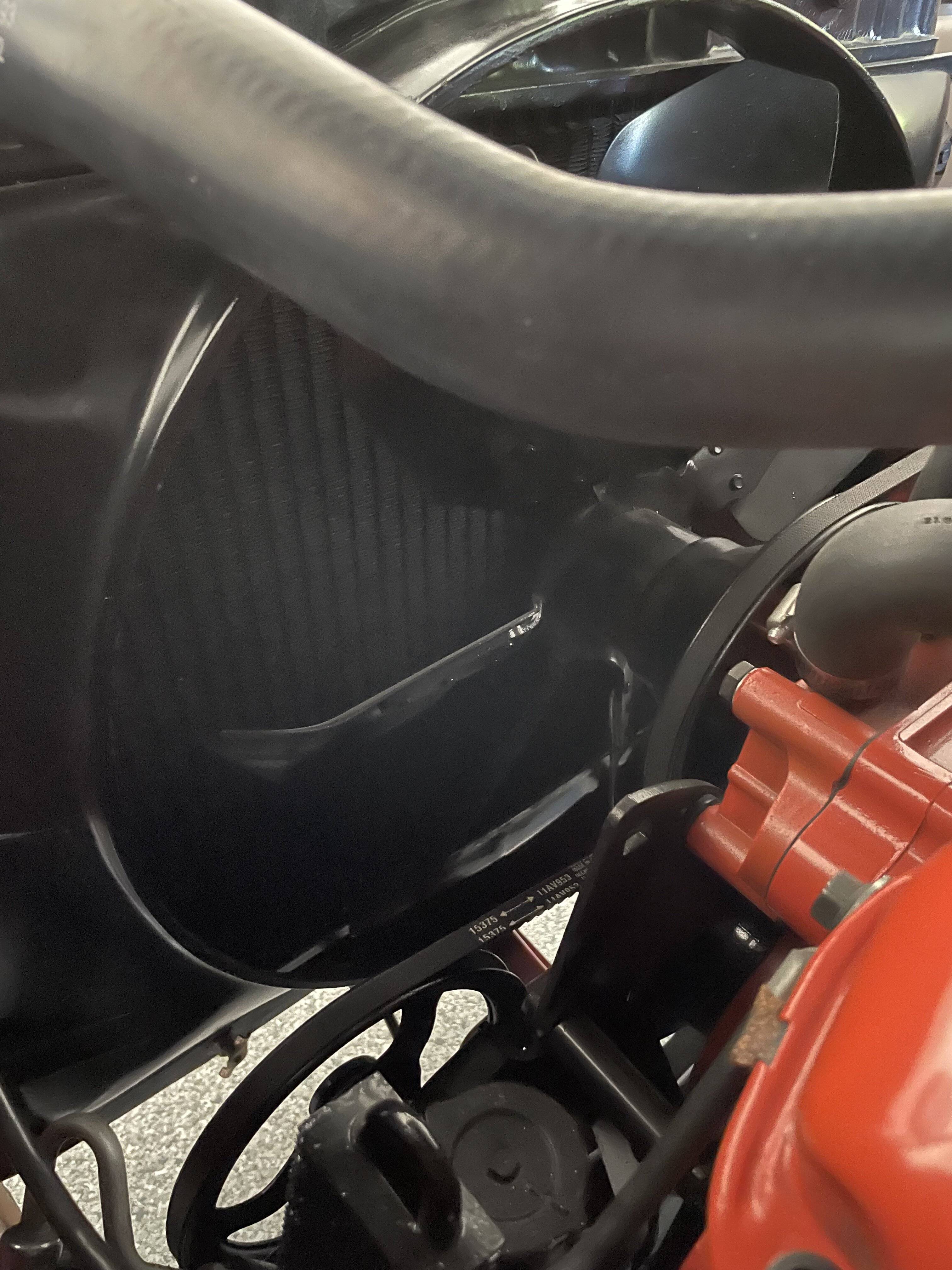

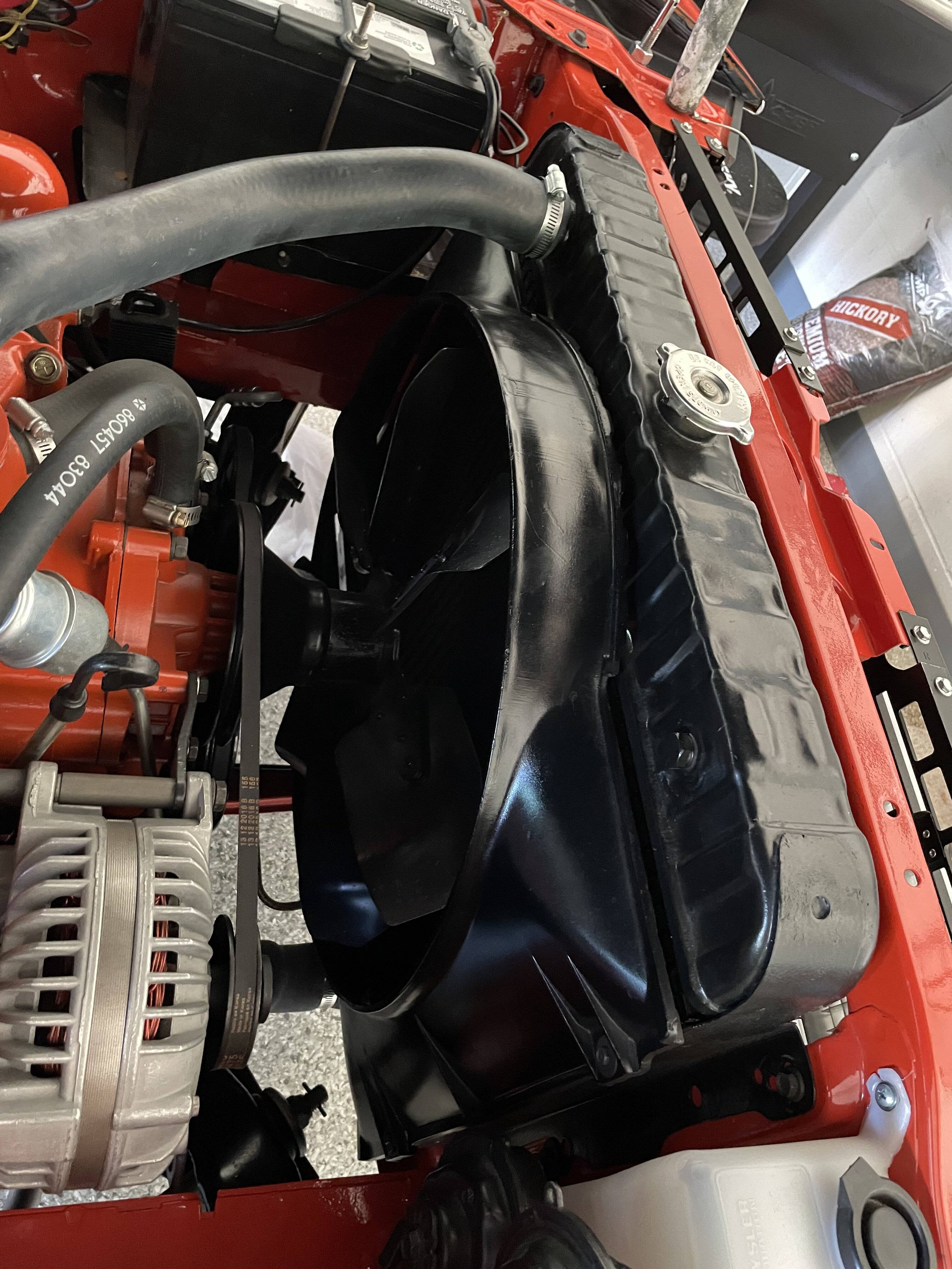

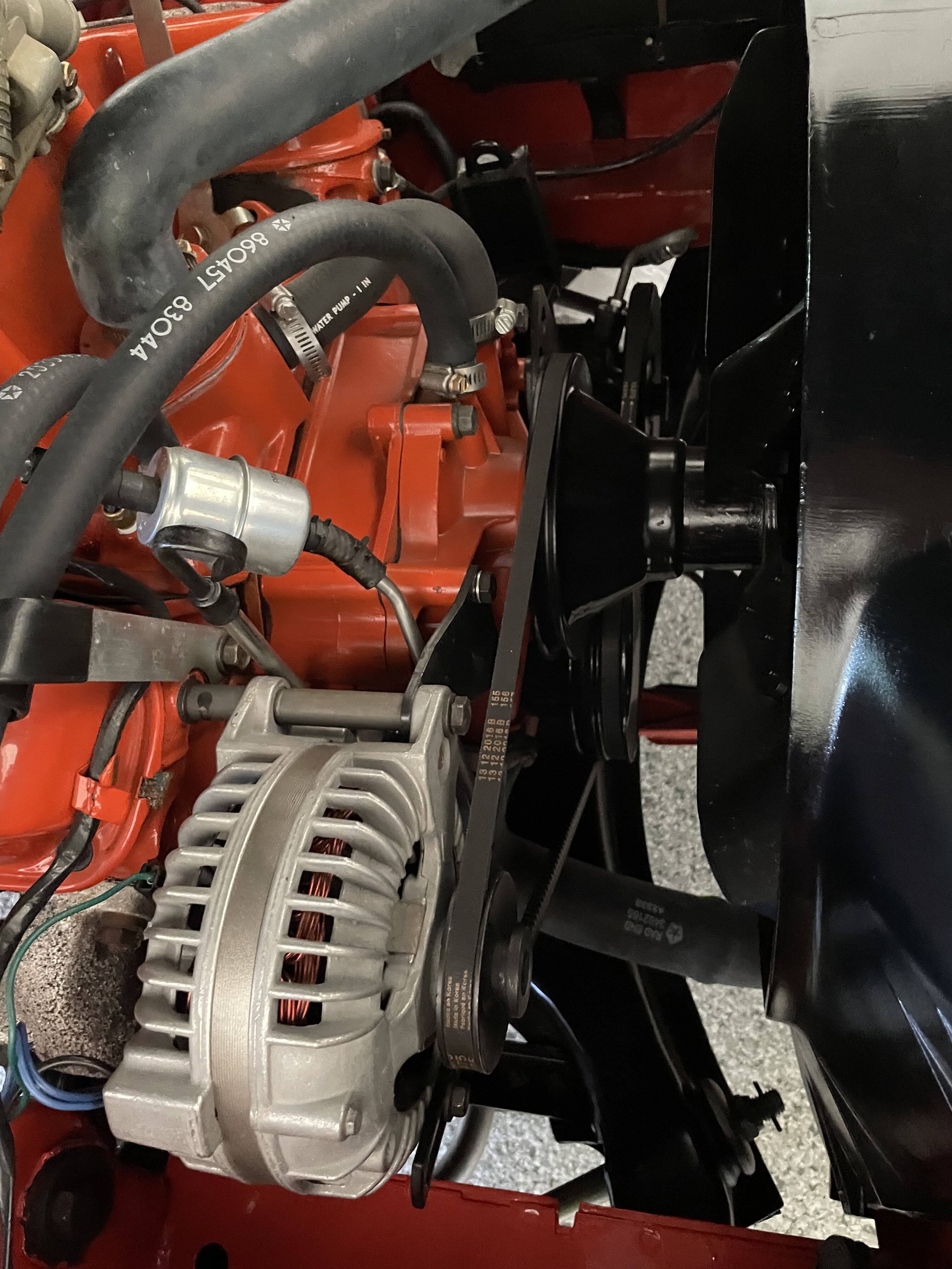

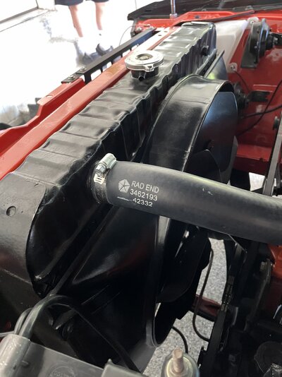

So many things that could be wrong without knowing what exactly you have.
Sounds like you may have a Modine replacement radiator which should not be a problem unless it is blocked or clogged.
A properly set up factory cooling system should have no problem keeping your T/A cool. The 26" radiator was the same radiator used on A/C cars and the largest available in the E-bodies.
Can you post a picture of your current radiator/shroud/fan and the pulleys?

Pics attached

More

Everything appears to be in order. Your pulleys look correct, you have a fan shroud, and the fan to shroud depth is correct.
You may be chasing a non-existent problem. Old V-8s have hot engine compartments and that heat transfers to the firewall, footwells, and trans tunnel. Like others said, you need to know the actual temperature of the coolant before you troubleshoot the cooling system as "running hot". It may be fine. I wouldn't think the temps in Ohio are anywhere near the temps here in Florida.
If you do find it is running a bit warmer, say 215°F or higher, ensure you are running a 180°F thermostat and check the coolant and coolant level. You are running 50/50 antifreeze/distilled water for good heat transfer and corrosion-control, right? The coolant level should be about 1" below the radiator neck.
Also, try running a product called Water Wetter that decreases the surface tension of the coolant for better heat transfer (conduction). This product is proven to aid efficiency and could get you back in the 180-210°F zone.
Post the coolant temps once you find out what they are.
