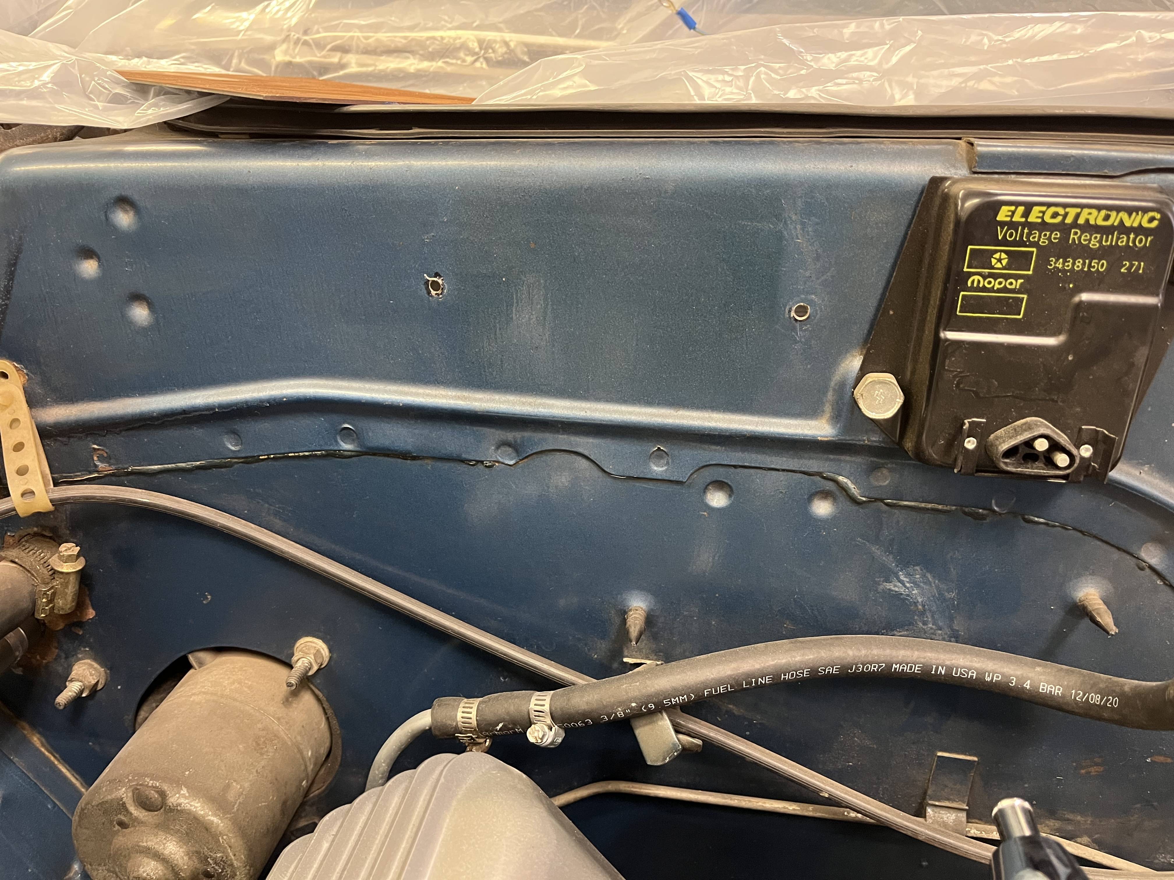

Where and how is everyone mounting their MSD control unit? I’m thinking on the firewall to the left (passenger side) of the voltage regulator would be best however you can only get to 2 of the mounting holes through the cowl. How much room by the pinch weld seem would you be able to drill without hitting the heater box would you have?

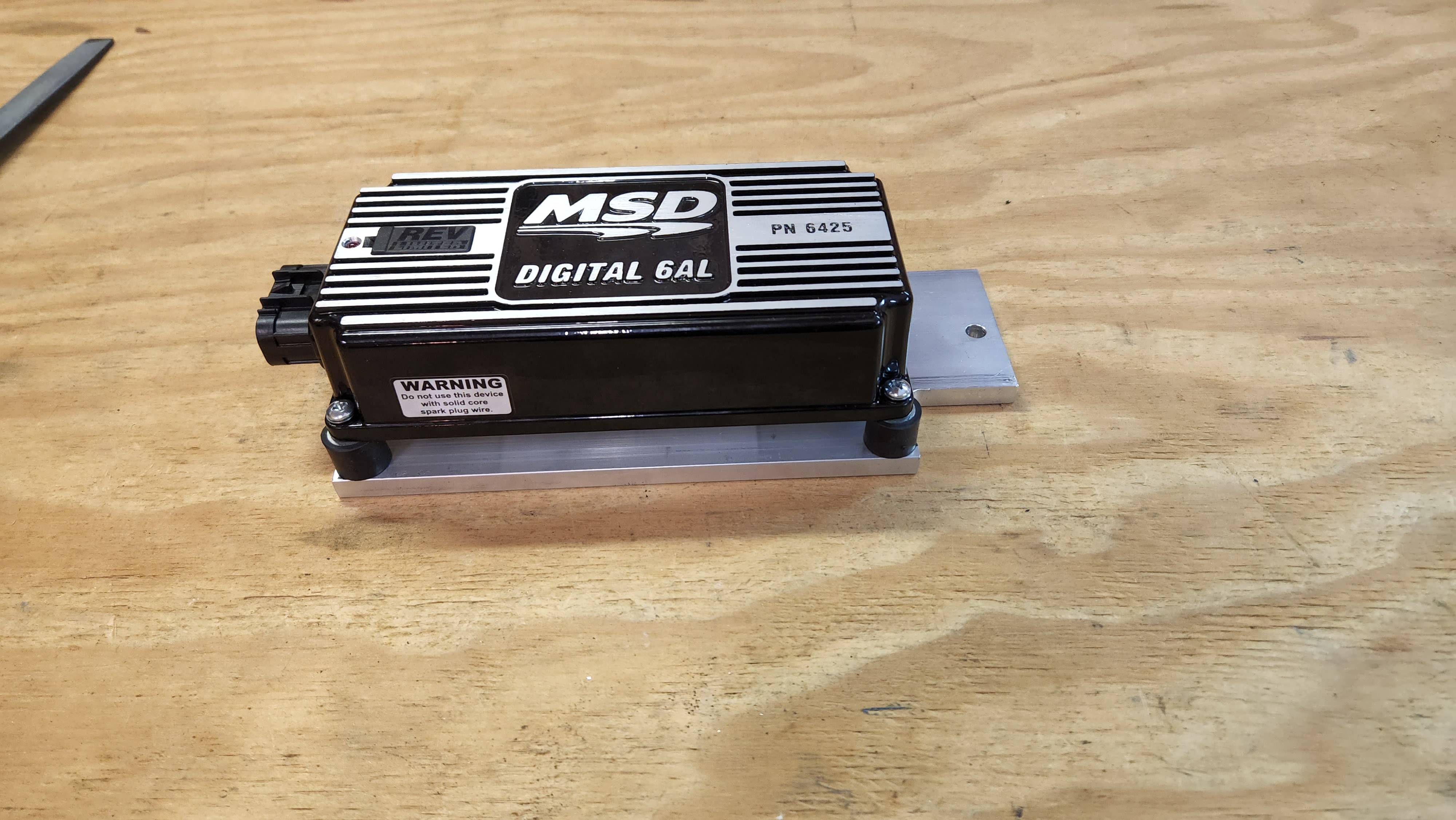

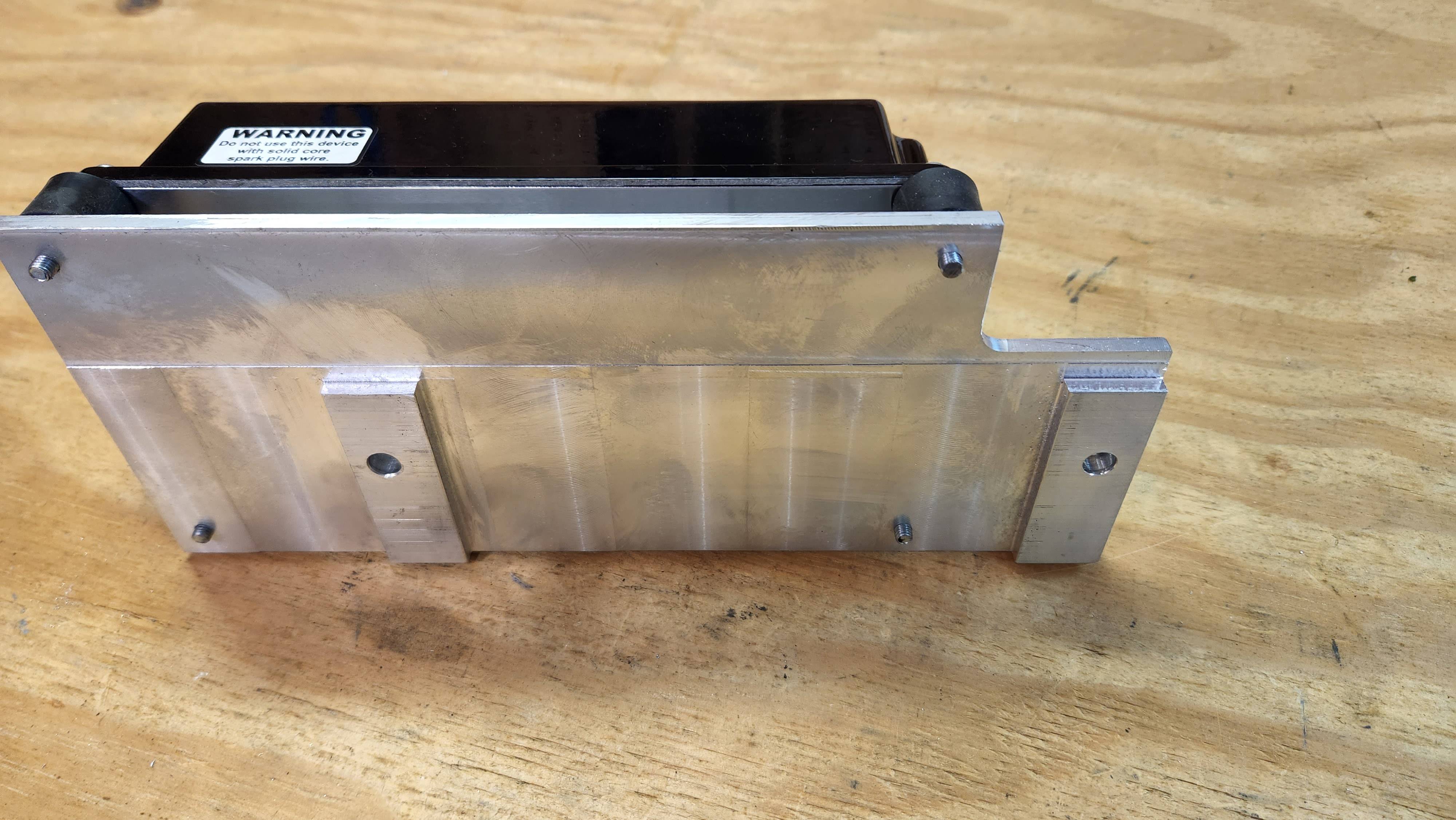

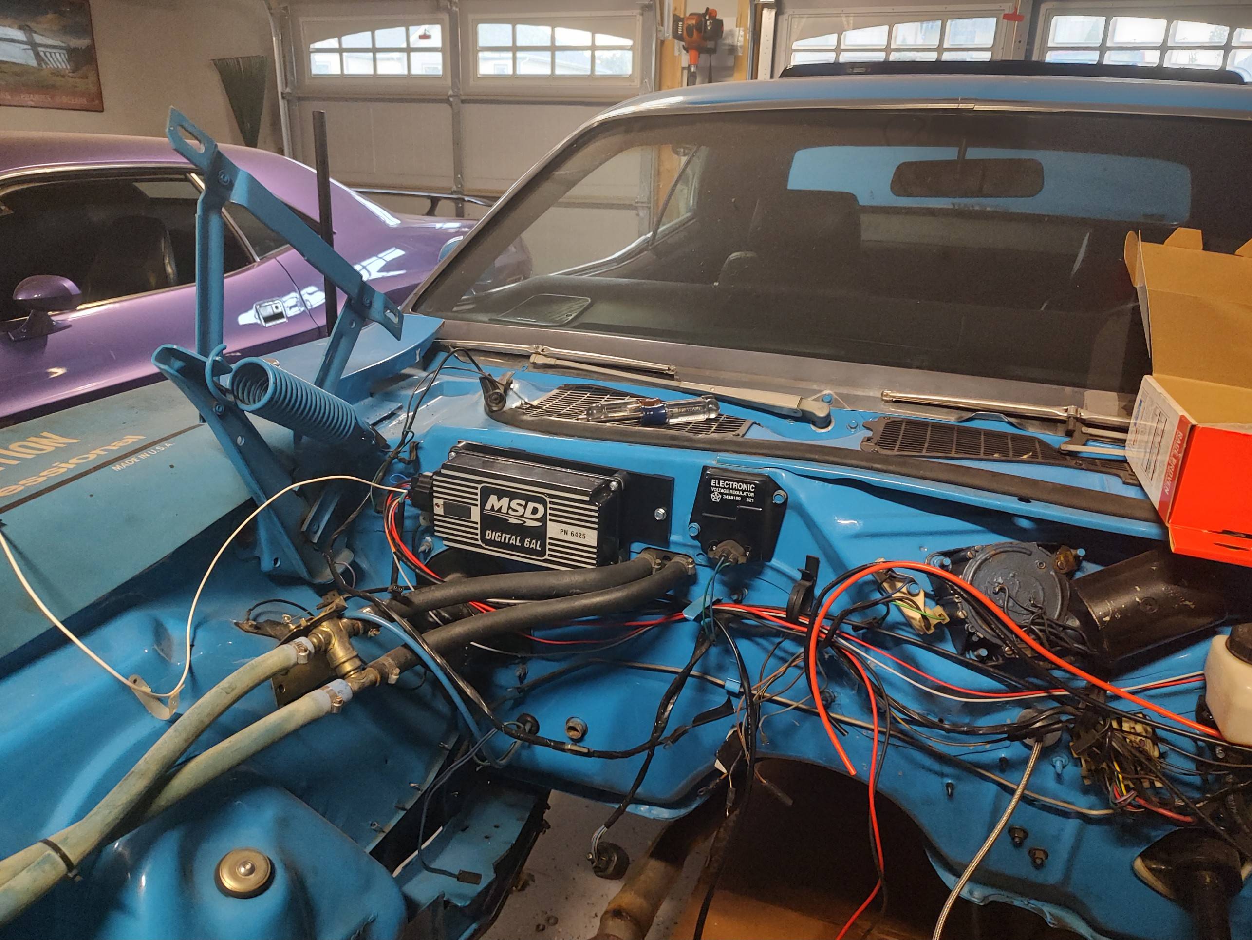

I built a bracket for two of my friends cars to mount an MSD ignition using the factory holes in the firewall for the OEM ignition bracket.
