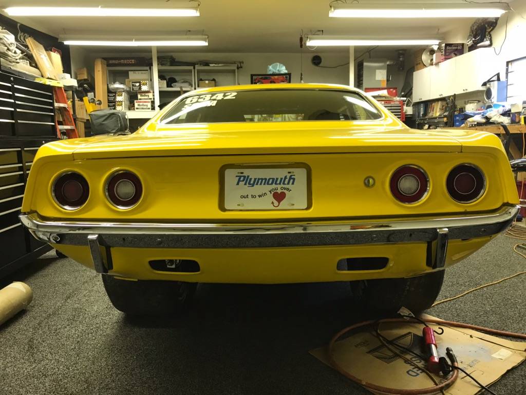

Bought new bumpers and brackets for my 74. Simple, with the right pieces.

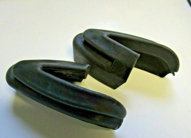

there are some subtle differences between the years for those rubber corner pieces. Early 70s were rubber only and had separate steel brackets that helped support them in place. Late 70-71s had embedded steel and they did away with the bracket. Later than 71 (not sure when) they had a similar rubber with embedded steel but with more rubber/steeper walls. ECS makes the early 70 brackets and I have an extra set to sell as well.

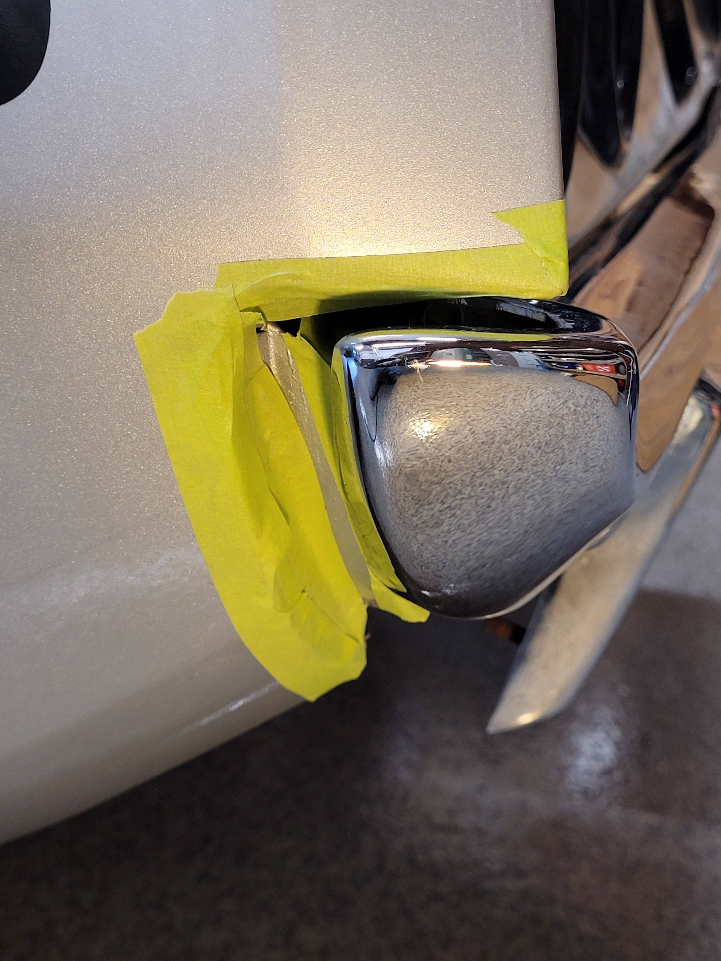

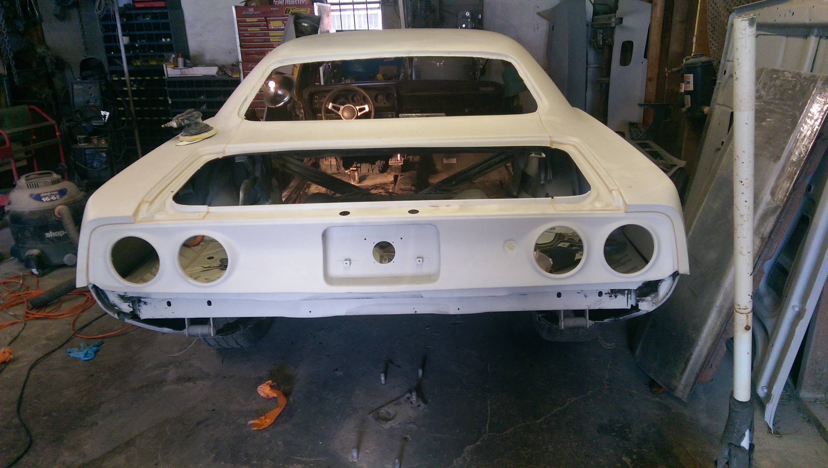

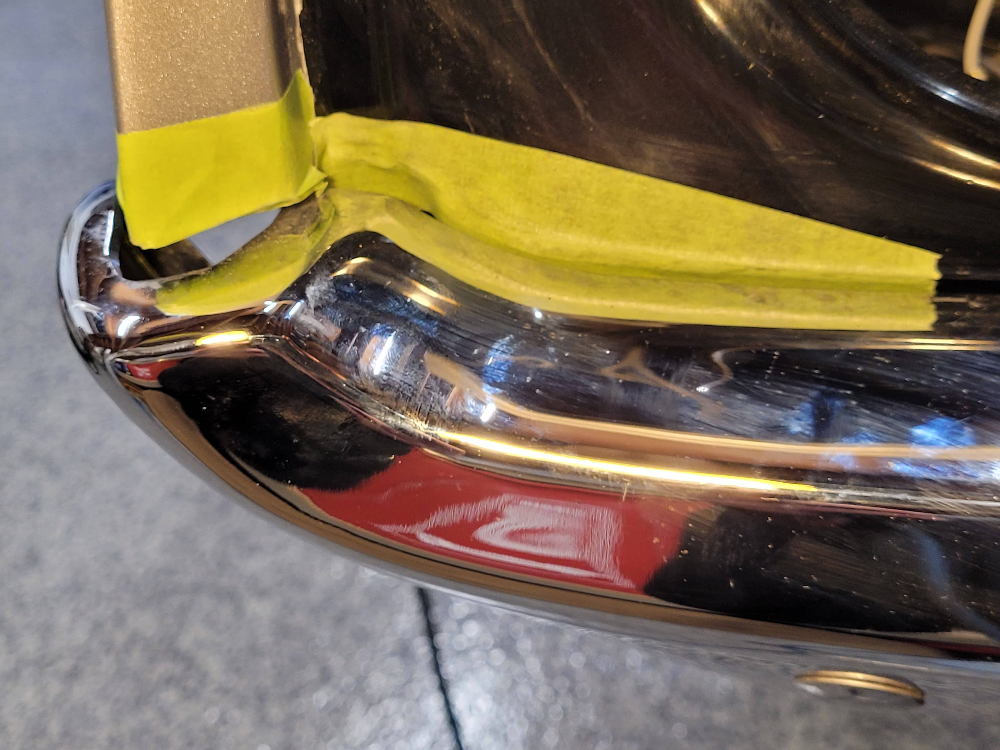

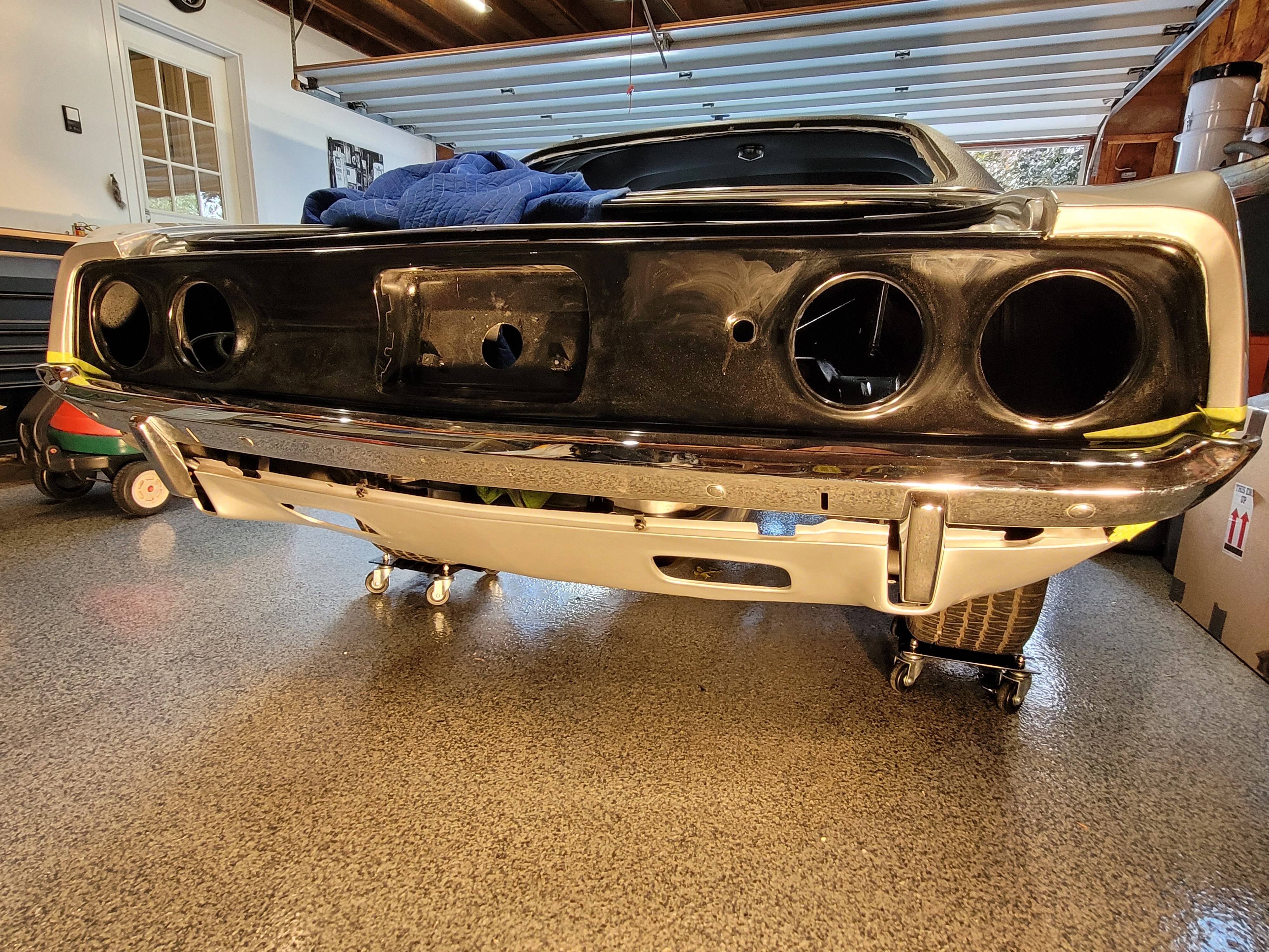

Hey guys, I'm actually in the same process of trying to fit a '72 Rear Bumper w/Jack Slots, using '70-'72 Rear Bumper Brackets, onto my '74 Cuda. I'm having a hell of a time trying to get the Bumper to fit snugly up against the back of the quarter panels and also drop down low enough to close the gap with the Rear Valance. I'm about to try modifying the Brackets to get the Bumper to tuck in properly. The two quarters and the left rear frame rail extension were replaced but it appears like it's sitting correctly across the Rear Cross Member. I'm very curious how "mmissle" managed to make the modification set up work so simply. Based on the included pictures, can anyone tell me what am I doing wrong?
