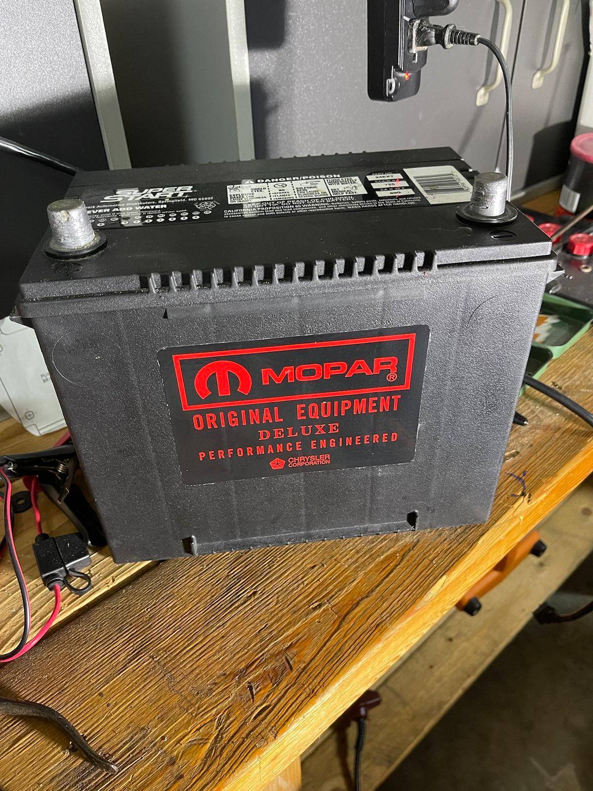

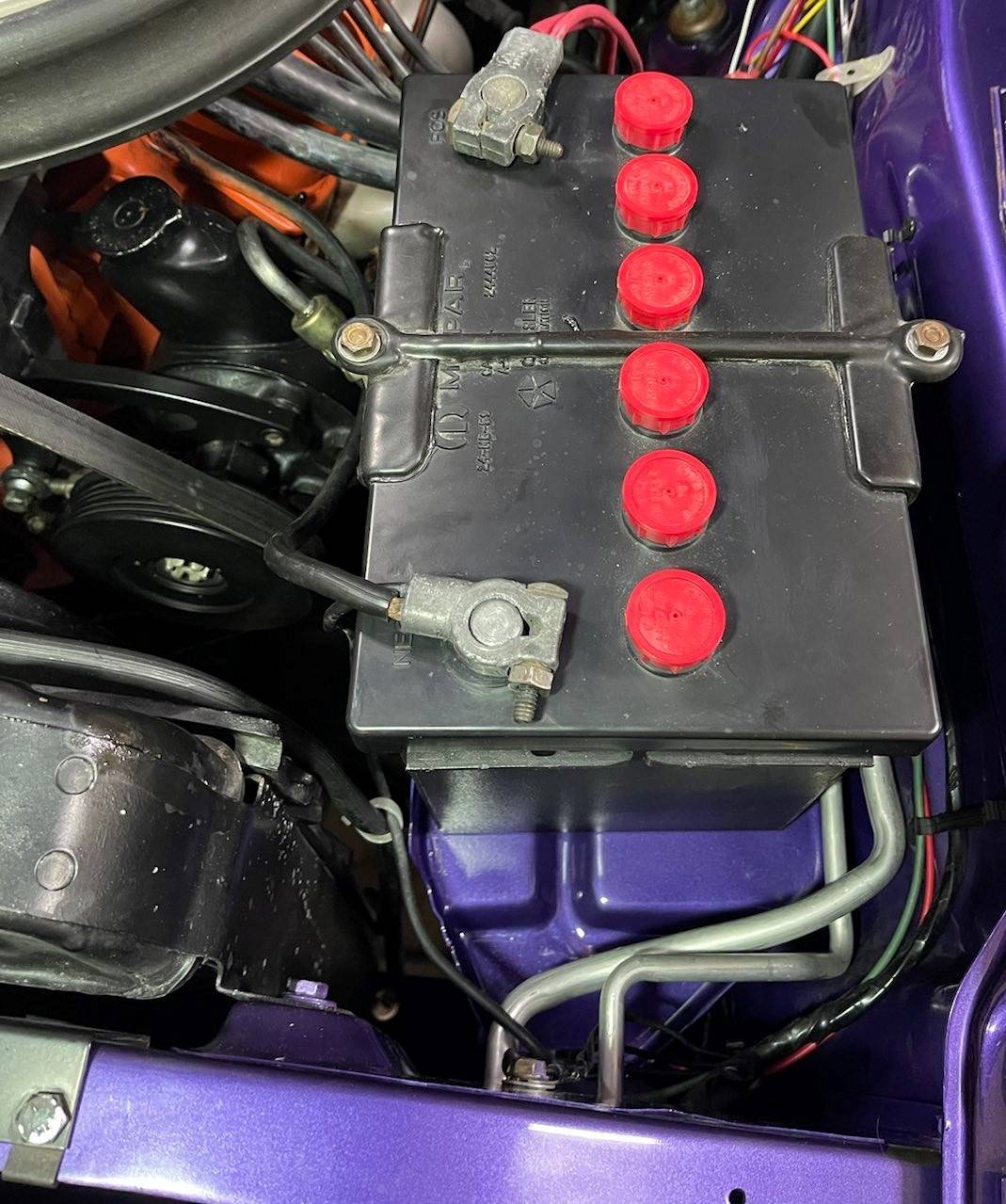

Another option is to buy a plain-looking battery and add a "Battery Topper" which looks like the top of an original Mopar battery with the appropriate yellow/green/red battery caps. The toppers are still available and that is what I run on a SuperStart battery which is manufactured by East Penn. I also added an incorrect but cool Mopar decal to the side of the battery that fools most people (see pics).

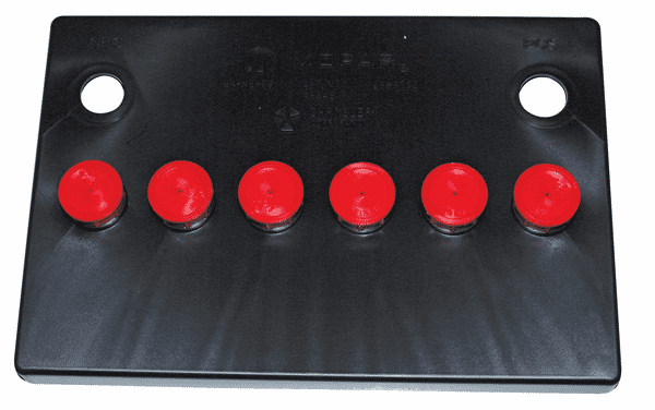

There are also kits available to add only the plastic battery caps to a plain battery that has the six standard battery cap holes but that can be more difficult to get right and will not have the Mopar raised lettering on the battery top.
