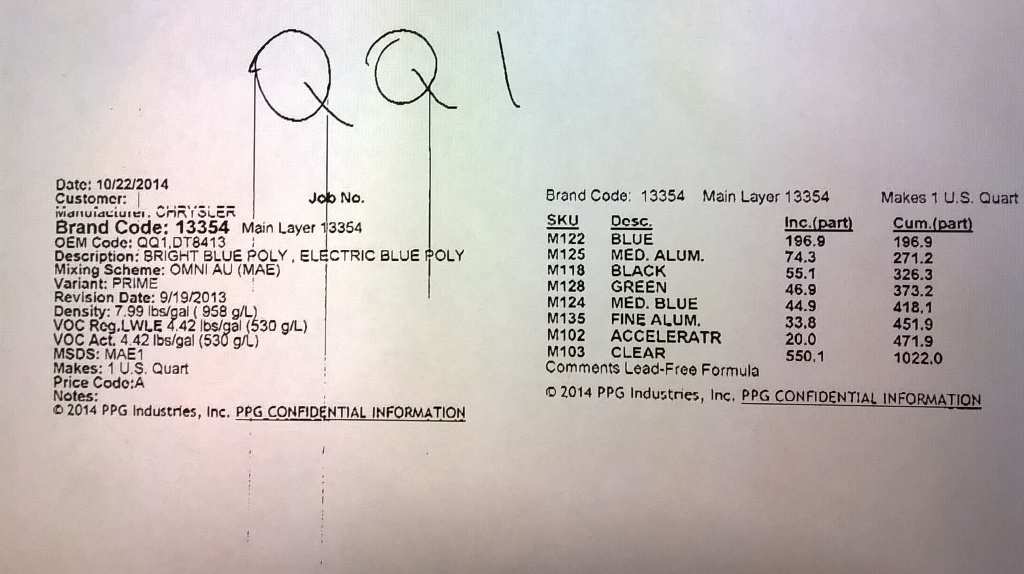

B5 Bright blue metallic 1970 Challenger

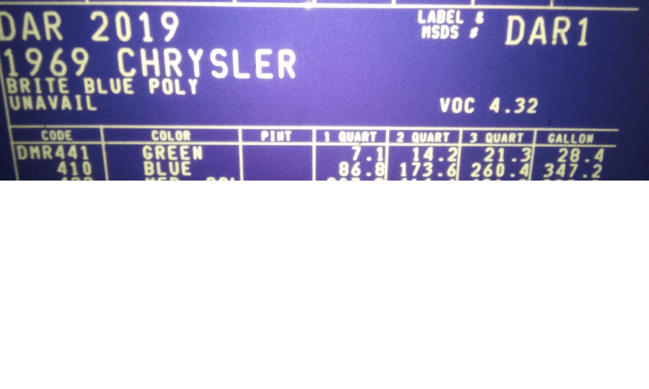

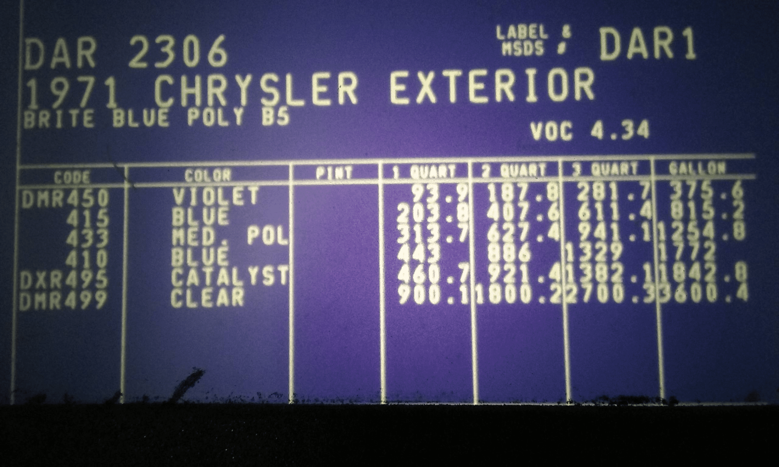

B5 is different from 70 2019 to 71 2306, be sure what you are asking for.
I see B7 on the can that is different too!? That's why they designate letters withe the code. PAINT 1971 DAR Acrylic Enamel
