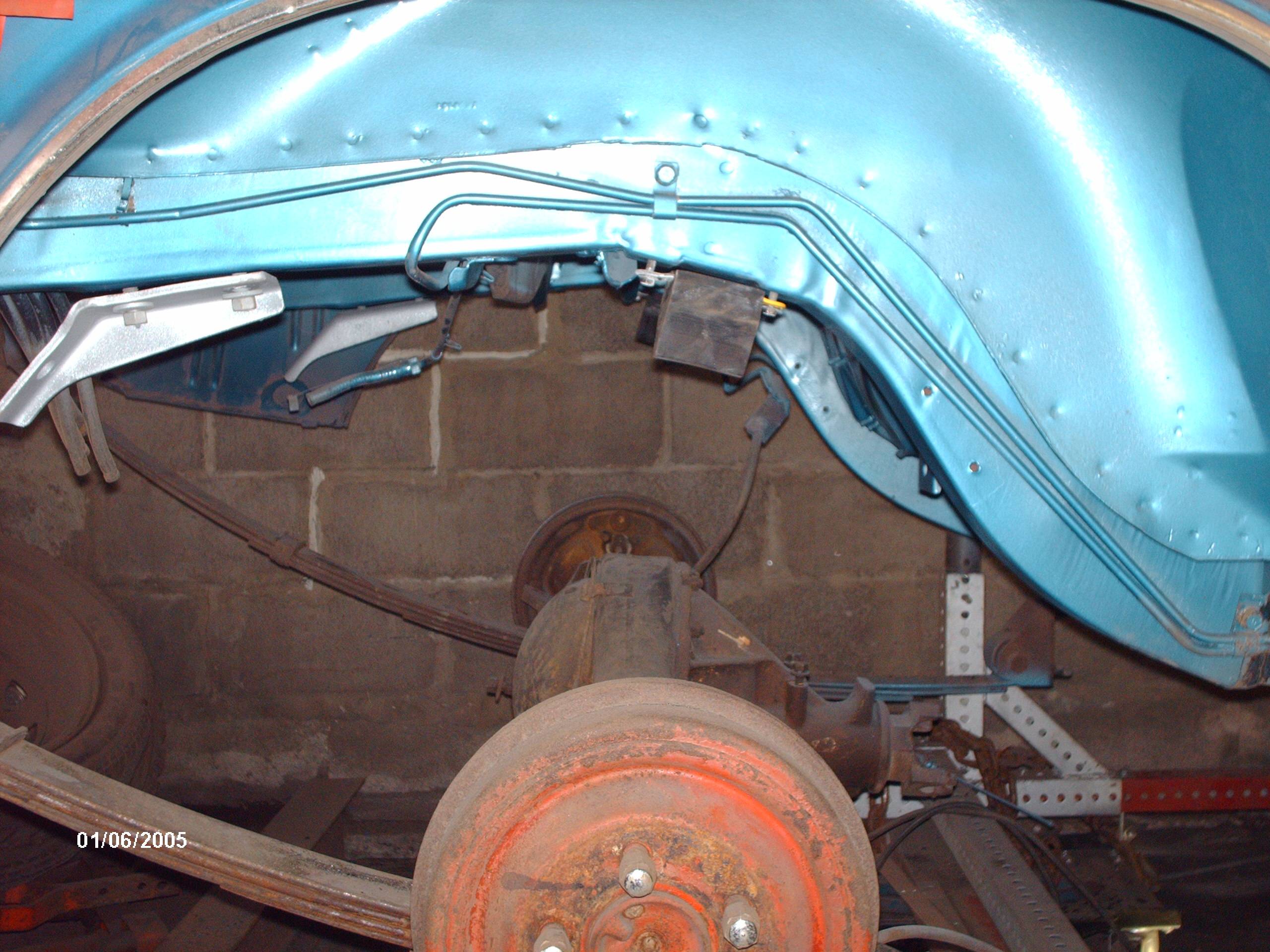

Check to see if the ground strap is connected good or even there.
