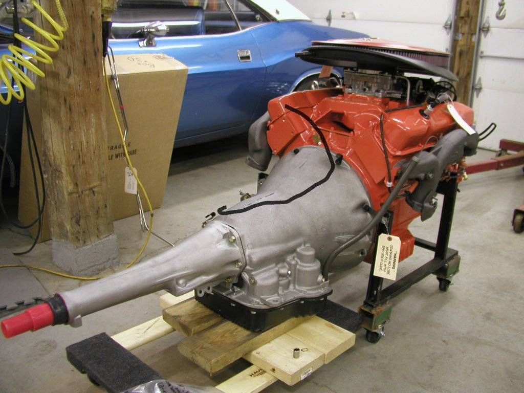

My question is how is the wiring routed from the bulkhead to the switch? Does it go over to the passenger side and loop back over the top of the trans? I have a long harness with a short distance and I don't remember from when I took it apart.

Matt, I agree with 71Plym, I think it goes towards the passenger side first then back over the top to the drivers side. There are a couple of wire harness clips that it goes into IIRC, one on pass side top of bellhousing and the other on the drivers side lower part of the case near the NSS. Here's a photo of how I 'think' it goes with a hand drawn black cable in the general area. You can see the clips on the trans. I believe it was routed this way to keep the cable away from the exhaust??

it will attach to the fire wall tabs over to where the regulator is mounted then drops down the tunnel there should be another tab where the extension housing bolts on & over to the NSS
