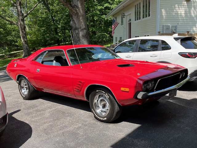

Hey there. I am a new member to this site. I have a 1973 340 Challenger I bought in 1985. Luckily I never got rid of it because i LOVE this car!!. I restored it back then and won a few trophies. Getting married and having kids put it on the back burner and it sat for years. I had lost the mojo at that time. I got it running last year, gave it a bath, put it back on the road, and now just going drive it. It still looks good from far but needs work.
I will be asking questions for help. The engine pings upon acceleration which i have to work on and i have to get the gauges working which makes me scratch my head.
Anyway I look forward to chatting and thanks!!

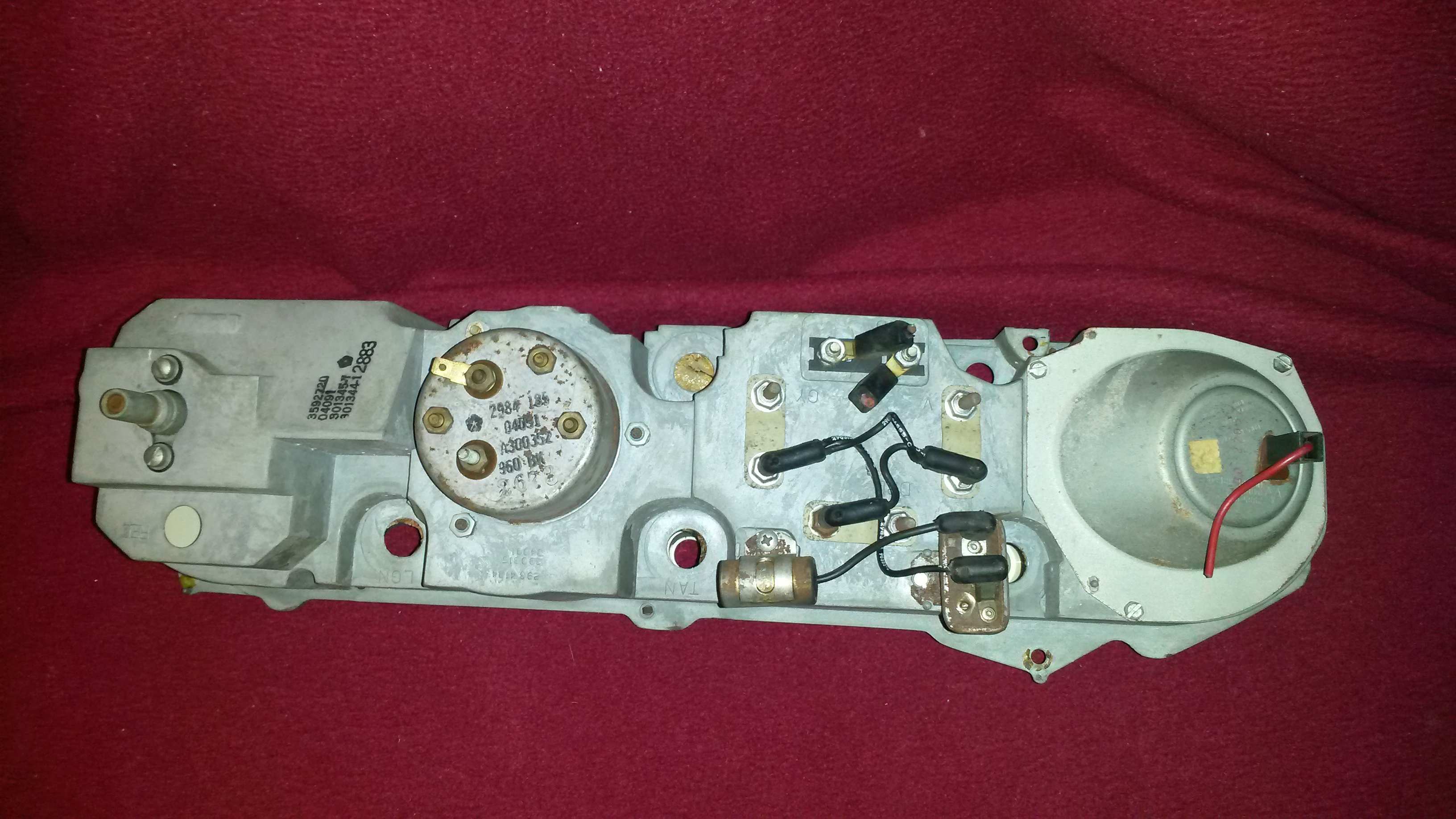

You need better fuel or a modified timing curve for the pinging .
The gauges have a voltage regulator to limit to 5V if the Reg fails the gauges will not owrk , the reg is inserted in the rear of the gauges .

I agree with Chryco Psycho about the limiter. Just recently had dash light issues and removed the cluster. Found the connections had rust and also all the gauge studs. Cleaned them up and put dielectric grease on all connections. solved a the problems. Take a look. Dash lights a Brighter possibility
This is a cluster that has been in clean and dry storage and it still rust.

For pinging, it's usually a timing issue and you need more advance. The 5 volt regulator fails in the open position so the poor Gauges get 12 volts and they're toast. Maybe you'll get lucky and the gauges are OK and the regulator needs replacing!
