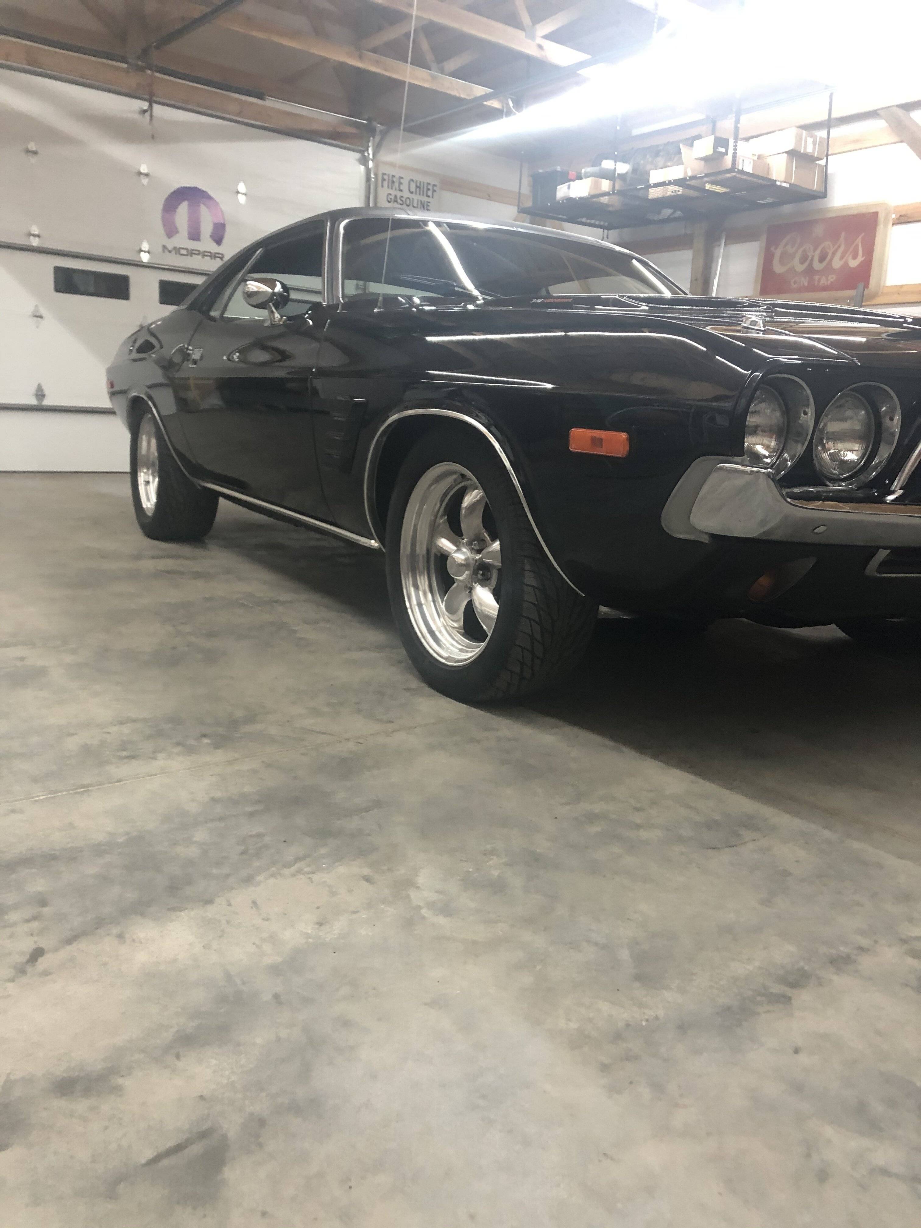

Good day all, I have a 1973 challenger rallye that currently has 17” American racing wheels with air shocks, I want to go back to rally wheels with staggered wheels and some lift in rear, currently looking at 15x 8 w/ 4 5/8 backspace. My question, does anyone have this setup? How wide of tire will fit on rear without rub? 1st picture; what I have 2nd what I’m goin for thanks in advance

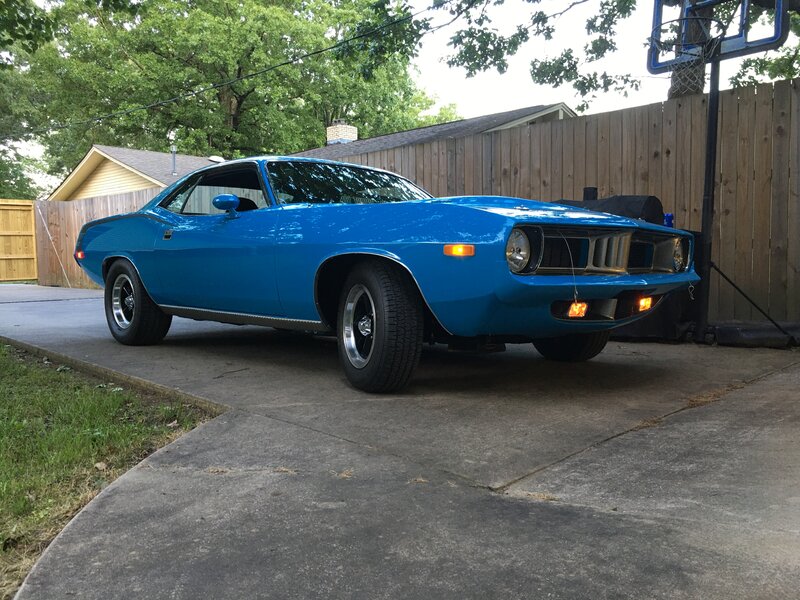

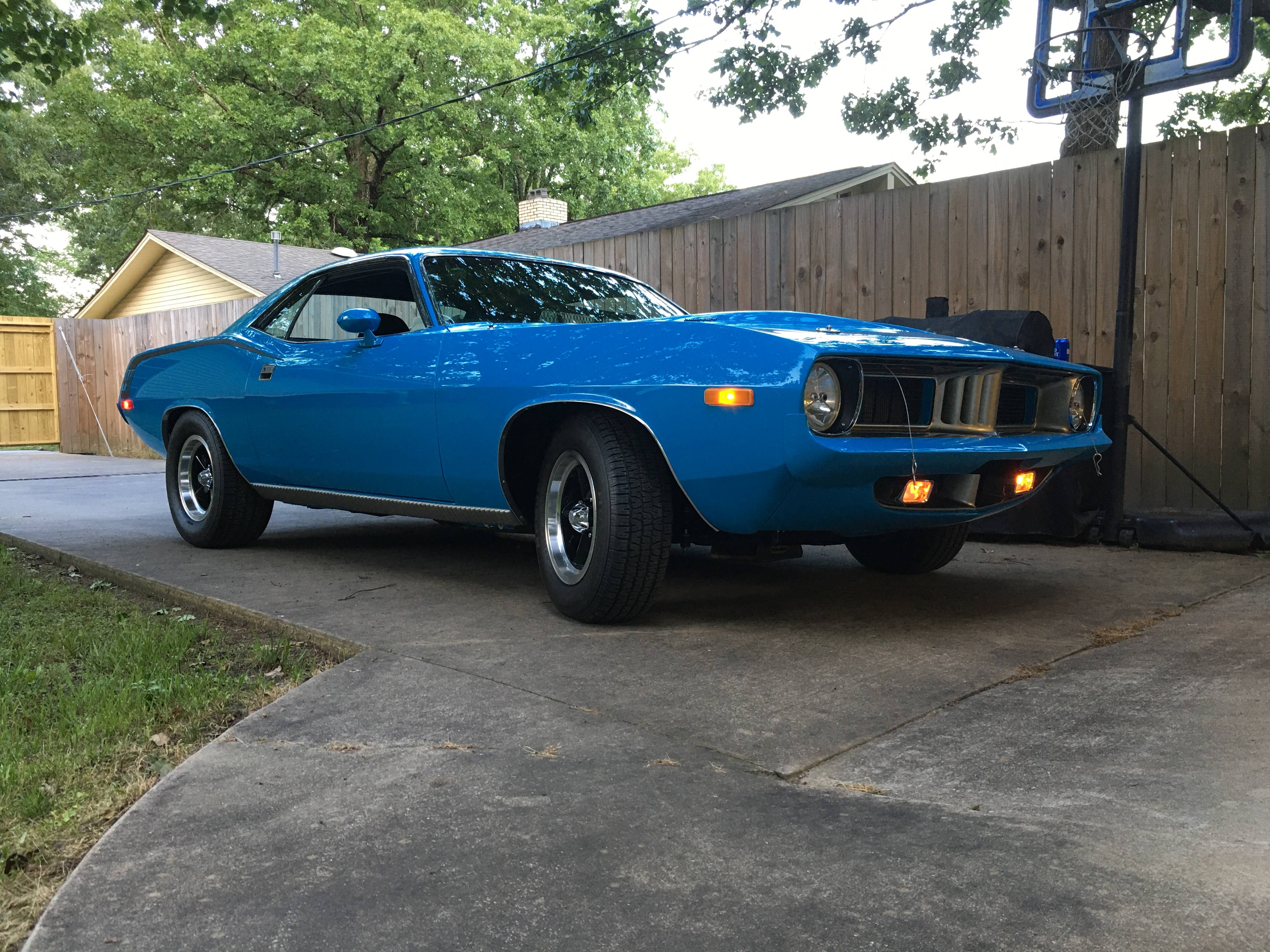

Welcome to the site from Arkansas. As Leo says, the rear leaf springs are the way. I’m using 15x8 rear and 15x7 front. 275/60 rear and 215/70 front. The 275/60’s are tight but do not rub.
Fasjac that’s a great looking car & thanks for the input, that gives me a great starting point, I did kick around a narrower front rim, now you just help confirm!
