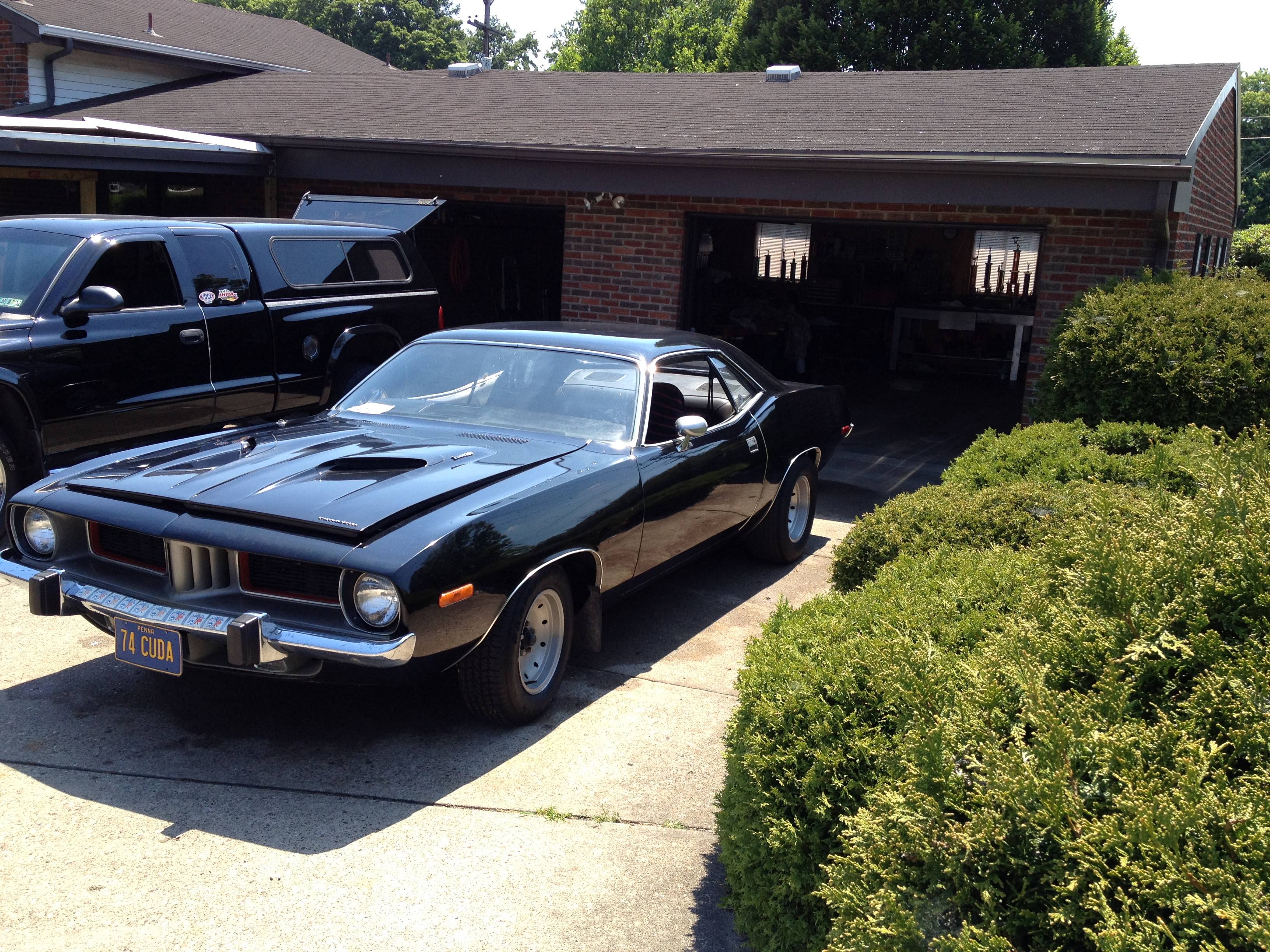

I was hoping to keep the car all original except for little stuff like hoses, clamps, distributer cap, and of course wheels and tires. But I can be happy with more horses under the hood, too.
I will have to figure out a new exhaust system. I am thinking of using factory 1971 340 exhaust manifolds instead of headers.
Welcome from Pittsburgh too.

My car sat many years in my parents garage in Dormont. I finally moved it to our house in Brookline. Then we moved to Finleyville to get outta the city and closer to work. I finally have time and a nice garage to work in. So... when I did start getting serious with it, it didn't wanna run. I had to fill the carb to drive it in and out of the garage. I figured fuel pump. Nope, fuel line. I hooked my compressor to the line and blew back to the tank, no flow at 80 psi. I took off the rubber line from the tank to fuel line and it was completely blocked.
Also... We have an attached garage so when I drained the old gas the smell made it into the house and my wife had a **** fit. So........... don't do that !!!
