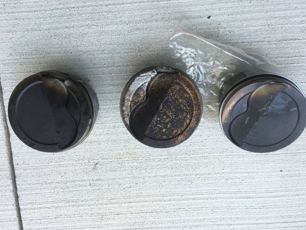

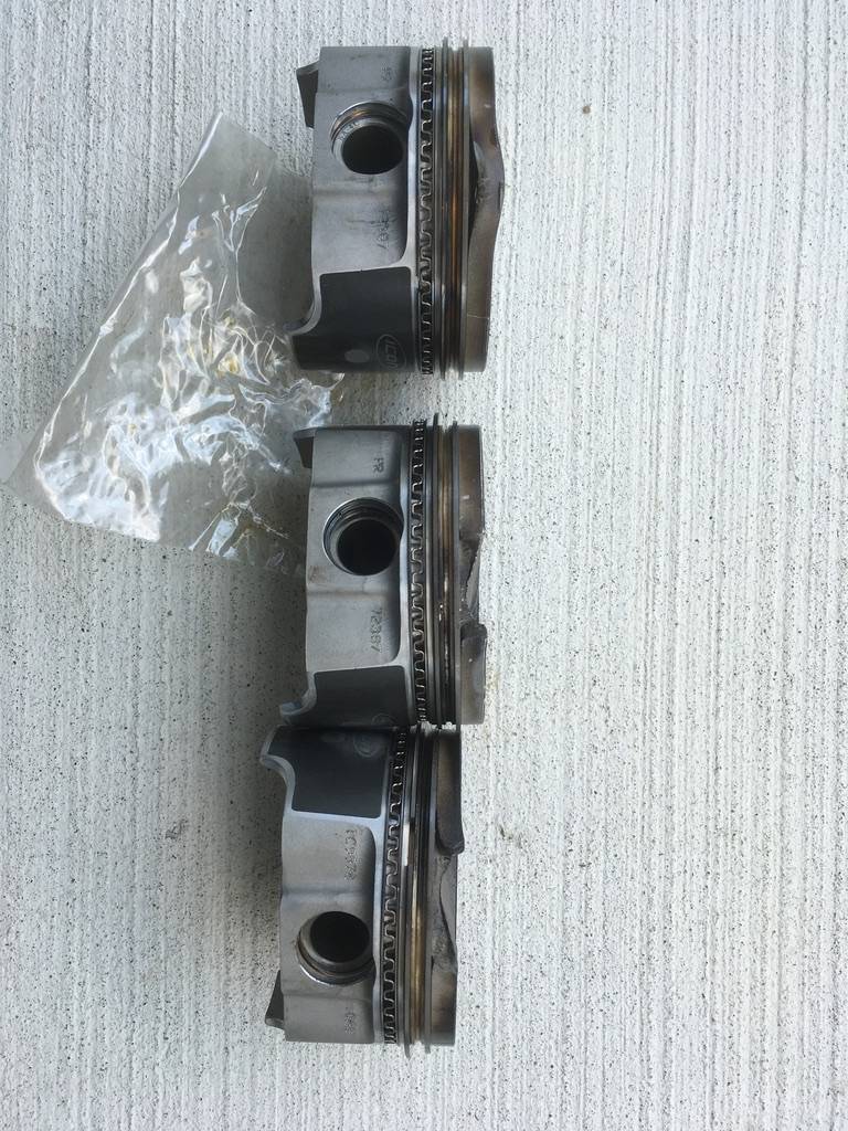

We pulled the head and found 2 burned pistons (6 and 8), apparently caused by car running too lean at WOT.
It seems that the stock fuel line (5/16) even with edelbrock mech pump and thermo quad 800 com carb was unable to deliver enough fuel. The builder and I discussed this a while back as possible cause for performance at the tail end of the 1/4. The plan at this point is to replace the pistons, check the other side for any damage, then run additional pump from tank probably with larger (3/8) fuel line. Would one normally increase fuel delivery capability when going from a stock 360 at 8:4 compression to a 415 stroker at 10.25? The guys that built this engine have a lot of experience (mainly with Chevy engines); the car was to be mainly a street car with a lot of torque but to be occasionally run at the track in the 1/4.

I could totally be wrong here but that seems like a weak explanation. I would think that a lean condition would be caused by improper jetting rather than a fuel line that’s too small.
I have always heard that when properly jetted, the cylinders on the four corners, farthest from the carb tend to be a little leaner because of the extra distance traveled and I’ve seen this on heads Ive pulled. If the other head is removed and the damage consistent in cylinders 5 and 7, I might suspect that the secondary jets were too small creating a lean condition on all cylinders in the back Under WOT.
Thinking outloud here, I would guess that if the carb was jetted properly but the small fuel line the real problem, wouldn’t the piston damage be most apparent and fairly consistent in cylinders 1,2,7 &8?
Going to a 3/8” line is a good idea for your motors needs though but I’m skeptical about the smaller line being the source of the problem.

Bent spark plug electrodes were from melted pistons. Engine builder concluded car was running too lean at WOT; which explains it laying down at end of 1/4. Fuel line and sending unit have been upgraded to 3/8" from 5/16". Engine has been rebuilt with new set forged pistons. Electric pump at tank was discussed, but not installed. I've seen mixed opinions on fuel line size... Hope this corrects the problem..

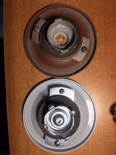

I discovered a few days ago that the fuel cap I got from a junkyard back in the 1980s was not vented. I wonder if this was the problem in fuel delivery at wot-- causing vacuum in tank and pulling fuel back from pump, causing engine to go lean...

Could be part of the problem for sure but there was usually a vent system on the tank either to the engine or carbon canister assuming that line is also open still

The unvented gas cap was replaced by a new vented one. The people who built the engine will not look at it until July.

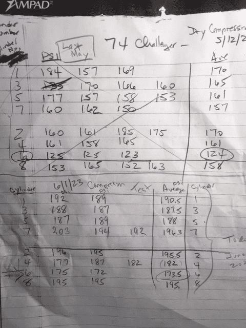

Compression (dry) test below (May 2022 at top), June 1, 2023 at bottom. Passenger side exhaust was burning oil after 30 mile drive on highway at ~ 60 mph. Plugs show oil in no. 6 which lad the lowest compression, but not that much lower than the rest of the cylinders. Again, car has only about 200 miles since they rebuilt engine, mostly short trips of 3-6 miles.
I will try and get a camera to see inside the cylinder--any suggestions as to a good model to purchase?
