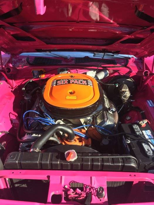

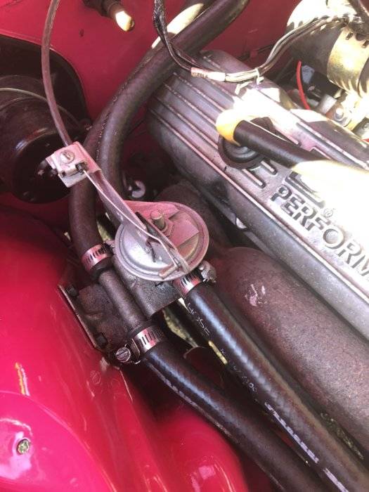

Ill get a pic as soon as i can. It has the a/c controls, the diverter valve, hose barbs on the firewall for a/c lines. No other a/c components under hood for a/c.

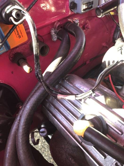

Here is what i could quickly grab for pics. I dont see the “check valve” that was mentioned earlier. I only see a vacuum line coming off the manifold to the power brake booster. There is another fitting at the booster but its capped off.
