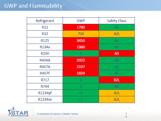

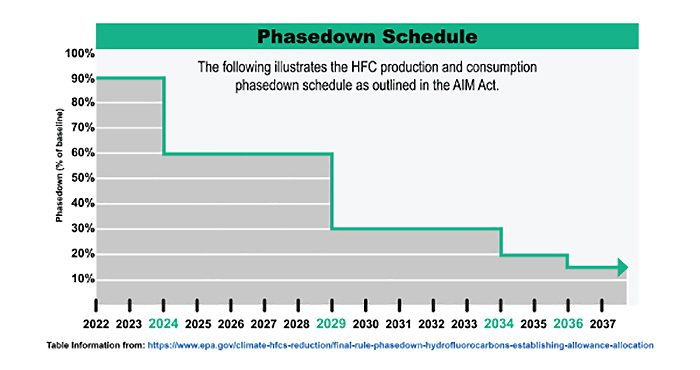

There is a change coming to refrigerant. That might be the biggest factor in cost to AC replacement or repair. Phasing out of refrigerants.
Several alternatives are being considered to replace R-134A, each with its own set of advantages and challenges. Here, we’ll examine the most prominent contenders:
R-1234yf is a hydrofluoroolefin (HFO) that has gained significant attention as a successor to R-134A, especially in the automotive sector. It has a GWP of just 4, which is a dramatic reduction compared to R-134A. Research cost, availability and later recharge.
Just a heads up.
Benefits of R-1234yf:
  • Drastically lower GWP, making it environmentally friendly.
  • Similar thermodynamic properties, facilitating easier transitions in existing systems.
Despite its benefits, R-1234yf raises concerns regarding flammability. However, industry standards are being developed to manage this risk effectively.

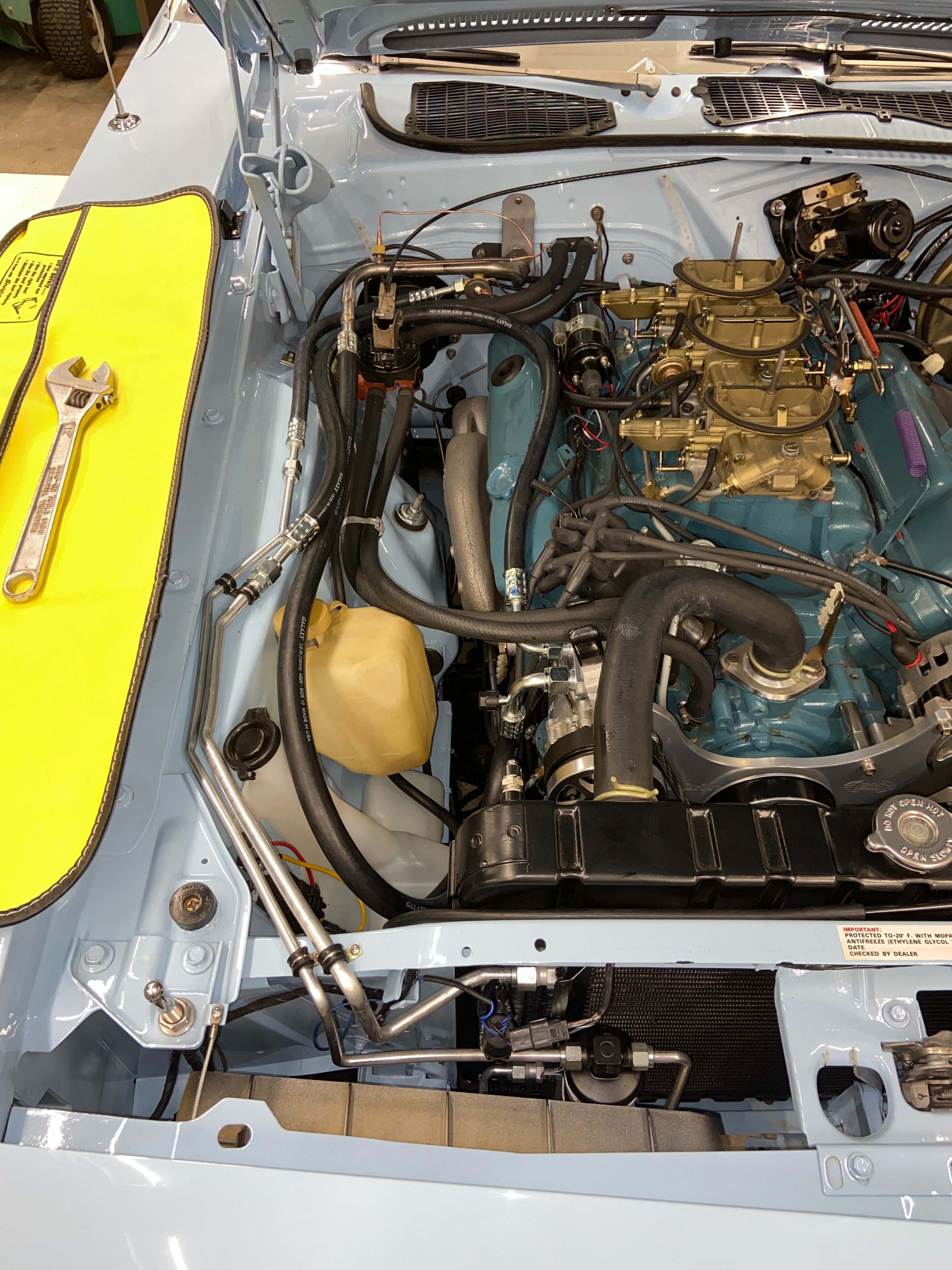

I had to go down this exact route with my Barracuda. I had my original heater box/evaporator rebuilt many years ago before Vintage air etc. were around so I did not want to spend that money again. My car was a 318 and now a 440 6bbrl so I could not use the RV2 style compressor. I upgraded to a serpentine system from Eddie Motor Sports which came with a Nippondenso compressor. I could not use the factory A/C lines as a set because of the different connections, I only used parts of the A/C lines.
I ordered an condenser and dryer kit from Vintage air and the factory air Surefit reduced barrier modified hose kit. I had to return the hose kit because the kit does not have the correct size fittings to connect to the factory A/C connections. The condenser/dyer and the lines that come with this kit were used. I bought an new expansion valve with bypass like the factory one.
I went to a local shop that installs and repairs A/C systems for commercial trucks and trailers. They used part of my original A/C hose (the one with the larger nut) and all the rest new fittings and hoses to connect to the factory A/C box, compressor and condenser.
I had the system charged with R134A and the A/C works really well.
I did wrap the expansion valve tubing after this picture was taken.
