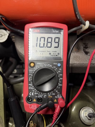

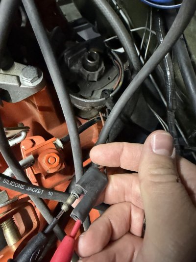

So next step was to check distributor pickup. I made ohm measures - have strange values like 10 ohm (should be 250-500), also check if when cranking will it produce some AC V (like 0.2-0.3v) but no.

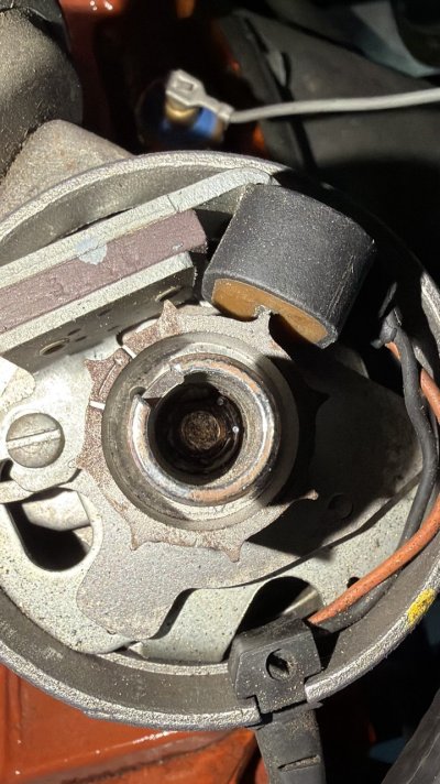

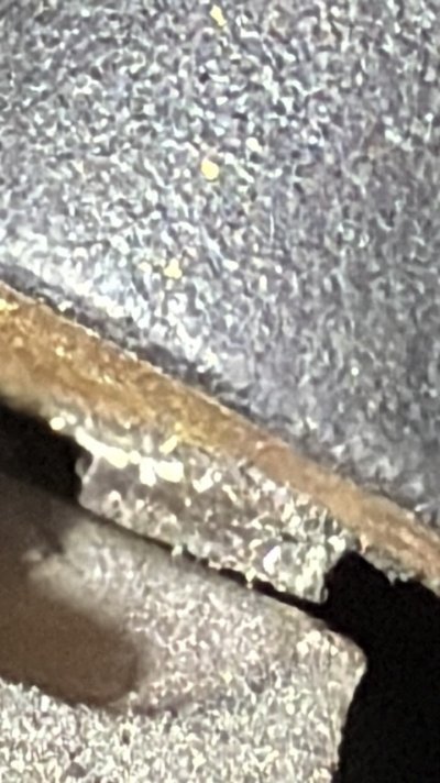

Air gap is a little bit tight - but it will not touch reluctor.
So what should be my next step? To replace pickup? Should I also buy reluctor? I have read that it should be part LX-102 and LX-104.

Nothing has really changed ecept corrosion. Cap,rotor and reloctor, check it.

Ohm reading at Distributor Pickup Coil has almost open circuit so I guess that is the problem.
