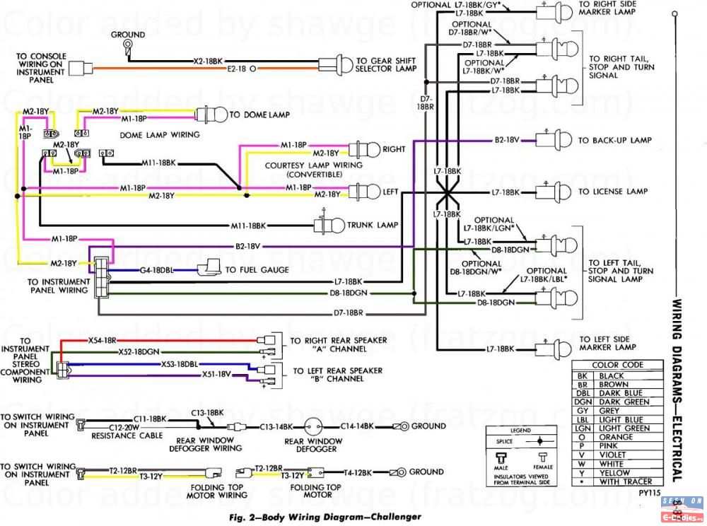

Taillights don't go through the Turn signal switch just the turn / brake .
Chech that the housing is grounded & start tracing power , there is a plug behind the front kick panel so you should have power from the headlight switch to that plug , if not probably a problem in the headlight switch .

You can apply temporary power from the fuse box battery or acc terminal to the tail light power feed. L 7-18BK.

Dimmer switch only alters the headlight feed & Has nothing to do with the taillights

Did you get to check the dimmer switch? It's just a matter of time it's used. It melts the connector and wires. Then it shorts to the switch or floor boards. There is not enough power to fully illuminate everything. It might be getting power but it can't be seen. It's only getting a reduced voltage. The bulkhead connector probably is the culprit too. I would guess you pick up on this is a fire hazard.
