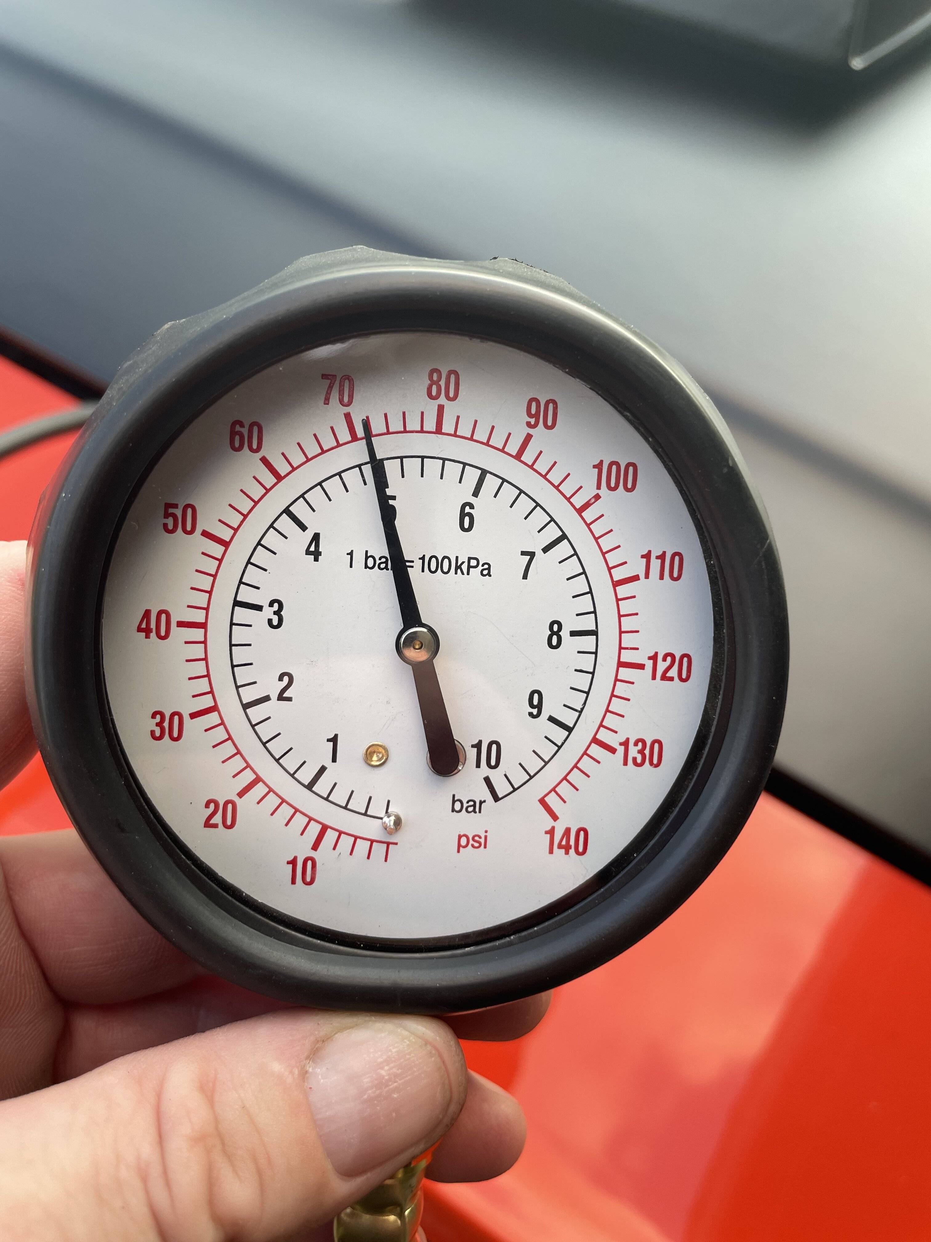

Can anyone advise what the proper RPM should Be for testing the oil pressure on my TA? I bought a manual gauge and I want to be sure that it is just my dash gauge that quit.

A lot of variables , with a stock pump cold idle should be 40 psi , hot 30 or more as long as you have 25 hot at idle it's ok . Oil pressure will rise with RPM of course .
Type of oil used , type of oil pump high volume or pressure , brg clearances when the engine was built or the amount of miles on the engine will make a huge difference . my engine would idle cold at 110 & idle hot around 70 with the pressure rising with RPM for example

I got it off. 🤣. This is at idle.

No it is not bad 70 is is awesome , obviously a high pressure pump & good clearances , anything above 25 is good
