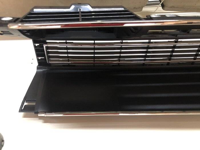

Here is one of my new BEA grills for my AARs. This is the latest one I purchased in 2014. It was on the top. I figure it was bought more in your timeline. My others were bought when they first came out.
fastmark
Apr 2, 2014
194
82
Having trouble with loading the big files. Bare with me.

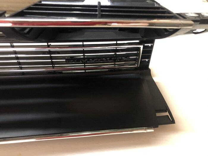

More shots

Now I’ll address the fit of the long chrome trim. As I stated from my memory, the factory trim for the top and bottom are different. The top is square, as you called it, with the top and bottom of the trim being the same length. The FACTORY oem trim for the bottom is not. The top of the FACTORY trim is about .050 longer on the top edge. This allows the trim to fit the angle of the edge of the grill better and allow the chrome to have the same angle as the headlight bucket. The picture in this post is of the new BEA argent grill with the FACTORY TRIM installed. You can clearly see the angles. I apologize that I did not take a picture of the BEA AAR grill with the BEA trim on it. I’ll go back and get it later. It looks just like the previous posted picture. It does not have the same .050 difference in top and bottom. It makes the trim point upward very slightly. I did not want to remove the BEA trim from the AAR grill and swap it to the argent grill. It would look the same. I was mistaken in my comment about my purchase of my last two argent Cuda grills. I did not receive the stainless trim with those. It was a discount close out on the grills at a very good price.

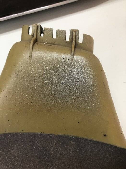

The overspray you mentioned is normal from the factory. Here is one of my headlight doors that was replace at some time other than assembly line. This Cuda had a complete new front end put on it at one time.

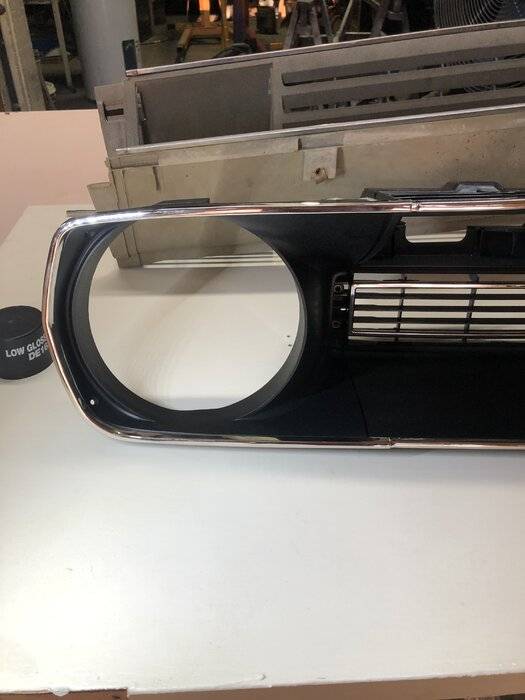

Another difference in the BEA grill from oem is the width of the plastic tabs where the trim attaches. The BEA tabs are about .125 thick and solid where the oem are about .135. The factory trim that has been previously installed on a factory grill does not want to stay secure on the BEA grill. I probably could squeeze the trim down and make it secure. The tabs on the headlight buckets are that same for both BEA and oem. I noticed on some of my oem grills that the tabs were not solid but ad a void at the base. Not all had this. Maybe they changed this because I’d breakage.

It’s been awhile since I painted it but here’s from my memory. It was a black base coat and I believe I put a little flattening agent in there. When I pulled the grill out, I noticed it had tiny metallic overspray on the back side where the elements had not gotten to it. It is very tiny and is hard to see on the front side. It’s got some dust on it in the picture but it came out dead on.
