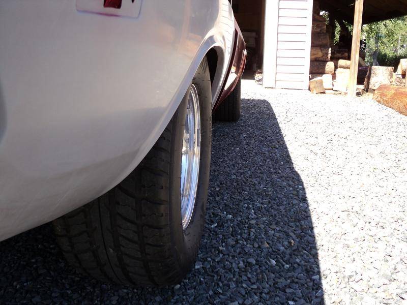

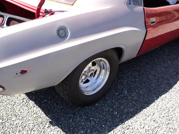

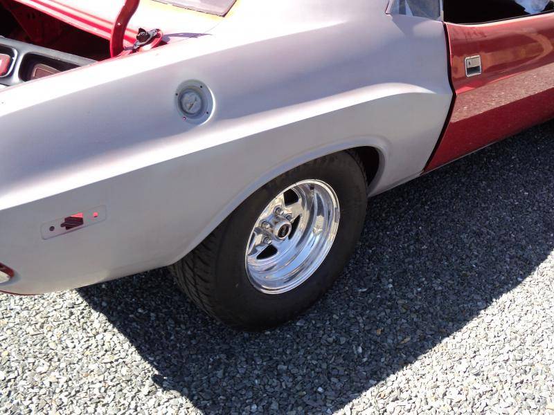

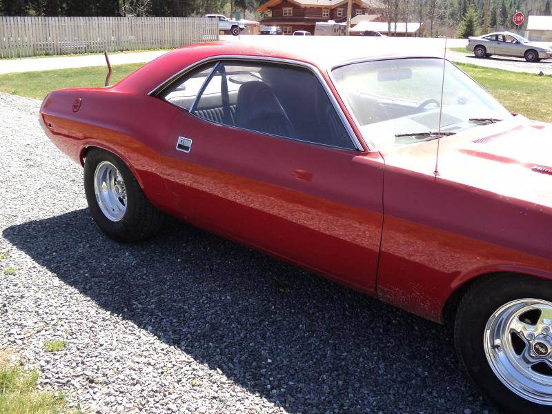

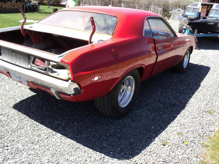

I'm an old guy, so I went "old school" on the tire/rims, to FILL the Wheelwells up.
I Never liked the BIG WHEEL thing personally anyways,
No matter,
my 700 hp Pump Gas 422 Inch small block NEEDS Traction with the larger Balonies for straight line stuff, so I went with 29 X 12.5 X 15 Hoosiers(#19150).
It all fits great, gives a nice Pro-Street stance with everything tucked underneath, and plenty of clearance with the B-Body Rear and relocated Springs(could have gone bigger yet) on the 15X9 Welds.
The best part, the old school Tires & Wheels are CHEAP, at a fraction of the cost for the newer 17", 18" etc stuff.
