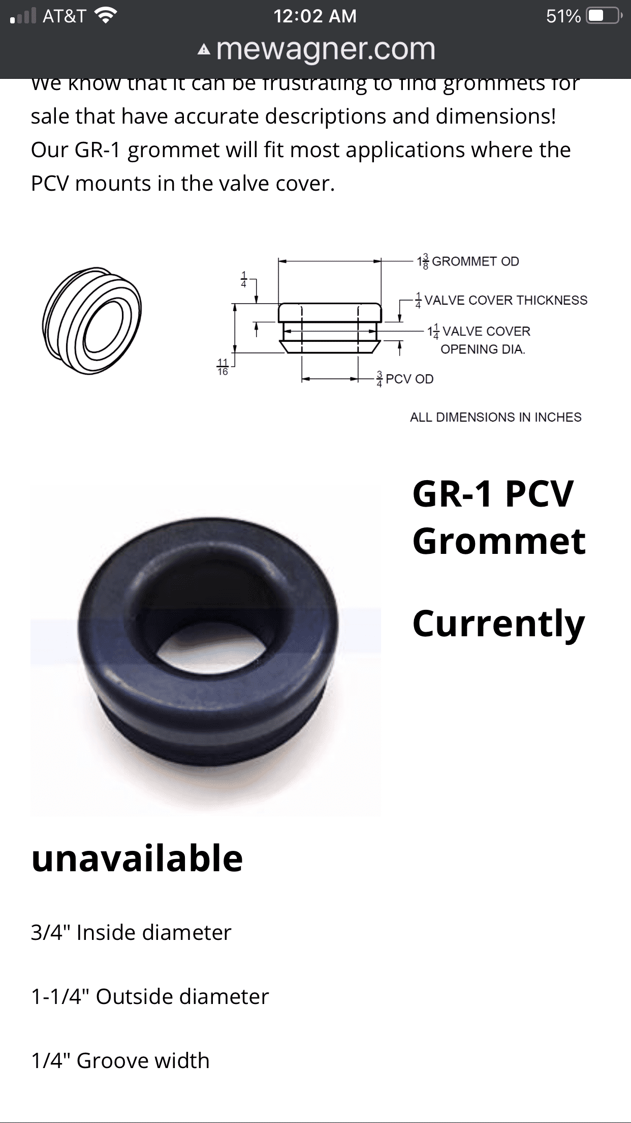

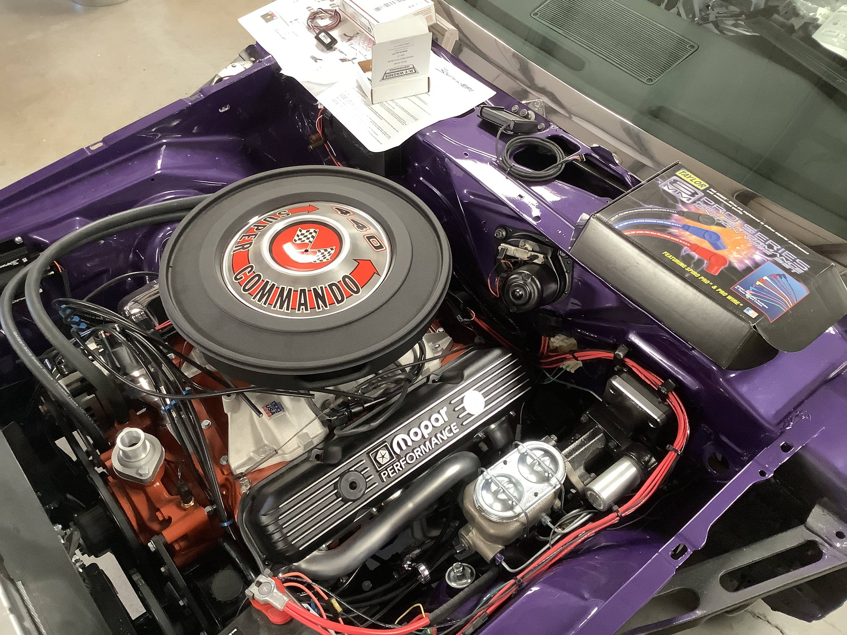

I have the mopar performance big block cast valve covers with a twist on hole and knock out spot on each. I am installing a m/e Wagner Pcv valve in one of the twist on holes. It needs 3/4” id. Does anyone know which grommet with that id also has big enough diameter to seal twist on tang cutouts also. I read a review of Ford grommet M6892F working well on the mopar covers. but Not exactly sure of thickness of groove needed either, covers are an hour away so I can’t measure them right now but want to get parts ordered. Pcv will go on rear passenger side, this just pic of the actual cover for reference. Thank you

Thanks for the info. I googled the part number and ended up on the m/e Wagner website. It says unavailable. I talked to them yesterday and no mention of this grommet. He did suggest the Ford part. I also found a post on FABO where someone used the Ford part on these covers with Wagner. I found one yesterday evening and is on the way. I’ll update how it fits.
