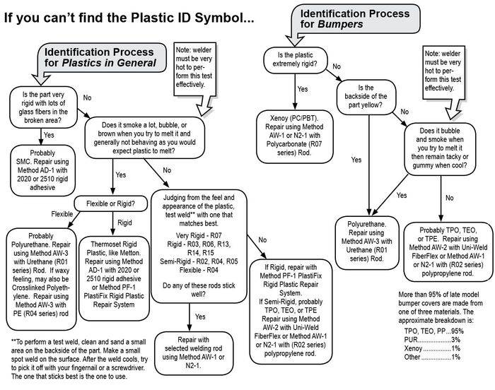

Board? you gotta be kidding me, I used to have subscription to the "Plastics on My Mind" annual report/magazine, Heh
Thanks, its more meaningful when a tedious subject is organized in this kind of format.
