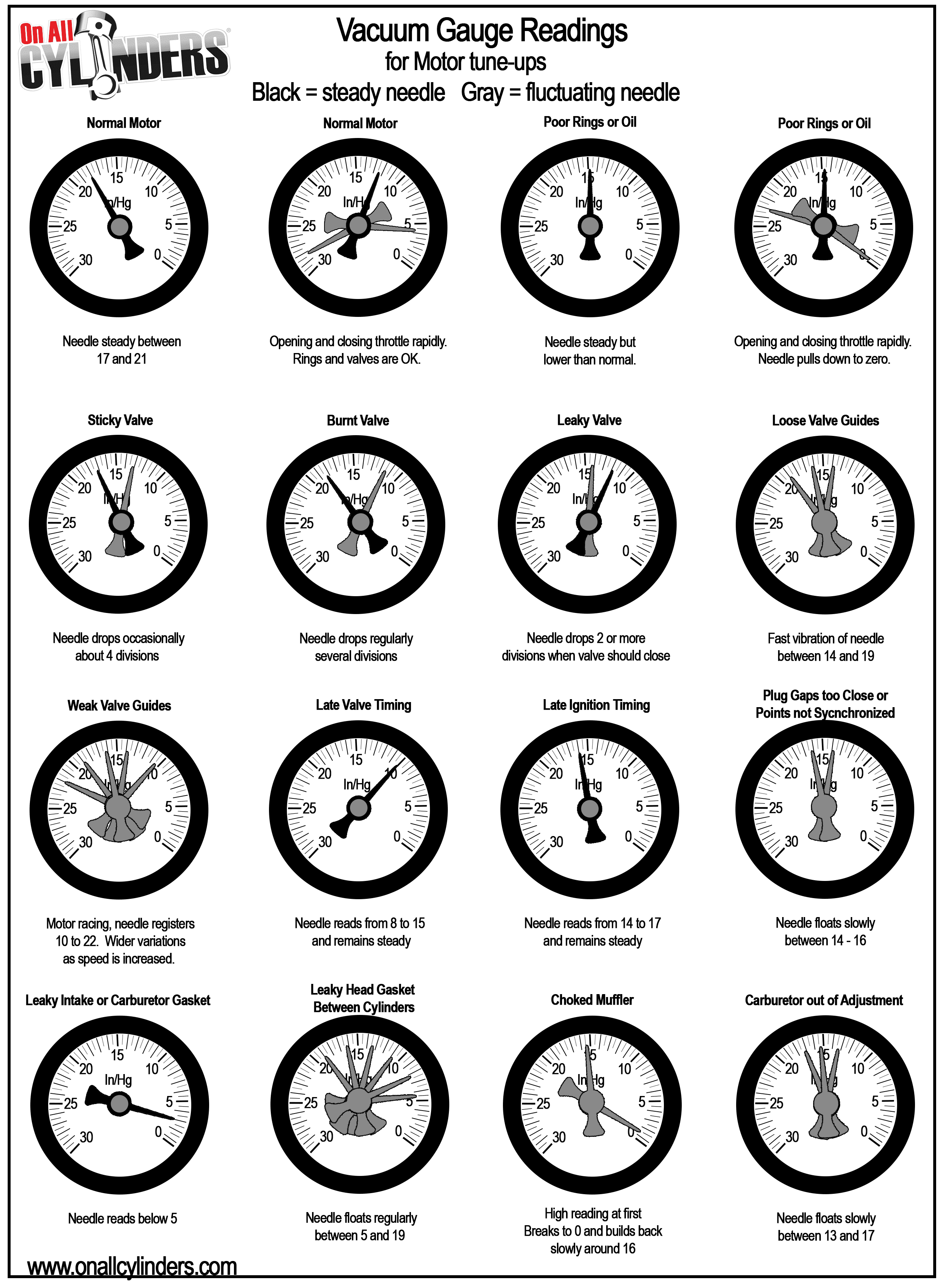

Hook up a vacuum gauge when it's cold and see how it reads. Then drive it to warm it up and check the vacuum gauge again. Use the attached guide to diagnose the problem. You can efficiently tune your car with nothing more than a vacuum gauge and rpm gauge!
Thanks for your reply and the readings info. Will try. My first thoughts were that as then engine got
warmer that it was losing vacuum and the carb was closing.
