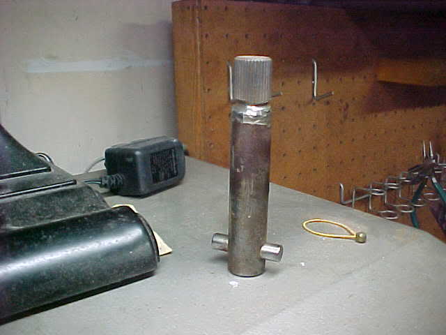

Is the replacement PS box different than a stock unit? The shaft for PS is shorter than one for manual. There used to be an adapter to go from PS to manual and I think they sell one. They used to be cheap but not anymore but that won't help your case any. Anyways, this is what I used to do whenever I swapped to manual....I would just grind the weld at the bottom of the shaft and replace it with one from a junk yard. That weld allows the piece that goes into the coupler to be pulled out of the shaft once it's ground away. This part is for a PS setup iirc.
