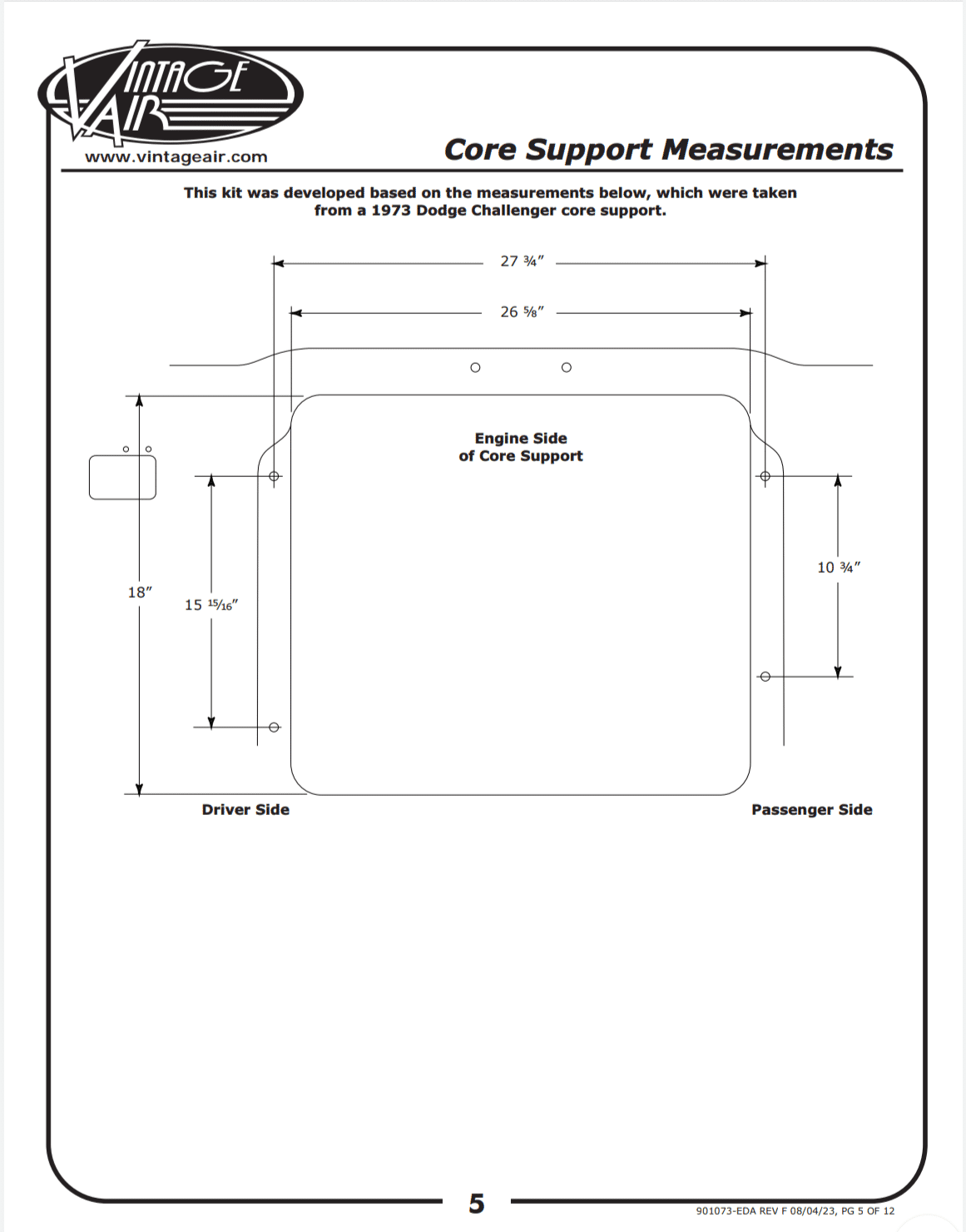

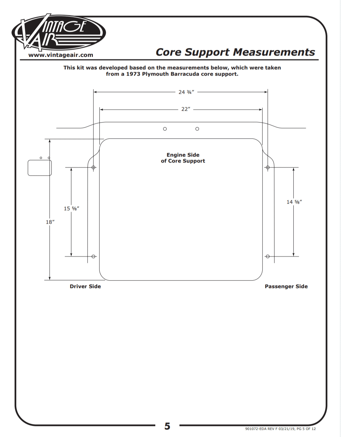

I am working on a 70 challenger that is original big block auto. The owner wants me to change the rad support because he is putting in a small block 4spd. He brought me the passenger (rt) side rad support so i can change it to fit a 26 radiator. Before i go installing it i want to make sure of some things. When i put it into place the radiator opening measures 25 1/2. Can someone please measure the distance between the bolts. I want to make sure i get it right. Also by doing that & not doing any thing to the driver side isnt that going to shove the radiator to the rt side ? My cousin has a 70 AAR cuda & i measured the distance between the two top bolts & i got 29 inches. That dosent seam right. I forgot to measure the opening. Does the AAR & T/As have a bigger radiator in them ?

Vintage Air has some good info

thats funny my dad use to say that i dont have the radiator I see that its for a 73 challenger. Are the measurements the same for the 70
