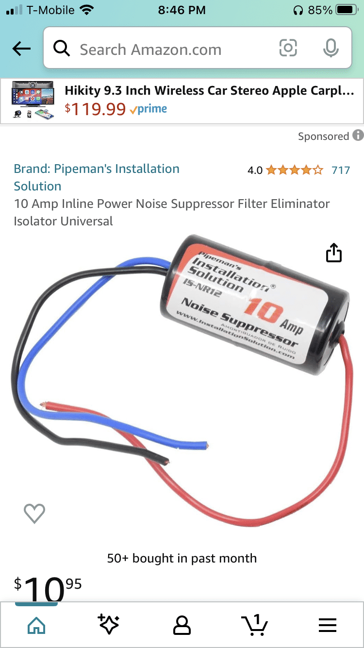

Would an in-line noise filter help?

So… my Bluetooth started breaking up like the radio. Not wanting to drop close to 100 on an alternator right now. Took the chance and ordered the above filter on Amazon. Spliced it into the acc power lead and no improvement. Decided to try the always hot side (for the presets) and the problem is gone. I am sure that one day i will need an alternator, but this has been a year long battle, so I will watch it for signs of failure. Taking the win

The acc power input circuitry within the radio has some filtering built into it to attenuate the typical noise on a power line. The "noise" is sneaking into the radio through the keep alive power input as you have just discovered. So it's nice that the radio is quiet, but like you said you'll soon be needing a new alternator when the remaining diodes begin to fail as well. Keep a set of jumper cables in your trunk. :)
