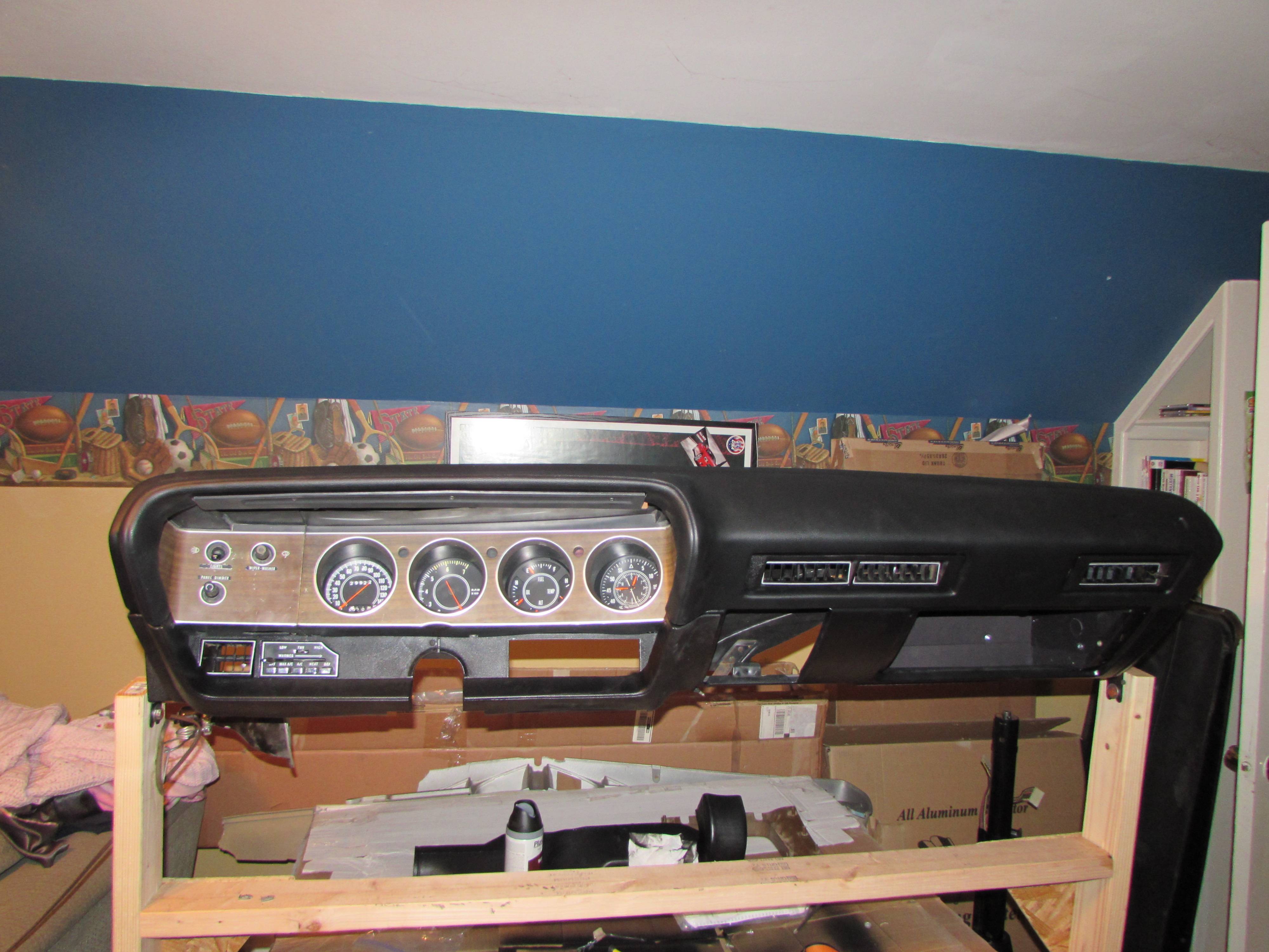

I didn't realize that there was a rally heater control panel when I did my conversion. I patched the standard one using piece of abs plastic and chemically welded them together with an acetone abs plastic paste. I recetnly bought a rally heater control and will be fixing it. Point is, you can make it work without a lot of work.
