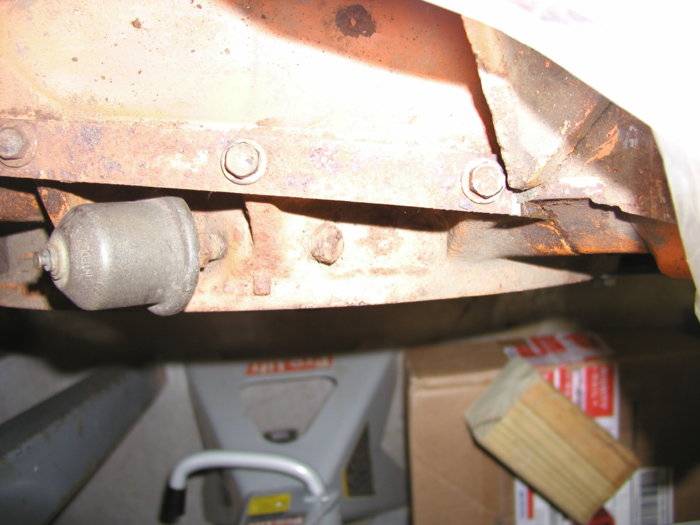

There are 2 different sizes back there. My Imperial uses both because it has a light and a gauge and the switches/senders don’t interchange.

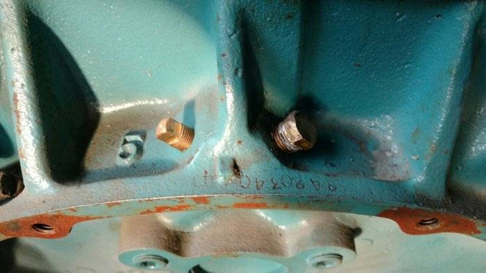

My Imp is a ‘67 440 and this is the 440 out of my ‘68 R/T.

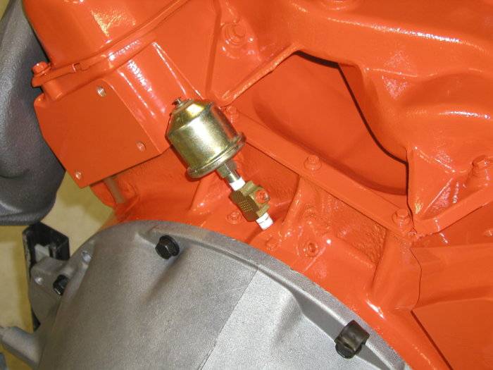

Here's one of my '69's. Its a 440, Has HEX pipe plug in the larger port. Obviously 1/4" NPT.
Here is a '70 383. Has an ALLEN head pipe plug and is deceptively smaller looking, although closer look confirms it is 1/4" NPT also.
Here's a '69 383, and again it has the HEX pipe plug. Much more noticeable that it is larger.
Lastly, here is a '75 400. Once again, it has the ALLEN head pipe plug that LOOKS smaller at first glance.
Looking back on things, the two engines with the ALLEN head plugs are the most recent engines I've built. I used the same machinist on both of those blocks and I'll bet that's how the allen head plugs in those came about. The other two with the HEX head plugs are most likely factory style plugs, as those have not been messed with in over 35 years. SO........
I would like to sincerely say "I'm SORRY" for the mis-information I first posted. I did not intend to mislead anyone and obviously thought I remembered correctly, but I did NOT. Old age is creeping up on me and it is starting to scare me now.
Thank you DetMatt and IQ52 for setting me straight.
