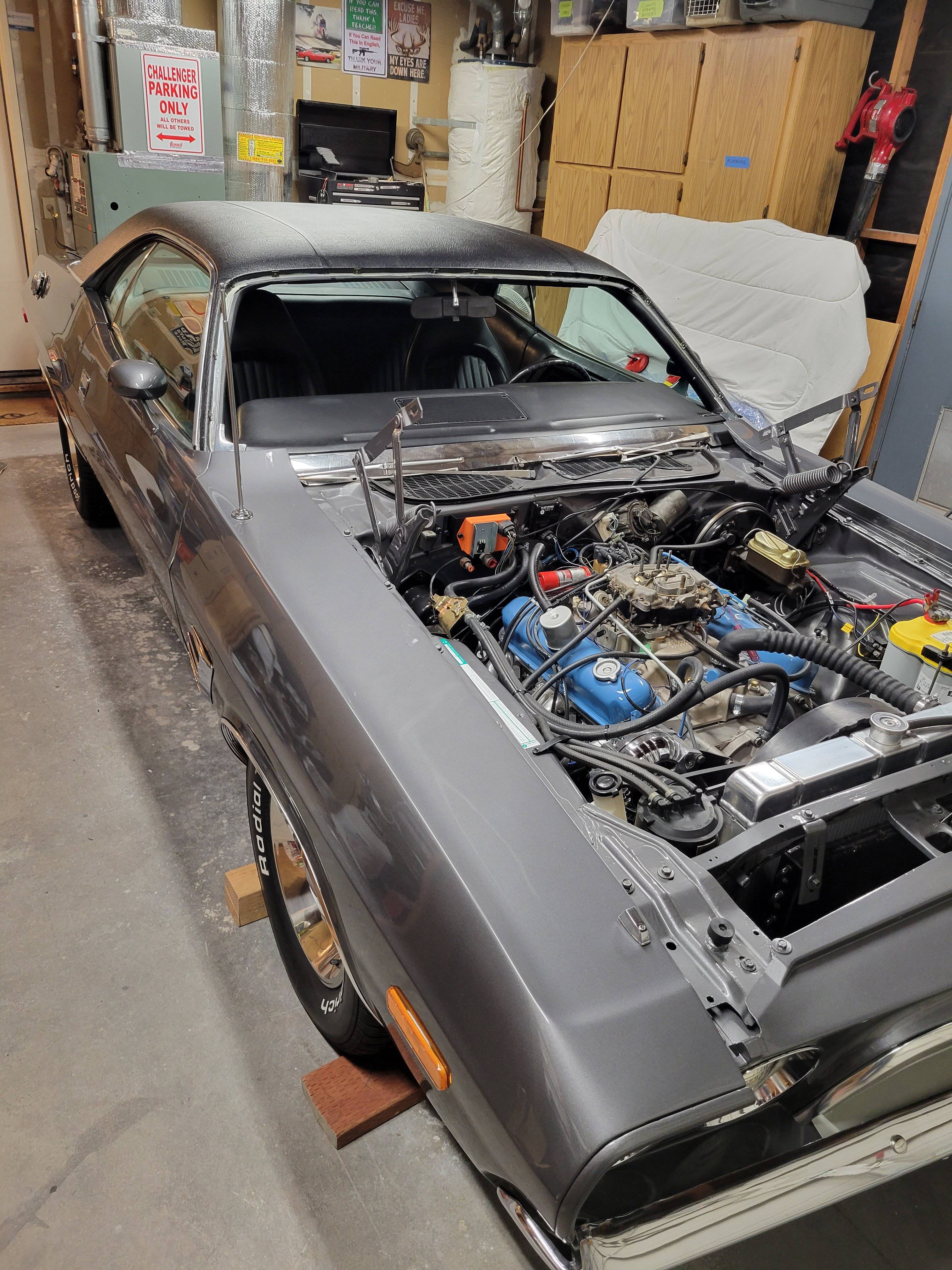

Gas is to the carb, all fluids filled. Seats in. Battery hooked up, all electric components work. Had the key in the ignition, the buzzer scared the crap outta me! First start up tomorrow the 23rd after a 100% full ground up restoration, mostly by me. Fingers crossed, I'll video it and post it. Wish the new girl luck!

I wrote an article on first fire up
I would remove the power steering belt just so you don't have to shut down for a steering issue , have a hose close by for extra cooling if needed , set the timing up immediately by ear , advance or retard to best RPM , this will help cooling , start adjusting the carb asap so it is not running lean again helping cooling .
This is one of life most awesome experiences firing an engine for the first time & running in the cam for 20 minutes if it is flat tappet not roller .

How I got the distributor in 180 degrees off, I have no idea. After that, started right up. Ran it about 10 minutes and shut it down to recheck all the fluids. Had to add a little oil and trans fluid. Tried to restart it, no luck. Checked for spark at the plug, nothing. Thinking the ignition controller. Any ideas?

Looks like you have a orange box & MSD coil , the MSD coils do not work for long mounted horizontally .
could be a ground or the ECU or bad coil or pick up in the dist , the coil wire should spark every time you unplug the dist .

Distributor not grounded.oil got on mounting area when removed?
Just thinking the last thing you touched. Ing 1 and 2 have power?

After it ran, the ONLY thing I did was add some trans fluid and oil to the motor. I didn't mess with anything electrical. Flipping the distributor 180 had to be done before it started, because it obviously didn't start.

Can the coil fail after about 10 minutes of running? I could turn it vertical if I mounted it somewhere else, but I'm using the original mounting bracket/location. I'd rather get a coil that works horizontal. I can hunt Classic Industries, Year One, or Summit.
