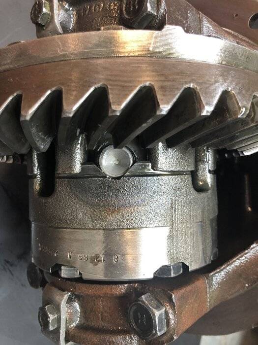

I’ve added more friction modifiers, done figure 8’s but noise isn’t going away. Can turn pinion and axle flange by hand easily, It’s smooth and no noise. BUT CANNOT turn one wheel while holding the other. Pulled third member see nothing obvious only a couple of heat marks. Not sure what they mean. See photo. This third member sat for about 3-4 years after installation. Haven’t done this before, but I’ll try an take it apart and reassemble. Something is too tight?

The heat marks are just showing areas that were induction hardened after machining to strengthen that area.

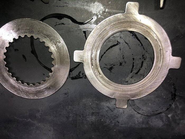

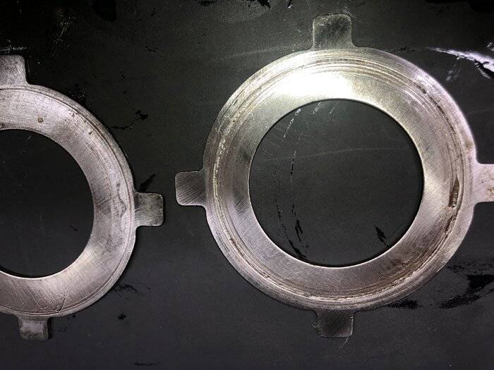

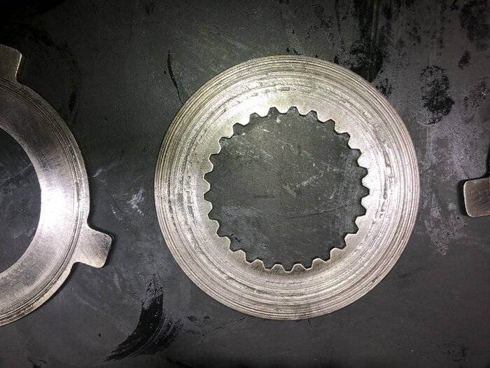

Just took it apart clutch discs don’t look good.
oldkimmer
244
66
That doesn’t look to have been rebuilt. But it needs new clutches now. How many miles did u drive it? Kim

Installed new clutch discs, clunking is gone.
But, I bought the clutch kit from mancini and the kit only had dished plates, no dished discs, they came flat. I called Mancini, they called the manufacturer and apparently that’s how they’ve been making them for years.

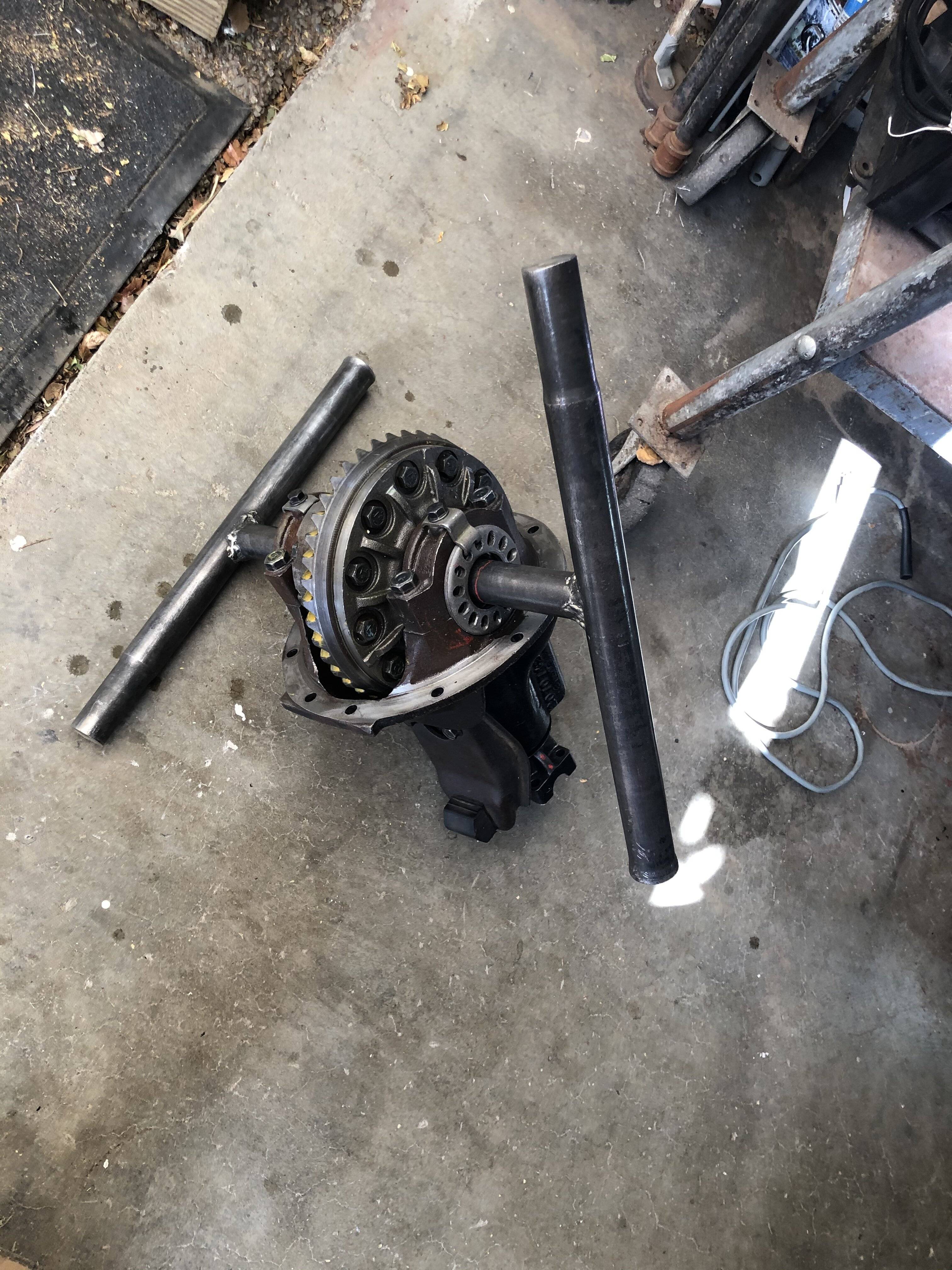

Somehow one of the splines
on one side moved, couldn’t get the axle in so luckily I saved a set of old axles and made a couple of T handled and was able to line them up. The last thing I wanted to do was take it apart again.
