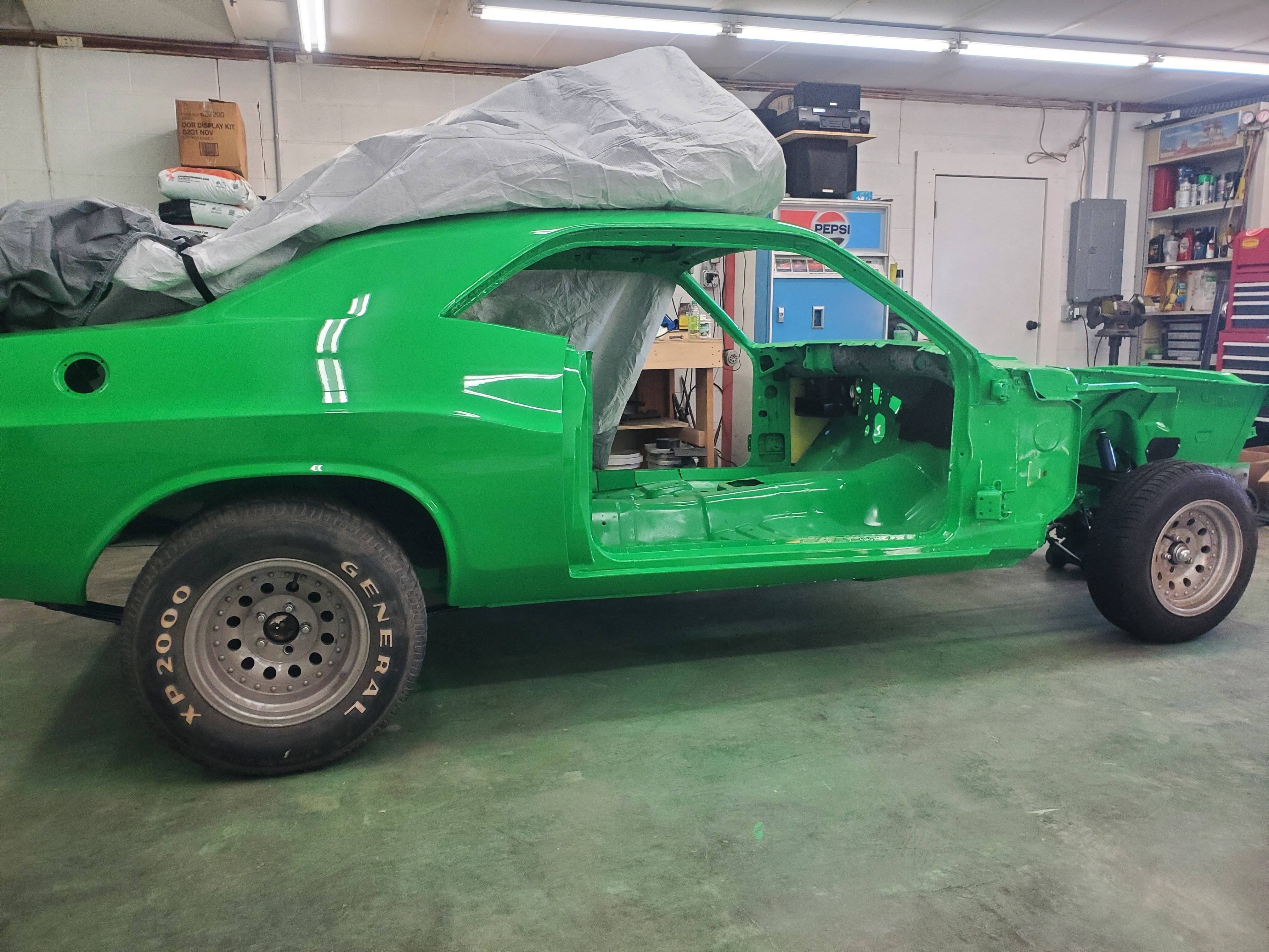

I bought big block leaf springs for my 70 Challenger and it makes my car set too high. Looking for options on how to drop it 2 to 3 inches. Right now it has 275/60/15 on the back and it measures 29 1/2 inches from the ground to the center of the wheel well opening and 12 inches from the ground to the rocker in the center of the door. Is removing a leaf or two an option? If so which ones? Any help would be appreciated. Thanks

If you are basing this on the pic posted I would wait.
There is a lot of weight of glass, fuel, seats etc to go in yet.
When all that weight goes in it will settle a lot lower.

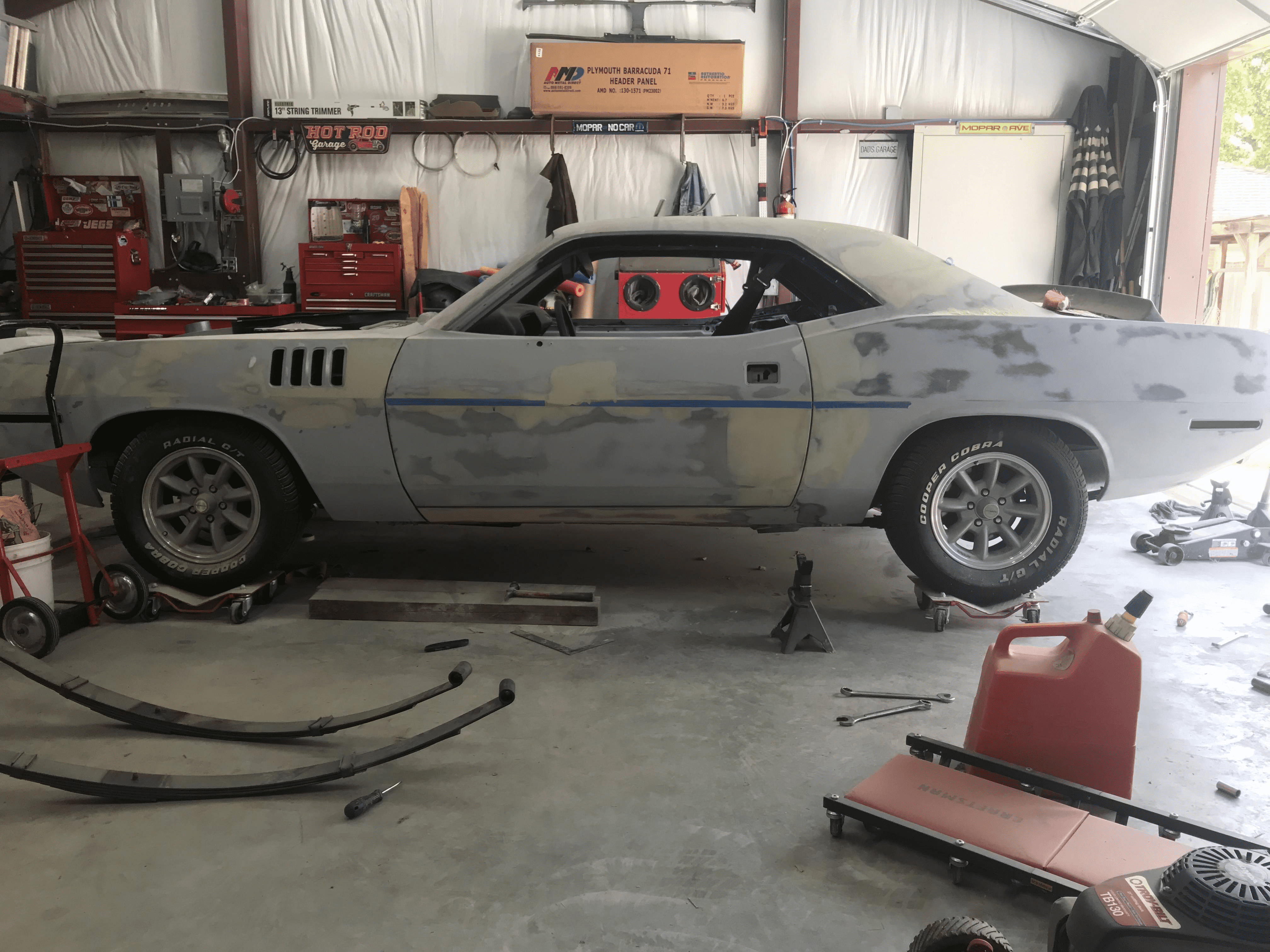

I bought hemi leaf springs from ESPO with a one inch drop. Picture for reference. I think my tires are 255/60/15.
MyR/T
Mar 22, 2018
81
25
I'll just wait for now and see how it looks once I get the car back together and the new wheels on it. Then I will decide what to do from there. Thanks everyone for the replies.
