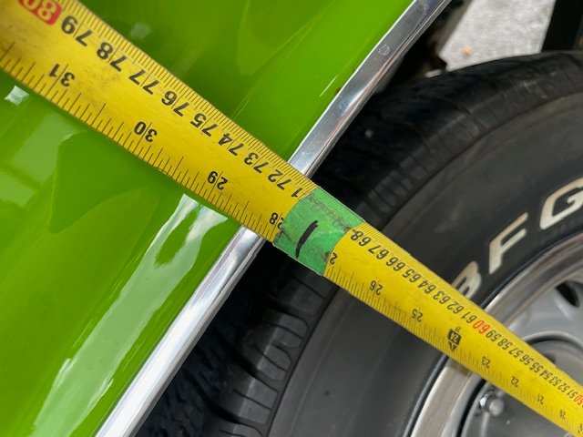

rear height

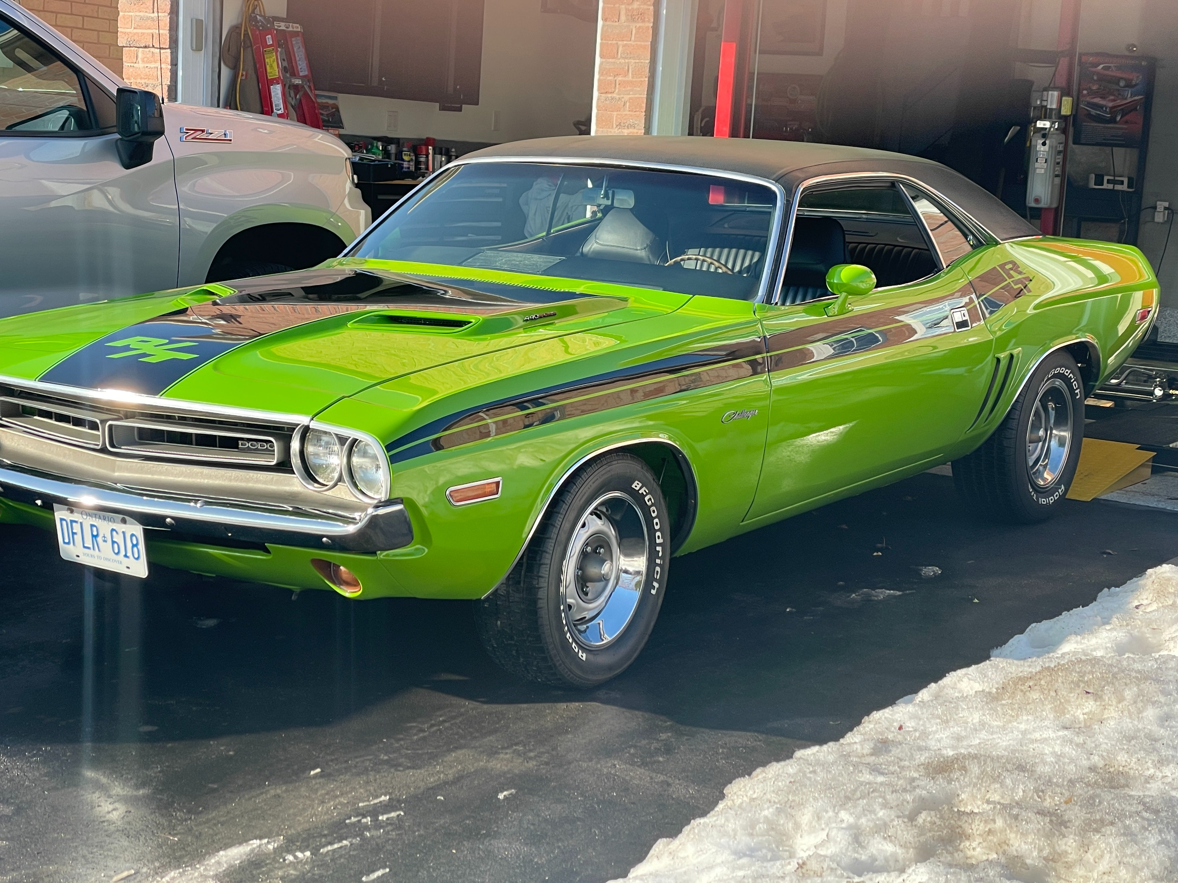

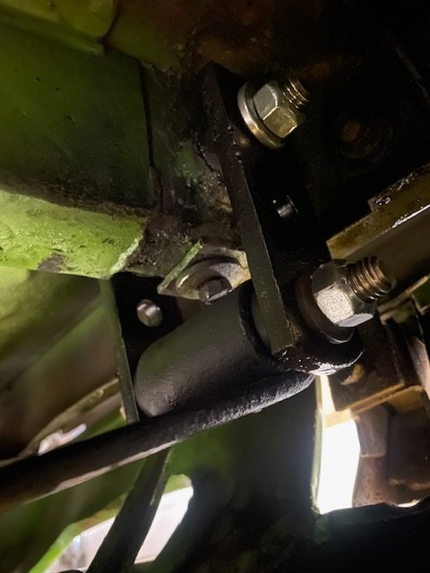

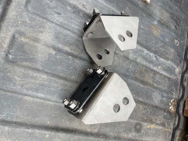

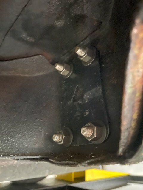

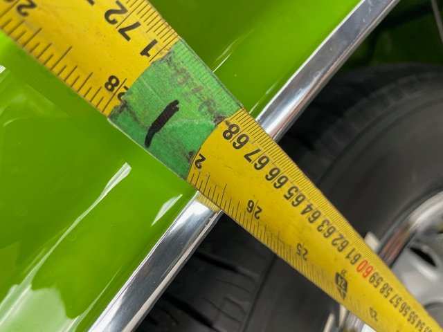

the front fender is just over 26" and the rear is 28" ....after taking out 2 leaf springs from each side leaving 5 leafs on one side and 6 leafs on the other, it srtill rides a little high--- I'm going to install these front hangers and hopefully it comes down a little more. there is exactly 1" between the centres of the holes.
I will also lower the front a 1/2 turn or so with the torsion bar. btw --the 2 black front seats are out getting re-done, the single white seat is a temp seat.
Those will probably get you close.
I bought +1" springs when I redid the rear. It was too high like yours, so I moved the leaf to the other spot on the hanger and that did the trick.
