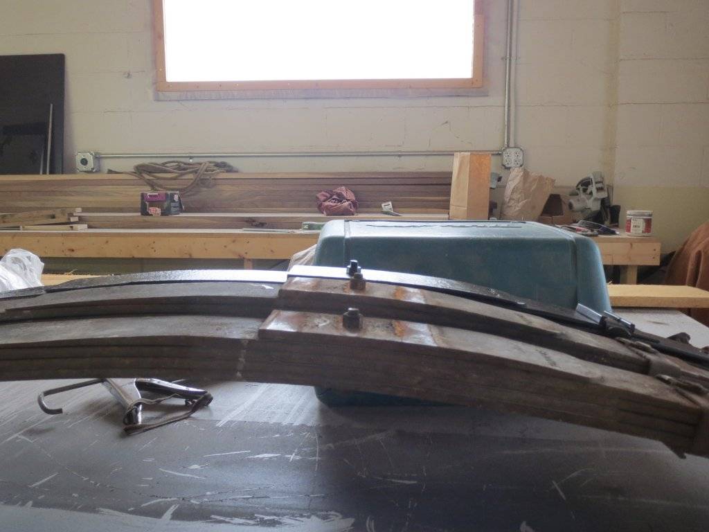

The 2 in the foreground are the 045s that came off my vert and the 1 in the back is 1 of the 044s I installed.
You are right they appear to be exactly the same. It seems from other posts the part numbers differ but the springs look the same.
Perhaps it was only the spring strength or the set height for different weight cars.
I assume a convertible with all the power lift mechanism weighs more than a hardtop in the rear.
I now know the springs I have are reasonably common.

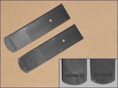

Has anybody used the leaf additions that Tony Mopar sells to add to existing leaf springs? He offers two types:
1970-71 E-Body Heavy Duty Leaf Spring Lower Leafs,
with Numbers. Used on Hemis and 440s.
#3400024 & #3400034
AND
1970-1/2 AAR & T/A Leaf Spring Lower Leafs,
with Numbers. Used on All T/As and AARs.
#3400048
These could be added or replace a spring on your current units.
Anyone have thoughts on using these?

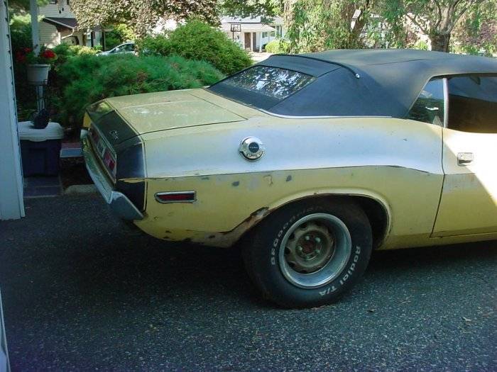

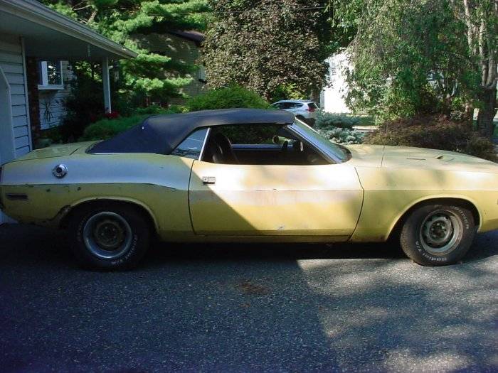

The rear fender lip now is 1 in above the tire with 255-60-15 BFG's and the coil overs. Bought them in Sears, and installed in 1981.
They are old and probably have sagged
Fronts are 235-60-15
Car had a slight rake with stock HD springs and the shocks
