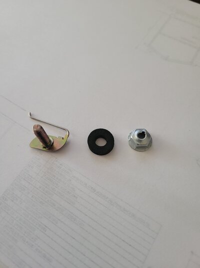

Image ending with 54 is the way I typically see it and is how mine is. When you say last 11" of trim, which trim, the roof rail trim or the vinyl 1/4 panel trim? The vinyl 1/4 panel trim has a clip like shown in ths photo that is hidden by the headliner a few inches back from the convergence of the two.Trim Clip.jpg
Is there supposed to be a washer included with these clips? Mine did not come with them. does the washer go under the nut or between the clip and the outside car surface?
Image ending with 54 is the way I typically see it and is how mine is. When you say last 11" of trim, which trim, the roof rail trim or the vinyl 1/4 panel trim? The vinyl 1/4 panel trim has a clip like shown in ths photo that is hidden by the headliner a few inches back from the convergence of the two.View attachment 97666
that what i used, no washer---forward of that there is another clip--then there is 11" of no clips or pins just "floats" without being secured on the 1/4 trim to roof rail
