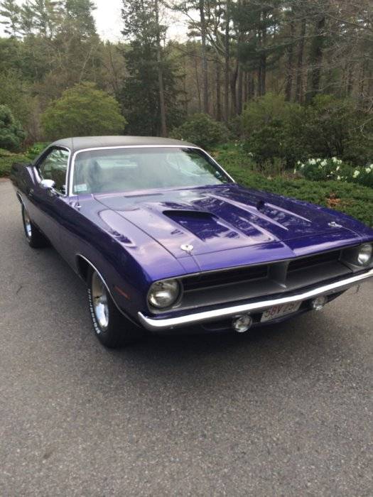

we may have a new plan. Now we are considering Hughes LA block. Here is the most recent photo of my husbands Cuda (which I am helping to rescue). Not great photo. Might have a better one somewhere.
